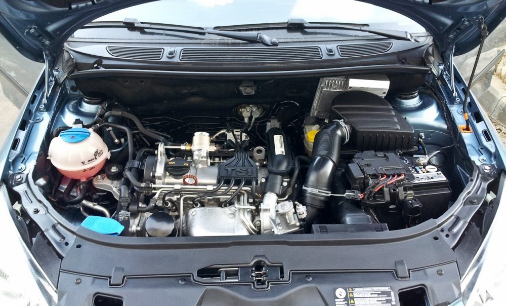

Engine sounds normal to me. I have a silver oil filter fitted by a Skoda dealer. Rev counter is very steady and tickover idle correct at 650 rpm. I get a slurping noise from the coolant expansion tank sometimes is it that you are hearing. The car has done it since new, has not lost any coolant so must be a characteristic of these engines.
OE VAG filters fitted at UK Skoda dealers are silver and are made by Mann Hummel. The one fitted in the OP's pic is a Mann branded aftermarket filter and would not have been fitted by a Skoda dealer even though they are physically the same, only difference is the supply chain, and the VW branding.
Edited by xman

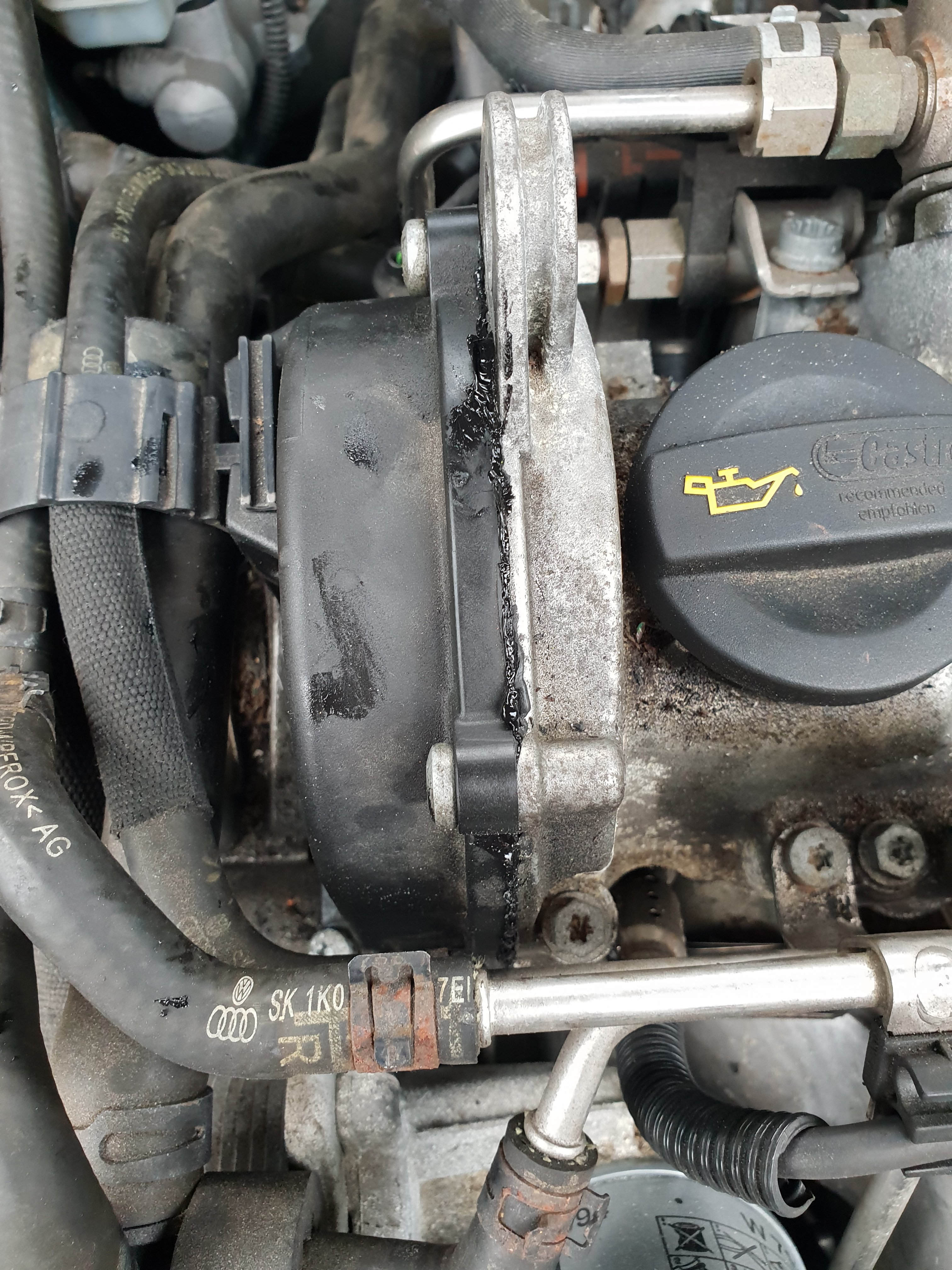

Something has been done, given my trust levels with them at the moment that could just be putting that black sealant in to seem something has been done
I think because I mentioned the timing chain they've thought to shut me up just say they've done it.. I've never experienced this sort of thing in a car and not the most mechanically savvy so I'm stumped what it can be.
I just find it coincidental that I get the call to say I can collect the car on the 30th day since purchase, whether they are thinking about after the 30 days is harder for me to return I don't know but consumer rights says whilst the car is with them the 30 day clock stops ticking on my side.
That is the liquid gasket, not brilliantly applied, but supporting the claim that the timing chain has been changed. Hopefully the complete timing kit and not just the chain as the tensioner of that era is known to be a bad design.

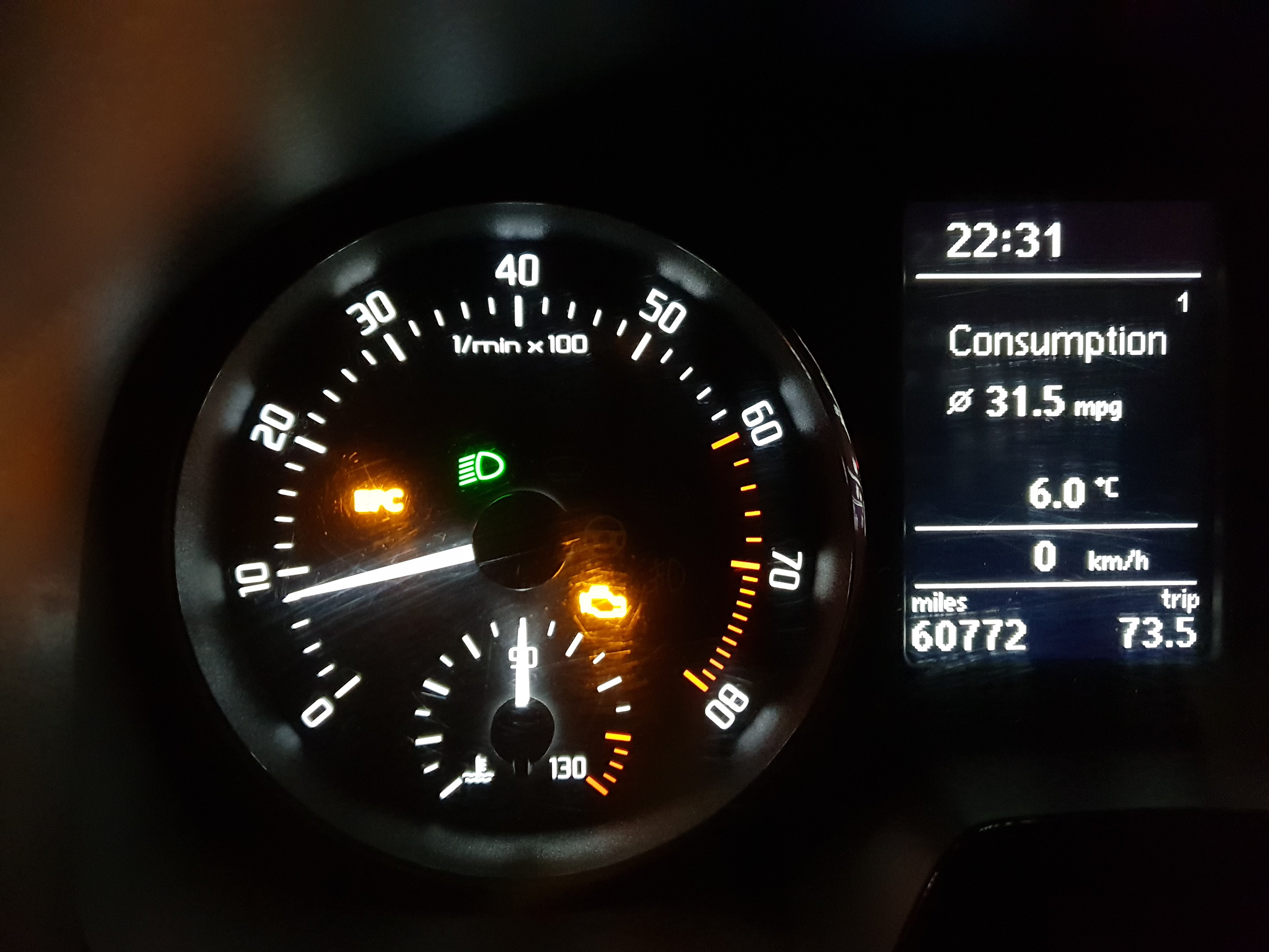

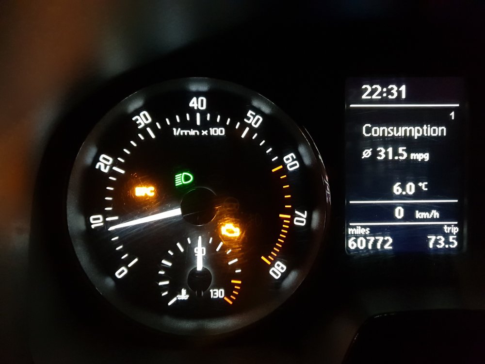

Took the car out, went into limp mode. This happened
Glad I'm not going mad
If its running relatively smoothly as opposed to running extremely rough, but has absolutely no power, struggles to get to 30mph etc then I'd wager it was the turbo actuator fault that I referred to.
If that fault, it requires a new turbo AND actuator to be certain of fixing it.
So I would still reject it as they will probably be tempted to take the cheap route of changing just the actuator which is often just a sticking plaster fix or even worse just trying to free it up with penetrating oil.
Its possible the previous owner traded it in with this fault, used WD40 to get it working for a week or two....
Edited by xman
