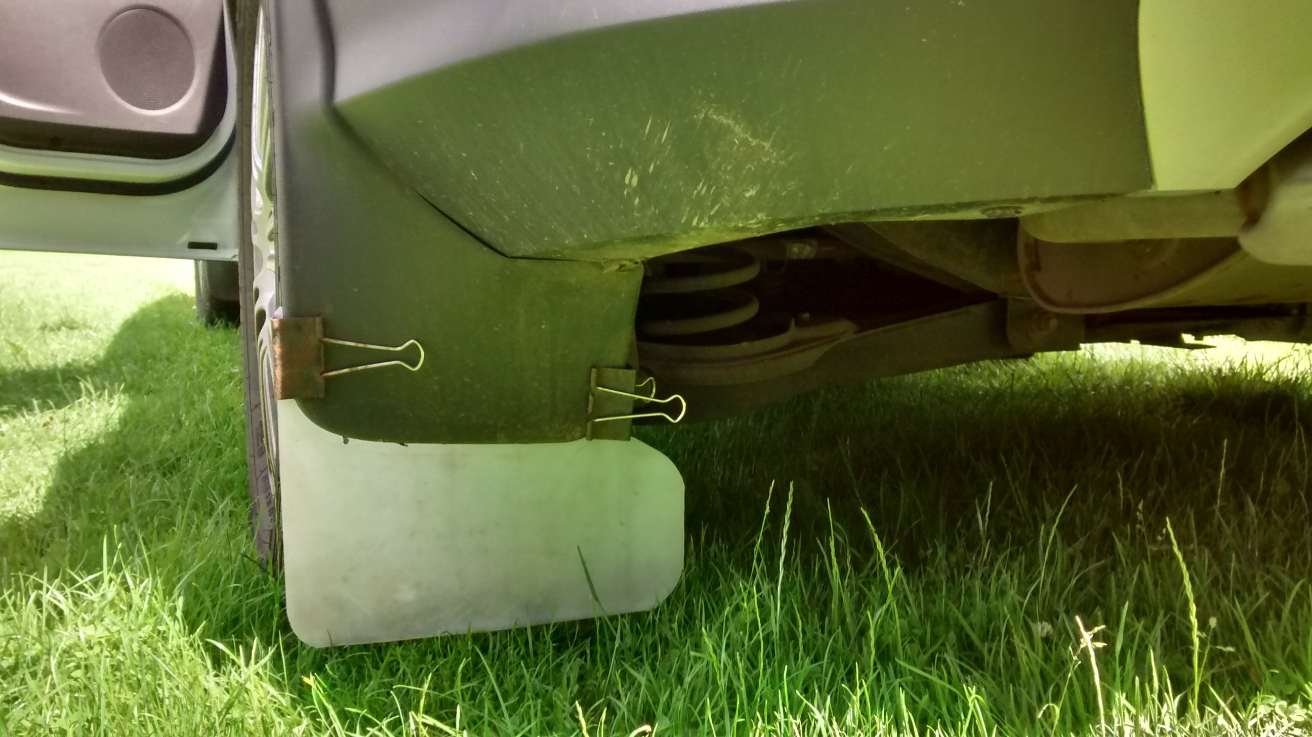

Saw a Kuga with these extras clipped on to the rear mudflaps. Made from an old white plastic container. Only used when towing a caravan
