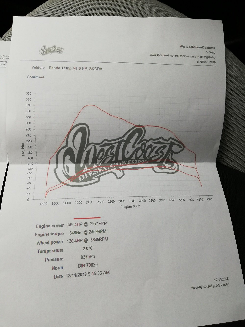

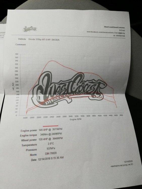

Hope that this post finds you well. I own a '07 Fabia vrs which was stock till last Friday.. I mean, it had some improvements like - intake from cupra, 312 brakes, hr 30 springs, but nothing was done for more power... The car gave 149 hp and 356 nm. The guy that was doing my remap did not believe it was stock, so he downloaded the file and took a look. Later on he confirmed it was stock. Is someone willing to have another look and share his opinion? The reason i am asking is, because i bought the car as stock one and it previously was remapped, however the return of the stock software was done when i did not own it.
 Here is the graph of the  stock run:

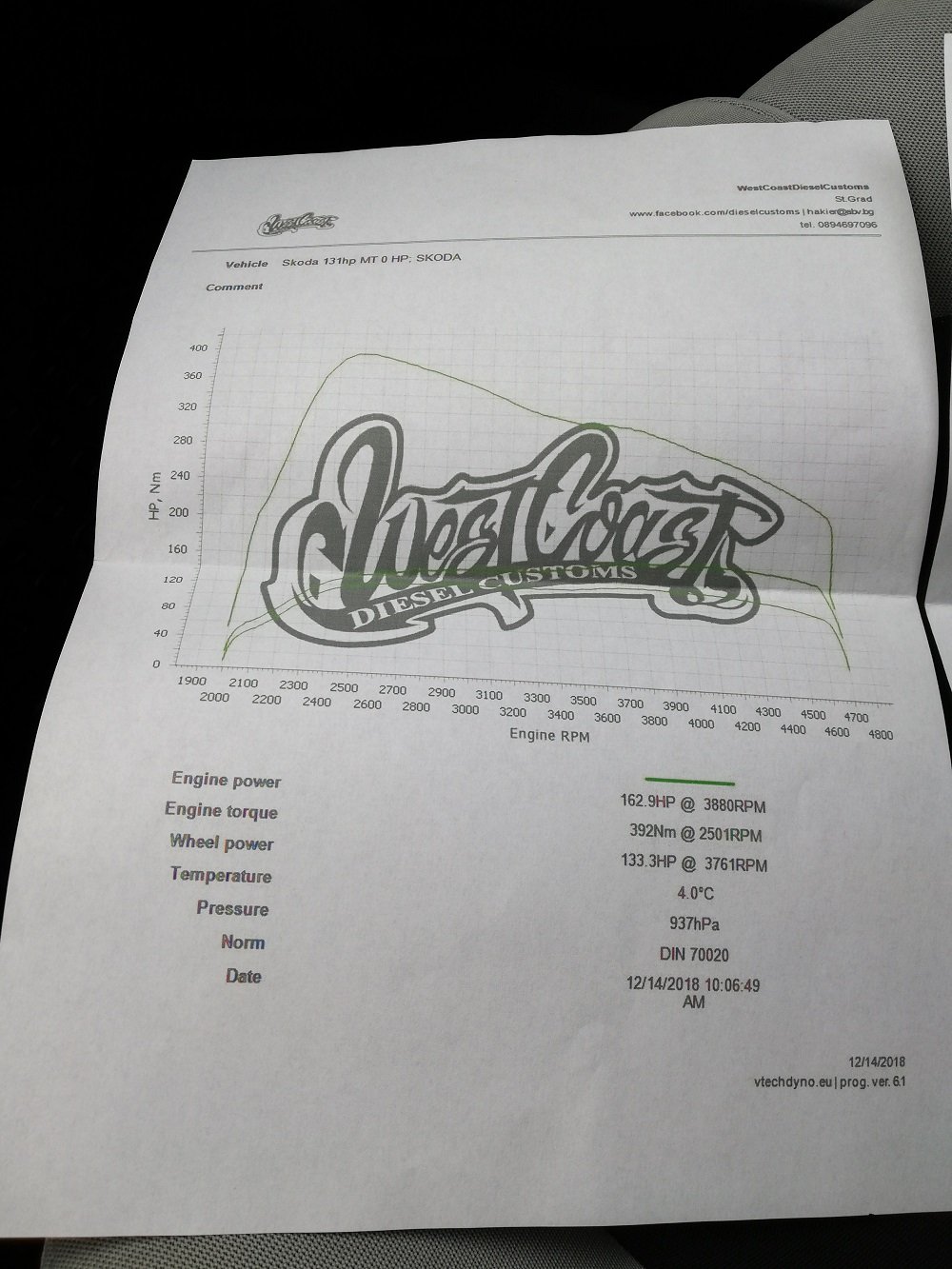

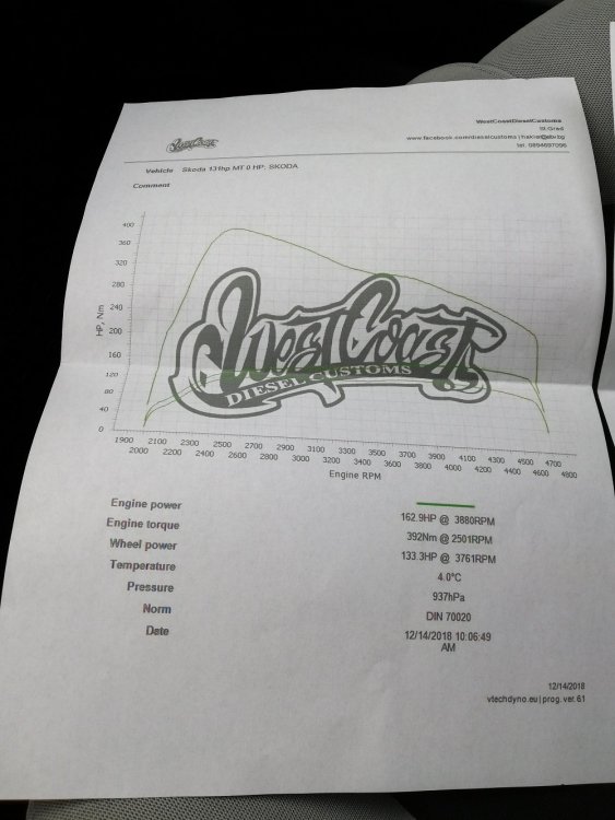

Now after some mods from his side it gave only 162.9  hp and 392 nm:
For sure there is a difference in the pull and the way it goes... honestly i would've been happier on 170 hp mark, but i decided not to push my car more on the stock clutch and turbo.
Lately i've been doing a lot of reading over here.. really a lot of info, big thanks to all of the guys that are sharing and helping to noobs like me... If possible could someone help me on the following questions i have:
1) I saw that it's normal to give from 140 to 150 hp as a stock. Any idea why it did not gave more than 163? Actually, he made another file that was only 1 hp more, but over 20 nm and we decided to live the current one - 162.9  hp and 392 nm
2)  I told him that i would like a torque limited remap, but either this did not ring a bell, or he was not in the mood to do it. Is there something more special about the torque limited remap? I mean, i know that he is increasing how much fuel to be injected and for how long(for more power), but this is as far as i go and since i do not know much i will not able to argue if he or someone else asks me question, or makes a statement. Please, shed some light on this.

nope. both remap to same as injectors are not limiting factor, turbo is. stock injectors can both go to 230bhp safe and up to 260 but apparently a bit to long duration at that power
Like mention the blt is mapped for more power in stock form. Both map to the same power.
torque is easily controlled in the ecu depending how the mapper has altered the tables.
