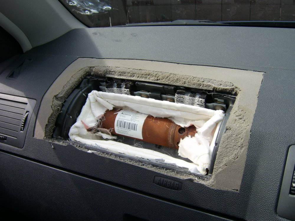

The dash one destroys the plastic on the dash when it goes off.

Oh, Bumpers! I didn't realise it was a MK!. In the MK.2, the air bag is a removable panel... Sorry! Must have looked up wrong forum!
