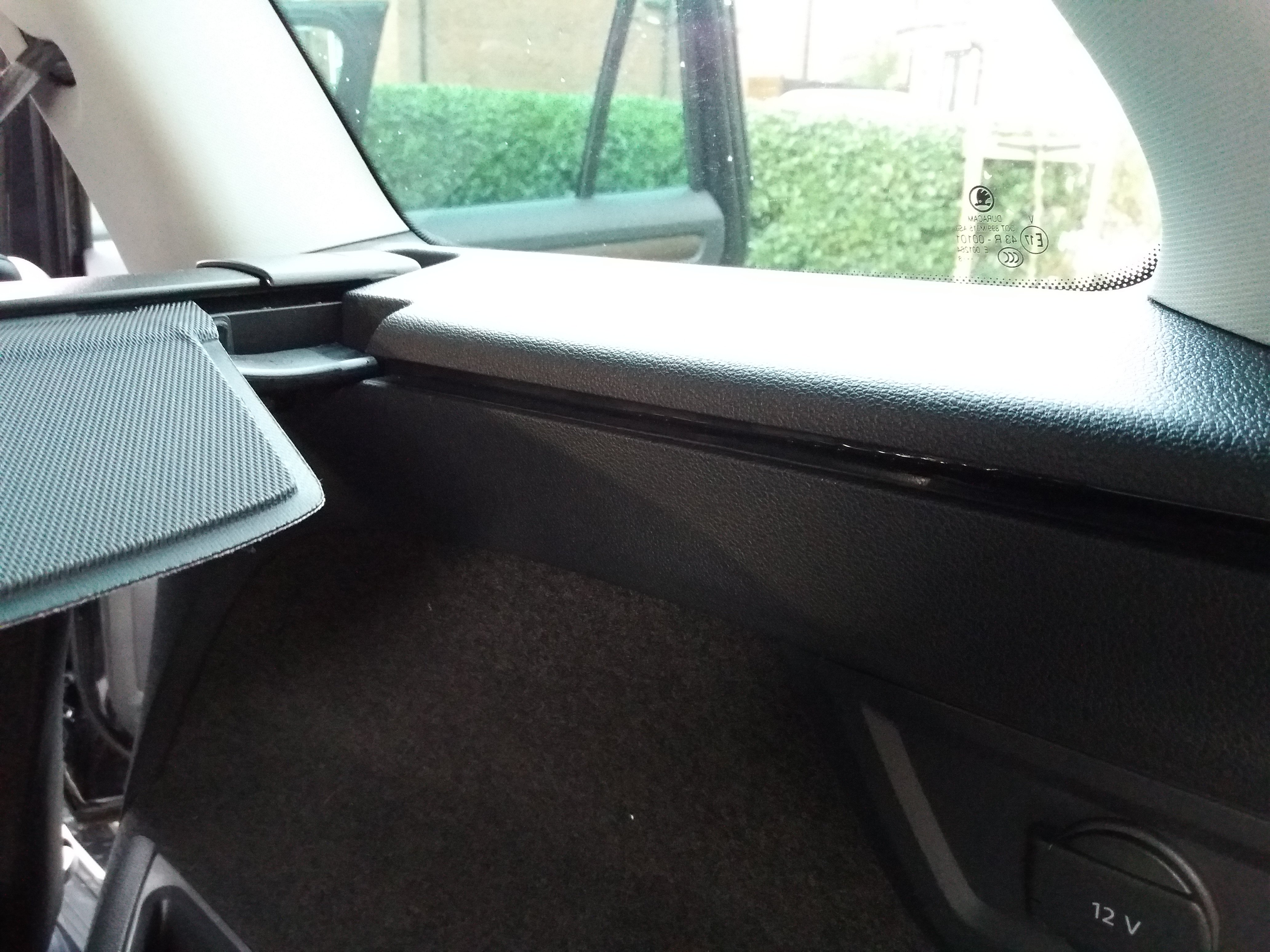

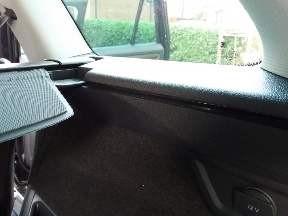

I've observed that the load cover in the boot retracts much slower in my Kodiaq than on our previous Skoda's.

Have you cleaned the guide rails?
Mine is the same.  I also think it is too slow.  Then again I also want the boot to open faster. Feels like ages waiting for it to open.
The car is almost new, so the rails are clean and clear.

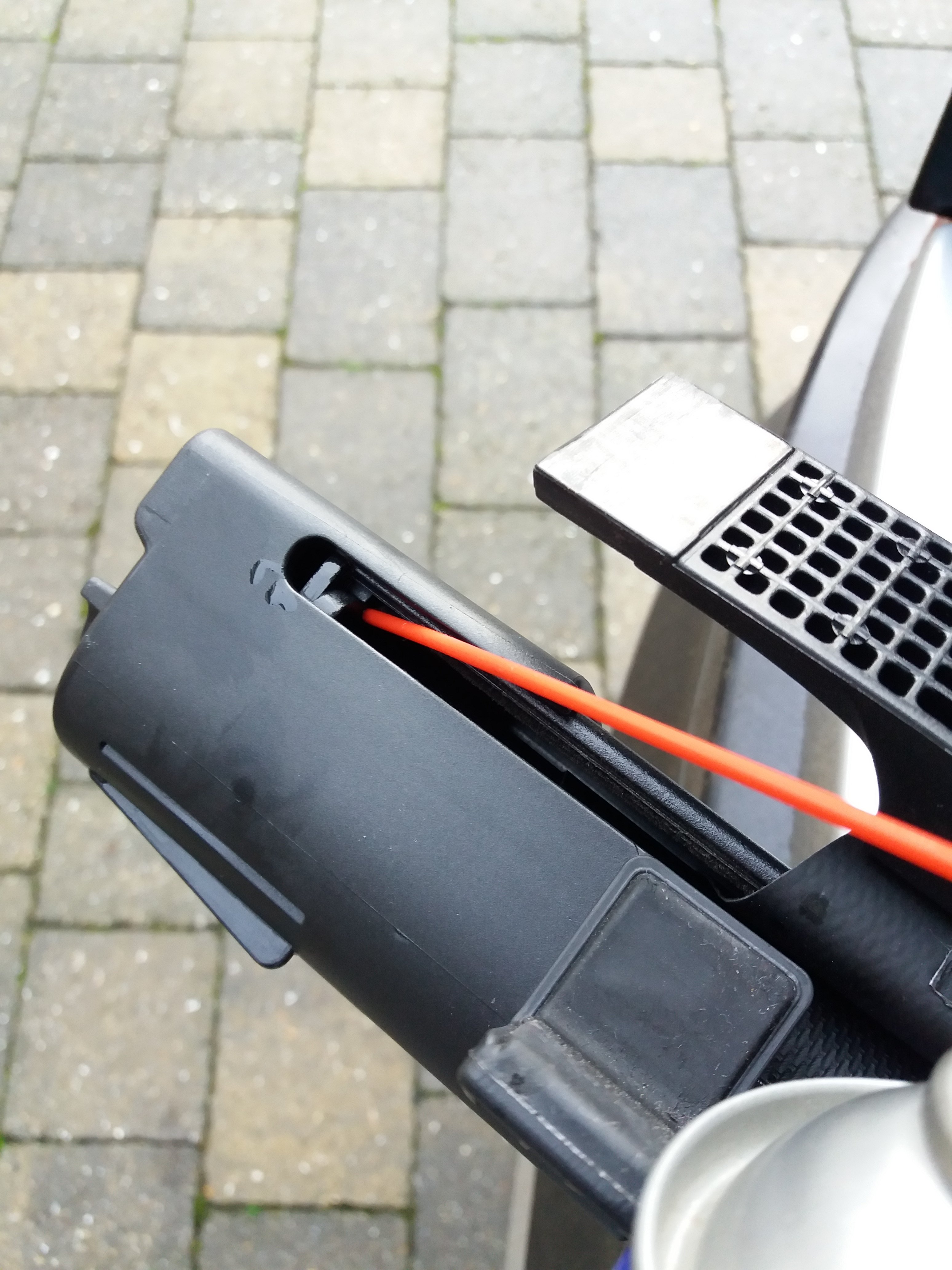

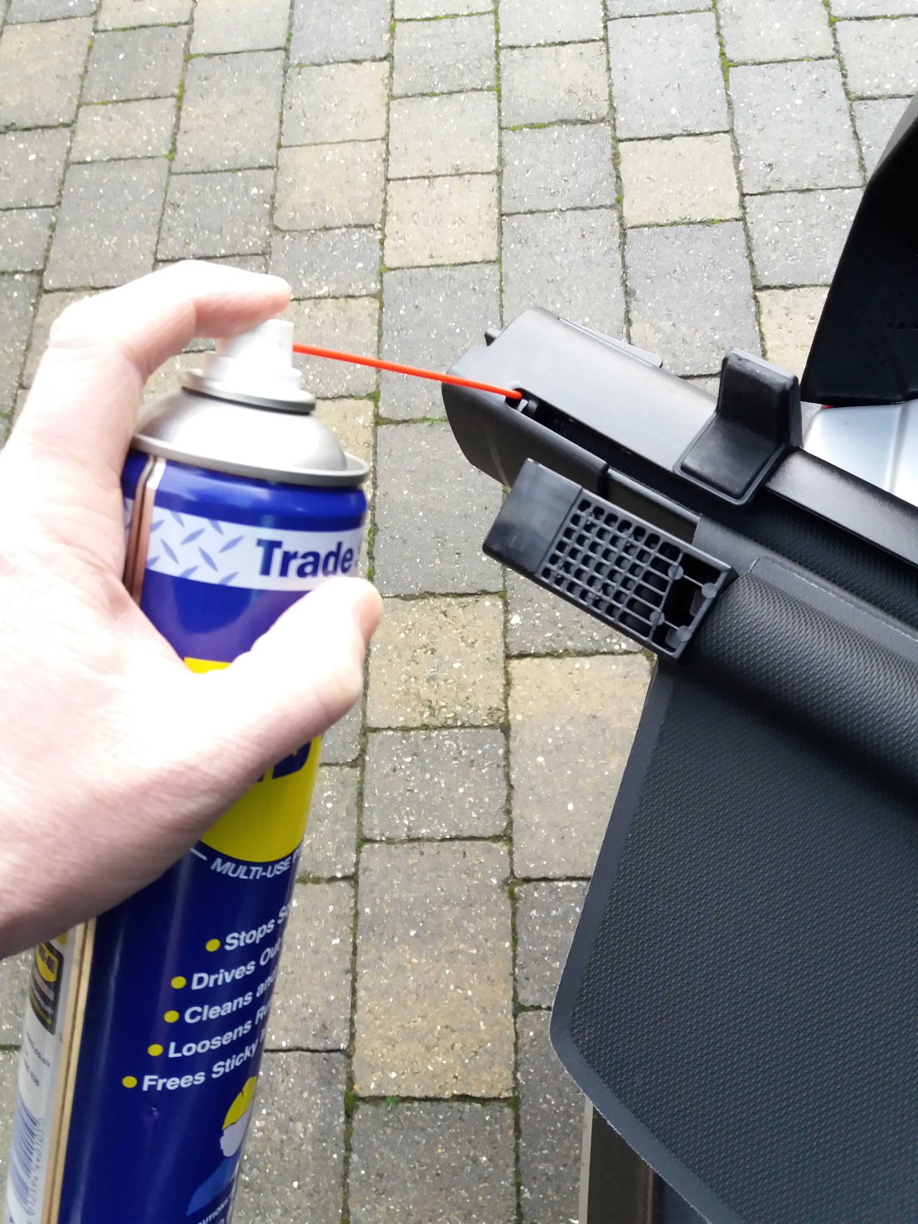

Had the seven seats up last night, so took the opportunity whilst the load cover was out to try a squirt of WD40 on the mechanism and on the runners.
Worked a treat, it's probably about as twice as fast as before...

I tried that, as per the earlier pictures, worked for a little while but it soon slowed down again sadly.
Yep aware of that but the stuff you've used appears to be normal silicon free wd40.  Try something with silicon in...   I use servisol silicon grease the sort used to waterproof electrical contacts.  It works and lasts much better.
