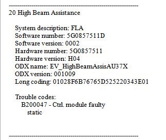

I have found the number. it is exactly as same as yours and it is engraved in the bottom of the unit. Let me find one 2nd hand. I will try to follow the process..by the way, if I take it out now and put it back (who knows it may solve the problem, as unit was brand new when replaced back in july 2017) do I still need coding ?
is it the code you were talking about?
Edited by automass
:D
While this may work for office computers, it will likely not work for your HBA. If it says it is dead, it is quite dead.
However, you will not need to re-code it if you unplug it and plug it back again. HBA has a memory chip that remembers settings even when unplugged - otherwise it would forget the settings each time you turn off the car.
Interesting fact: Coding is specific to a particular make and model (e.g. 2017 Octavia with bi-xenons will have different coding from 2017 Octavia with halogen headlights). If you by some magic find a mirror from the same specification car as yours, you may not even need to code it.
Correct... note down the "Long coding" code. New part will likely have different code, that you'd need to modify to match the one you just posted.

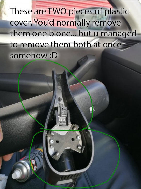

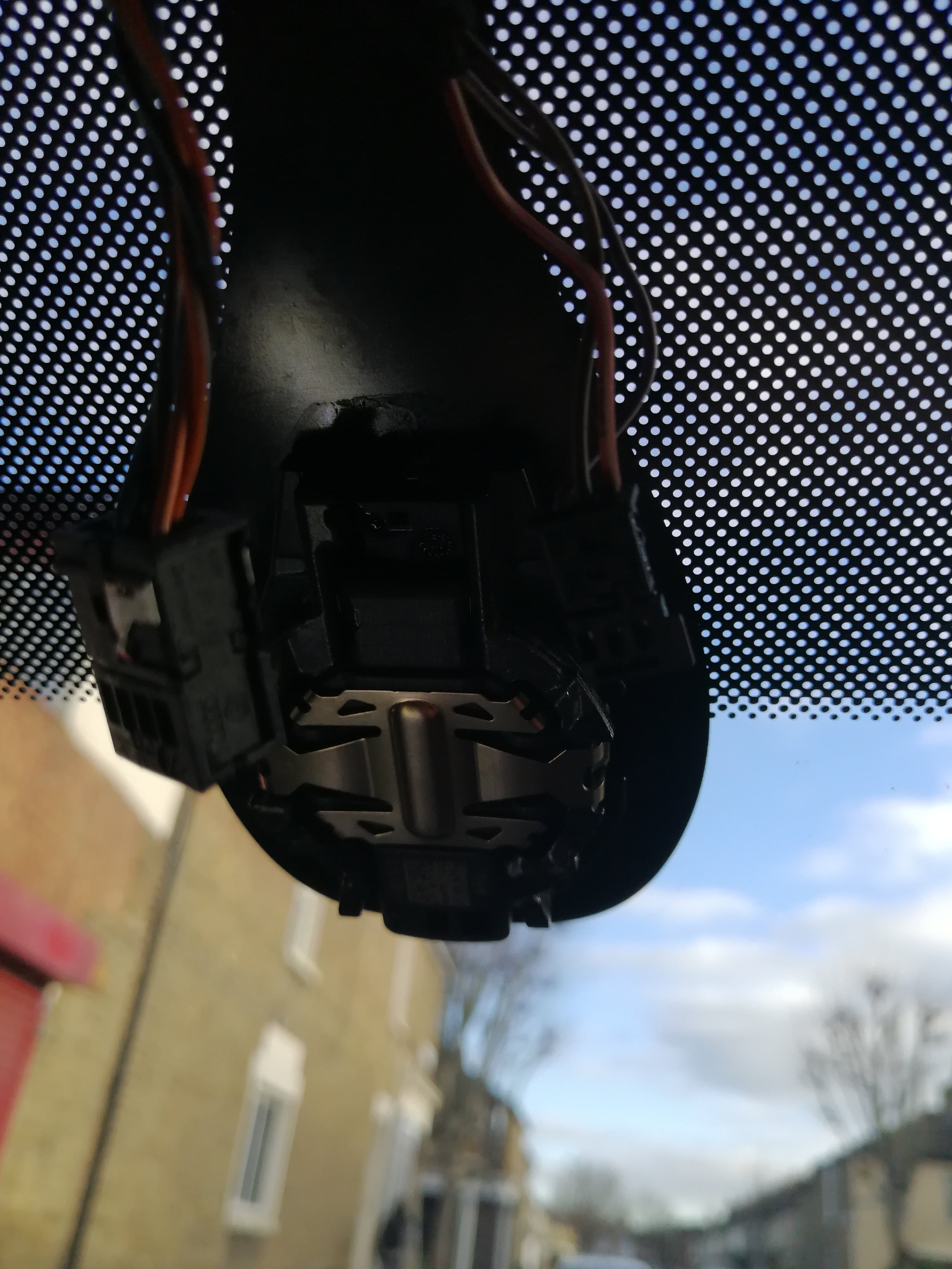

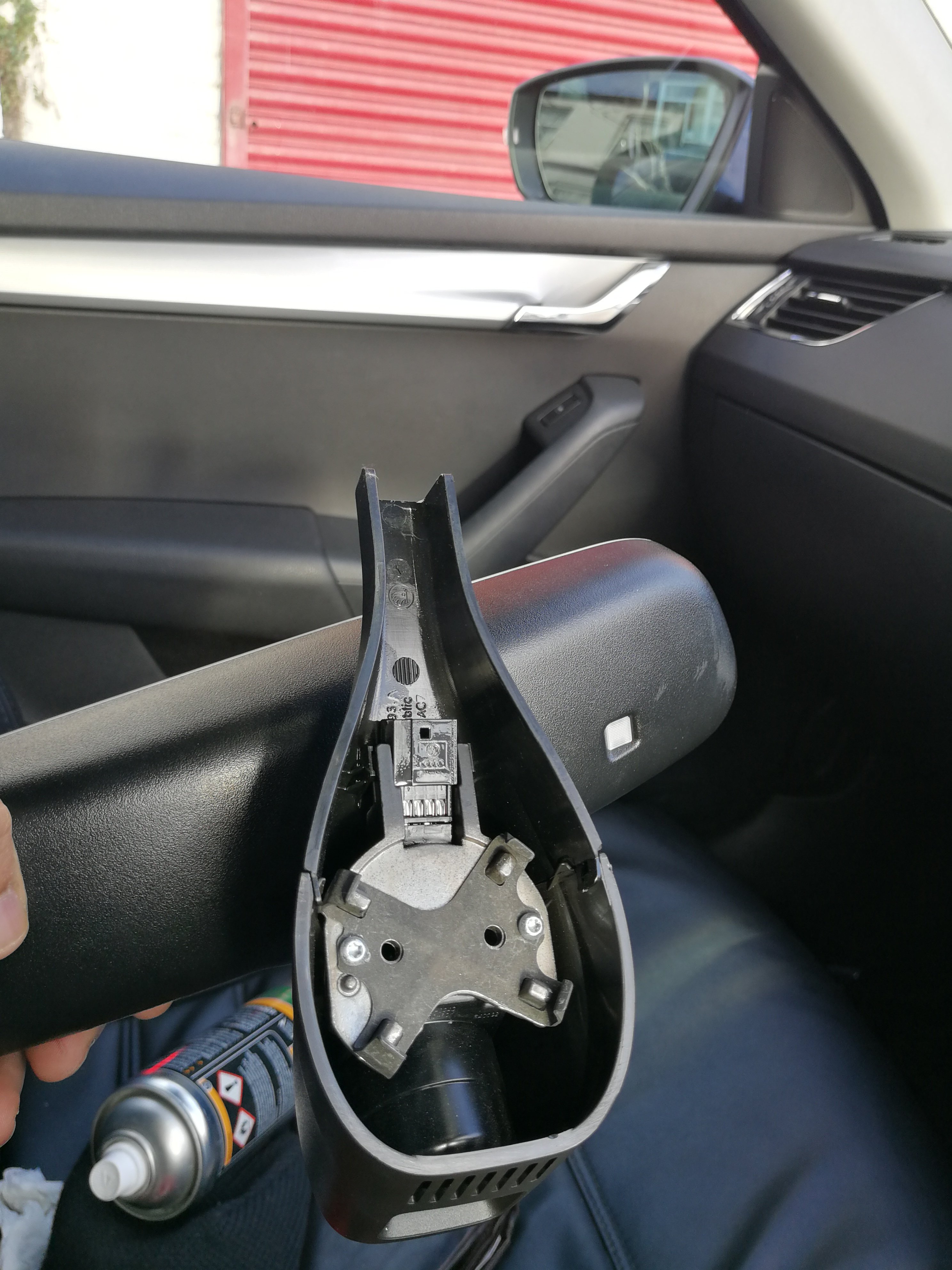

I have tried little bit to take the rear view mirror off, but couldn't dare to force anything as i am travelling this afternoon.  where should i start from? from the big round sensor or from that slim cover which we can see as we looking at the mirror?
Try like to...
But mine is not like that..I got a big bulk round behind. so two separate plastics.
My setup looks very similar to the one on the video and I can remove and re-install my mirror by following the video instructions.
If yours is different, then am afraid I can't help.

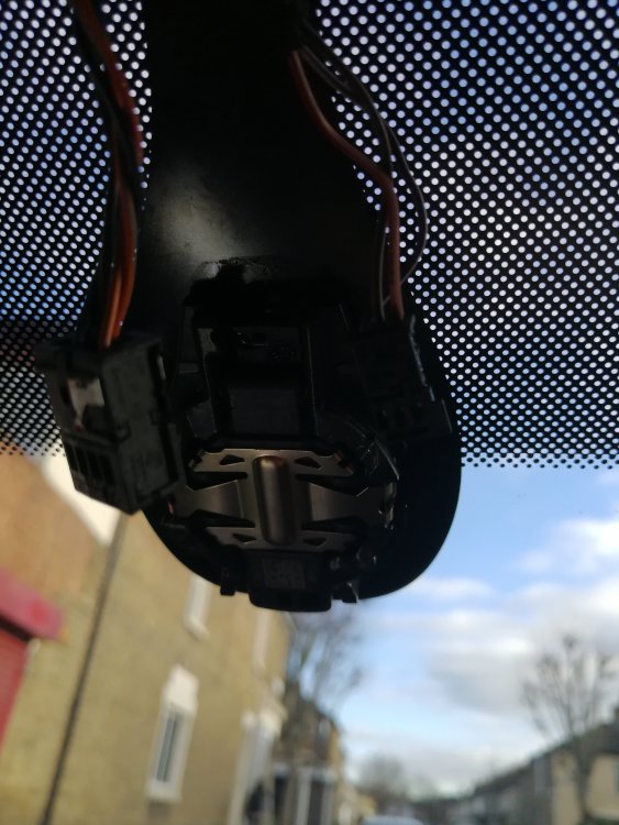

Your car is 2ltr with 150bhp and also estate..mine is 1.6ltr hatchback 2013..thats why may be mine is different than yours..but still i have managed tl take it off..sensor is still attached to the windscreen though..so if i change the mirror only would it solve the problem you think or the attached sensor has to come off?
Mine looks just like that.
