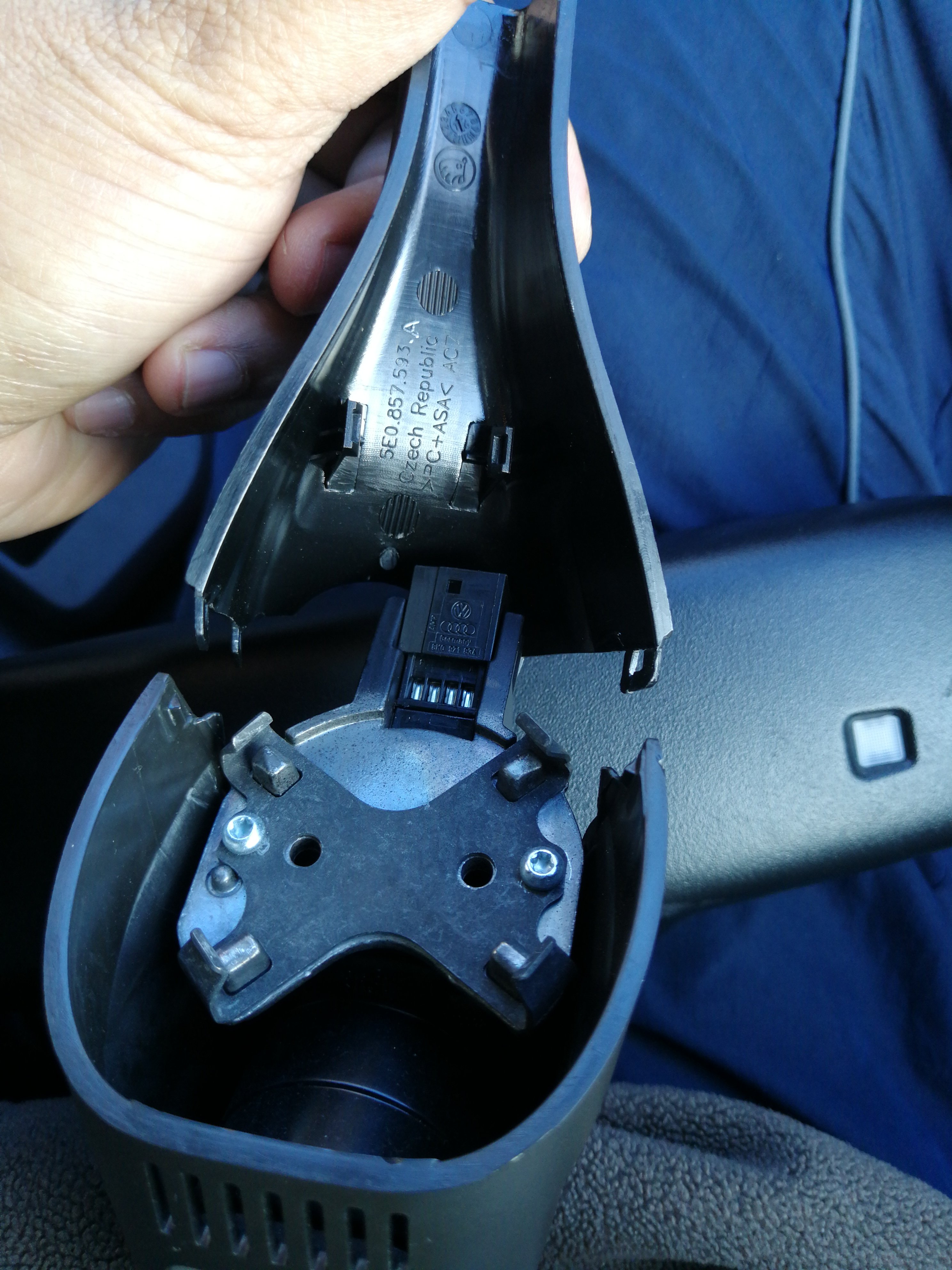

Sensor that is still attached to the windscreen is, as far as I know, daylight sensor (for auto low beam; i.e. for when you set headlights to 'auto'). If auto low beam works, no need to replace it.
High Beam Assist sensor on the other hand is part of the mirror assembly (bit that you have removed and are holding on your hand in the photo). So if you have problems with HBA system, this is the part you need to replace.
BTW HBA sensor is that camera looking part on the front of the mirror.

I have managed to separate the plastic now..mine should be at the bottom part where it needs squeezing..not on the top part on the video..thanks for prompt reply..i have ordered the mirror..once it comes i hope i will be able to replace it and hope problem will be fixed..my wiper works fine..its just hba. Thanks for sharing your knowledge.
No prob.
When reinstalling the mirror, it's easier to first snap the mirror back into place, then connect the cable, then replace the plastic cable cover (top plastic part that you have just removed, in the photo).
Also, your new mirror will likely arrive without plastic covers (those are in fact sold under different part numbers), so you'll have to remove the entire plastic cover (both plastic parts) from your old mirror and place it on the new mirror.

I could win a battle rather than putting that plactic back in place easily..finally i had it done by breaking few clips and some wear and tear on the fabric. You recon i may need to take other plactic cover off too..i tried to take it off,but couldn't figure out. I hope that mirror will come with the cover..
Ouch! Ah well, you live and learn :)
My replacement mirror came from VW Golf mk7. It came with plastic bits attached, but I couldn't use them as those were different from mine (Golf's plastic cover are different from Octavia's), so I had to replace the plastic cover from my old mirror.
Worst case scenario could simply buy those plastic bits from Skoda dealer. Those should cost a few pounds at most.

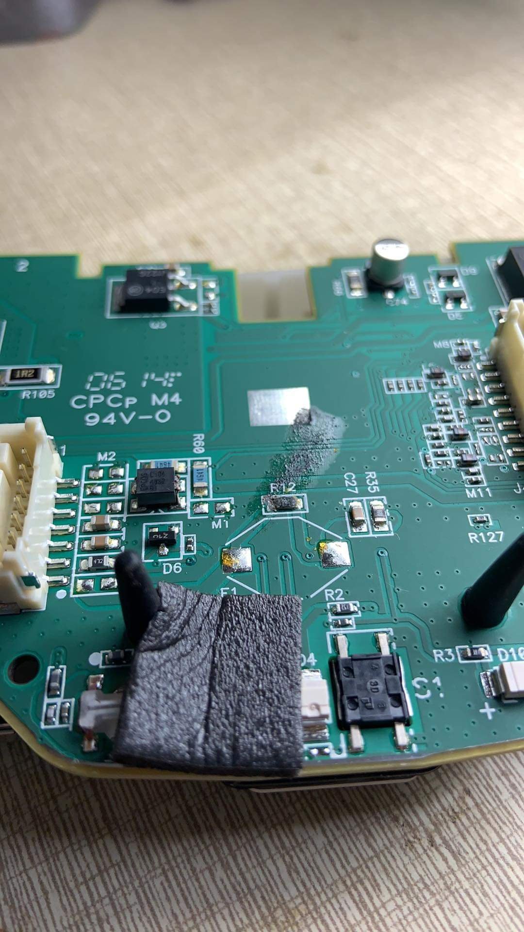

I found another way 😁. Very cheap fix.
Please explain EXACTLY what you did...

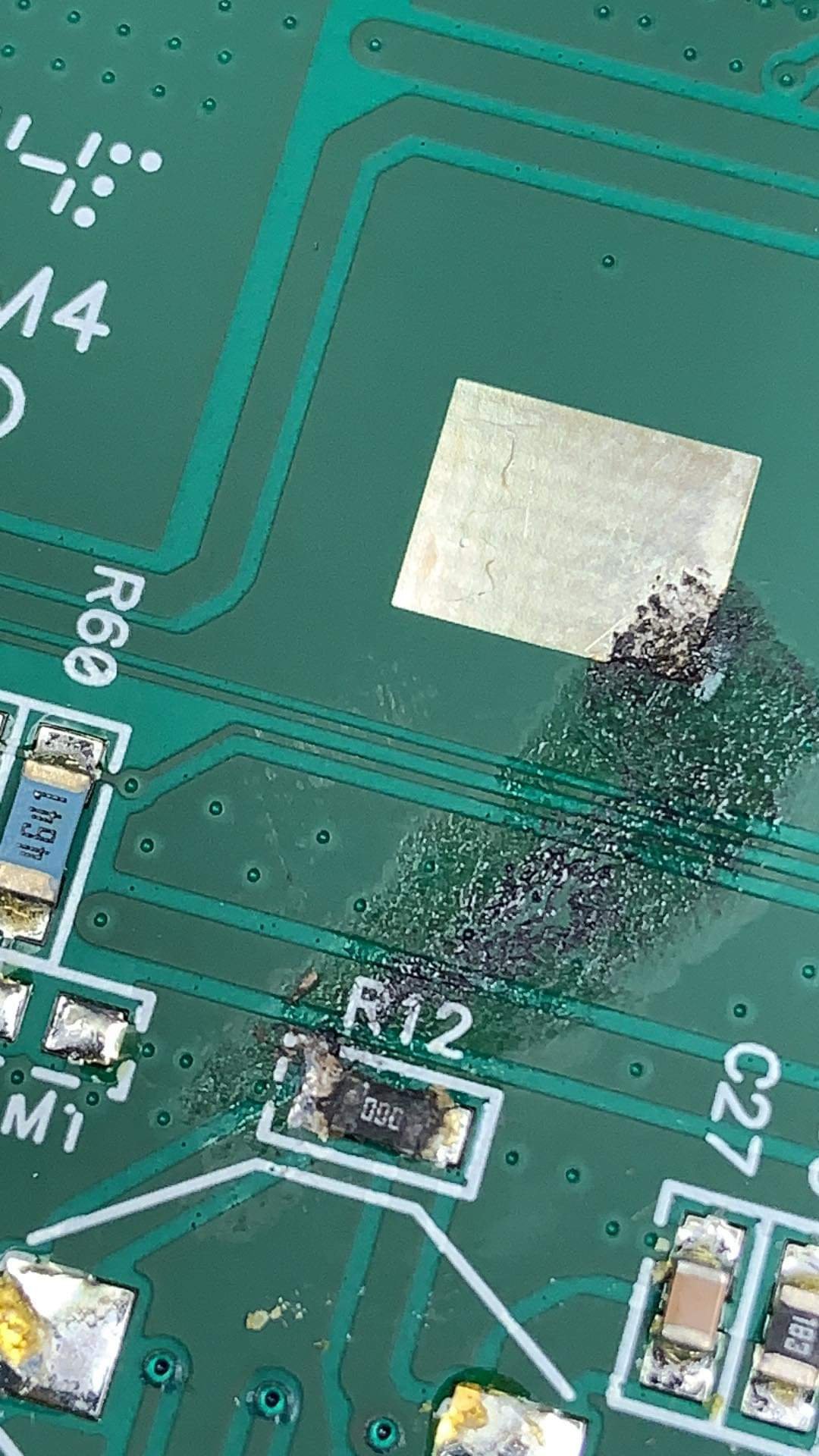

Appears that R12 had a major combustion fault..
I can still solder from days gone by, but surface mount components, weren't in any ofmy Maplin Electronics projects in 1990, more like full size resistors and capacitors on copper boards with holes drilled in it!
Love to what you did to diy fix it.
Edited by paulski
What i did is disassamble the mirror, then you need to clean everythink that is contaminated with burn residue.
After that all you need is to solder a 0 ohm smd resistor on a place where burned resistor is (you can use only a wire to bridge, but my opinion is that thats not safe). U need to remove the burned resistor before solder a new one 😁. After that assamble the mirror and voila HBA is working again.
Btw sorry for my english 😁

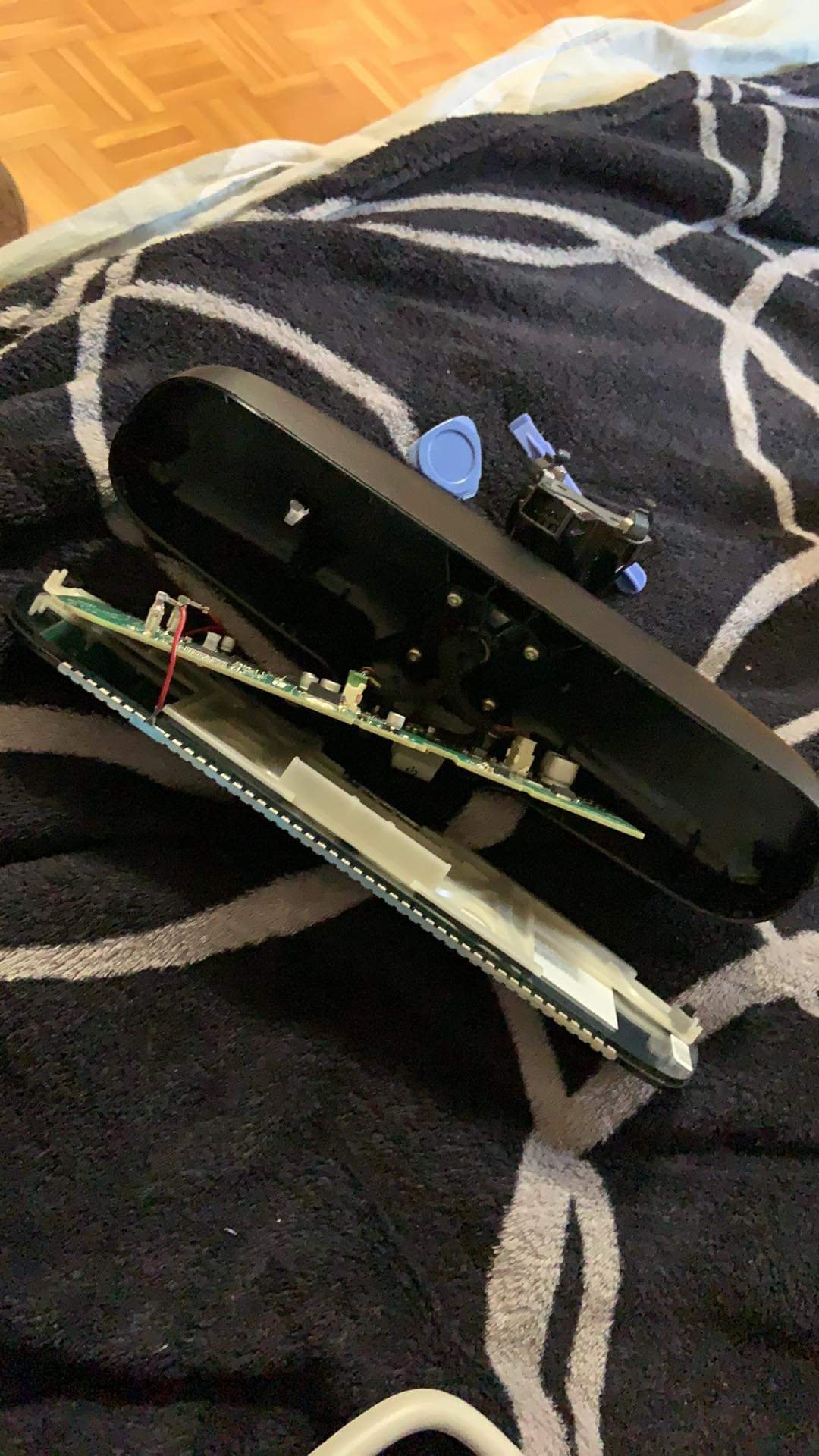

Do you have an idea how to disassemble (disassemble) the photochromic mirror so as not to damage it?
I had the mirror out today. The casing is very tight. My pry tools wouldn't get under it. Need something thinner. Maybe a pry tool for mobile phone.... the casing did seem to flex away so guessing its not plastic welded shut.
