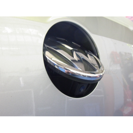

I've not seen a VAG car with a spray clean previously but I suppose it had to happen. In saying that, I much prefer the cameras that are only showing when reverse is selected such as the Golf's.
IMHO that's the best option. I have such "hidden camera" in Mercedes GLA, and it's always clean and ready for use when needed...

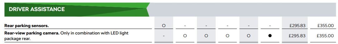

Whilst Skoda UK aren't exactly renowned for their communications accuracy, all their literature and online configurator would suggest they're independent from each other...

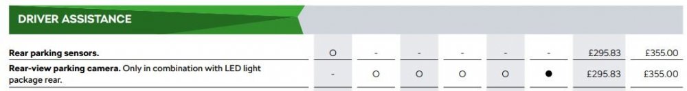

The only additional option you need to add (if it isn't already part of the standard specification for your chosen model) for the rear-view parking camera are the high functionality rear LED lights (extra LED tail light strip on the boot lid, and LED number plate lights), no mention of the free-of-charge rear wiper.

You don't need the rear wiper to have the wash function on the rear camera.

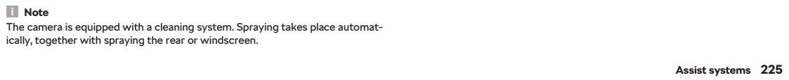

The operation of the rear-view camera wash system is linked to the washing of the "windscreen, or rear screen". So I'm assuming the rear-view camera wash system on cars without the rear wiper is operated in conjunction with the windscreen wash function i.e. pulling the wiper stalk towards you...
Although, in typical Skoda fashion, the manual is very vague, my guess would be that it operates with every 5 or so operations of the windscreen wash system, rather than each time, much like the headlight wash system, where fitted.

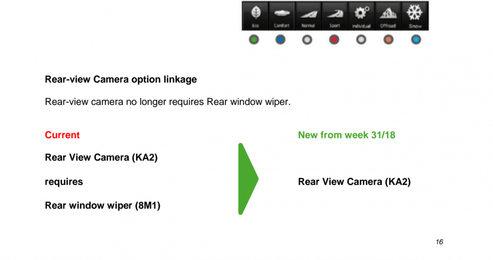

According to the Skoda in their MY19 documented changes, the rear view camera does NOT need the rear wiper.
I believe this applies to the UK market though.

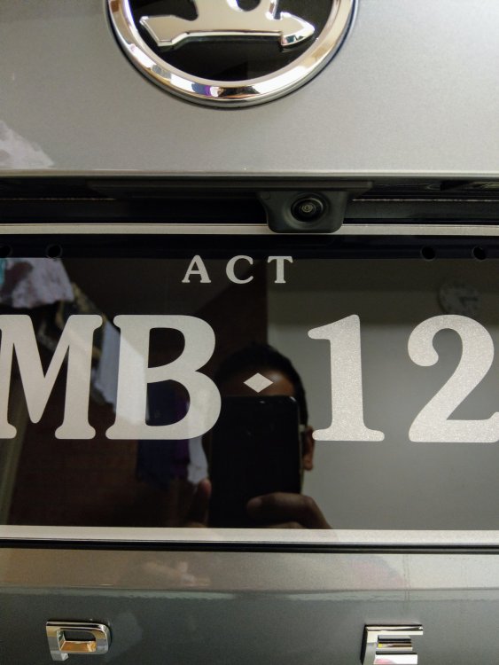

My Superb Estate - ordered July 2018, Delivered end of Oct, does have a wash-spray for the rear view camera.
I think it operates when some combination of the other stuff is active - reverse selected, park pilot on, washing the rear screen.
(Update: the manual on p159 says the rear view camera is sprayed when the windscreen or rear screen is sprayed.)
