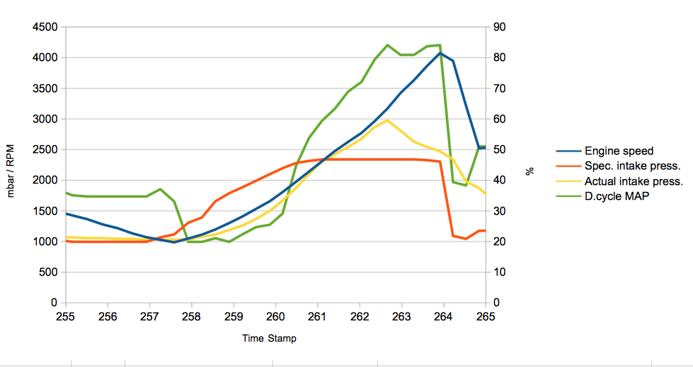

So going by the manual, the advised boost pressure at 3000 RPM should be 2100 and 2600 mbar.

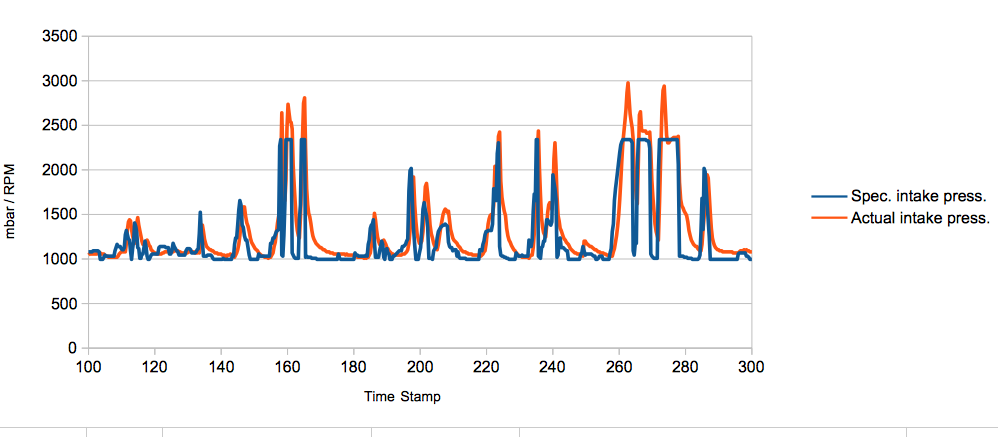

Now sometimes it is but sometimes it is over and logging between 2700 and 3000 mbar.
I've attached a plot running up the Revs and one showing boost over a longer period of runs,
The first plot shows a run in 3rd gear
The second plot shows the expected vs actual pressure over a number of runs, just to show the boost spiking

You definitely need to adjust the actuator linkage quite a bit, it's miles out.
I'm not sure what you're asking since you seem to know already and the graph couldn't be much more obvious.

Yes you want that duty cycle at 4000rpm to be about 75%. It's not too far out, small adjustments is the key. Try just half a turn at a time and log each adjustment. Think you need to lengthen the rod on the turbo to cure the overboost. You will really appreciate the difference after its been done.
Im surprised your recon unit has lasted so long with it over-boosting so high, my one from london turbos lasted 8 months before it went bang, and that was properly adjusted from when i first fitted it.
Cheer....Yea looks like it needs lengthened.  Just been reading one of your posts actually on this.  Hopefully not done too much damage, don't fancy changing it out again.  I'll go at it half a turn and see where we are using VCDS.
Thanks,
Andy
Yeah rod is too short. From personal experience I would aim for the high 60% to low 70% at 4000rpm. Always best to log in 3rd or 4th.
