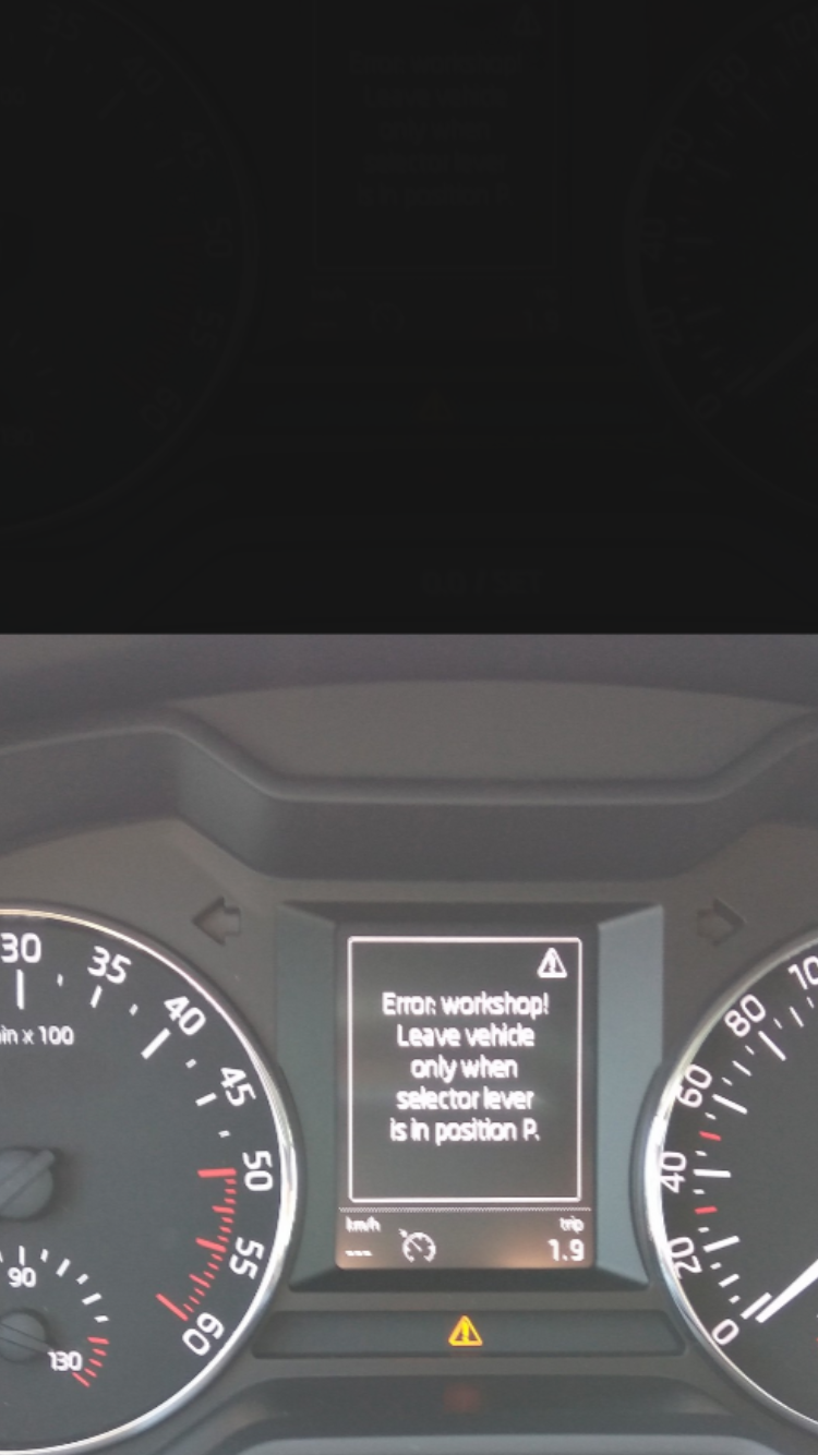

I had a Mechatronic unit changed in September. Now already I am getting the same warning light back on (see uploaded photo).
has anyone else has this re-occurring issue? Surely it can’t be the new Mechatronic unit? Was wondering if it could be the gear selector?
Any advice would be helpful. Thanks
There is a possibility, as there is a common issue where people have needed the selector replacing. See this thread:
Yes this is very common but nothing to do with mechatronics unit
Maybe you should find another dealer to fix this if they replaced mechatronics unit because of this error.
So if it’s not the Mechatronic unit what is it?

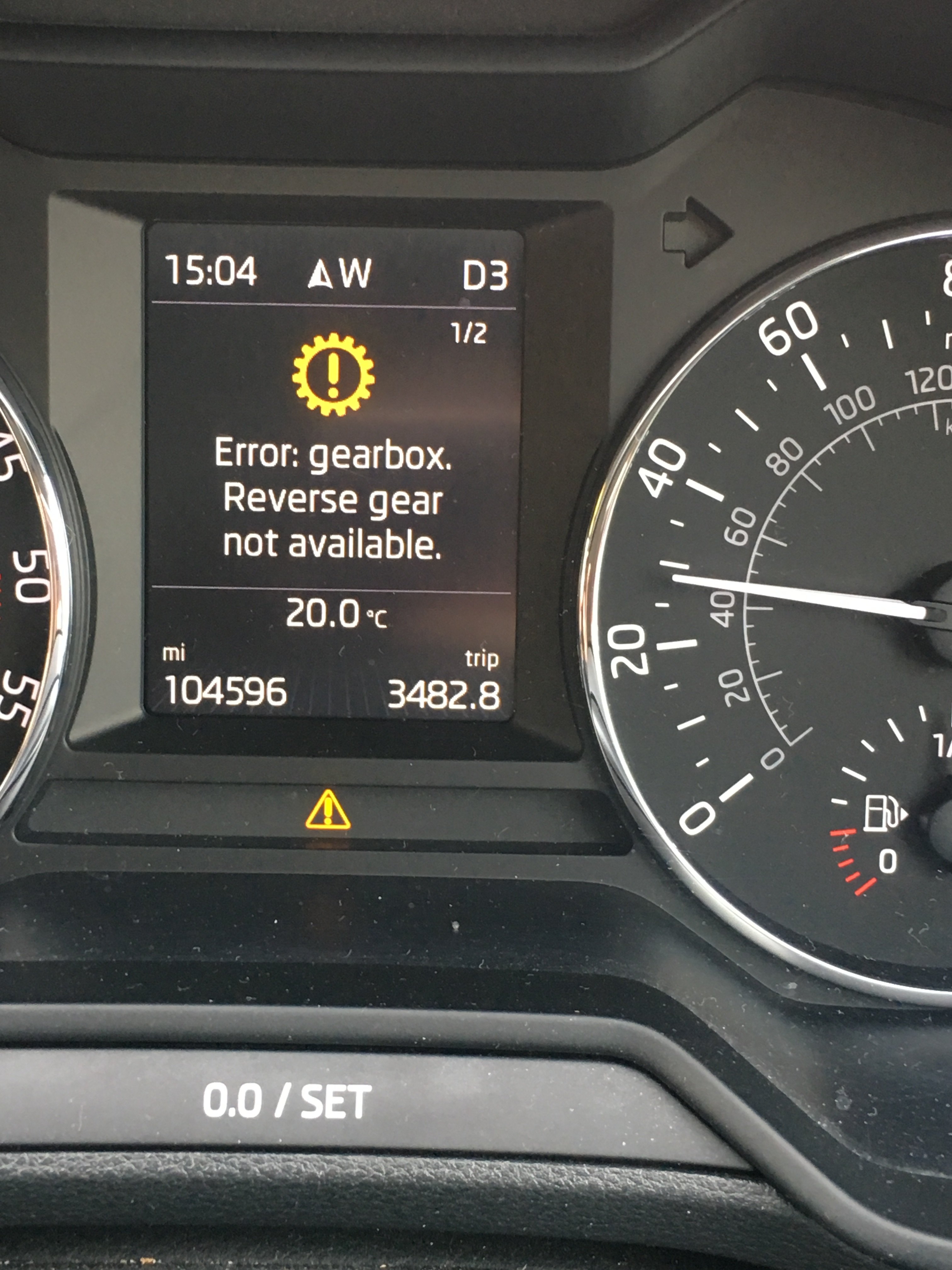

The below picture appeared and I lost all gears except 1st and 3rd. Maybe the Mechatronic unit went which has nothing to do with my gear selector. Sounds like I’ve had two different issues and need to get to the bottom of the gear selector issue
I susspect that the hall sensors (magnets) for gear engagement has collected gearbox metal shavings due to wear I guess.
Since you are driving on the picture there is no reason why mechatronic sw would need reverse gear. The only reason could be, that sensors are not correctly reading selector fork position of reverse gear.
Maybe it is enough to just remove the mechatronics and clean the sensors. And put a magnet on the drain bolt to prevent further problems.
Just my thinking...
Is this the message you are getting now? Your first post showed a different message

I also had the gear lever changed under warranty due to the Error Leaving P Workshop message.

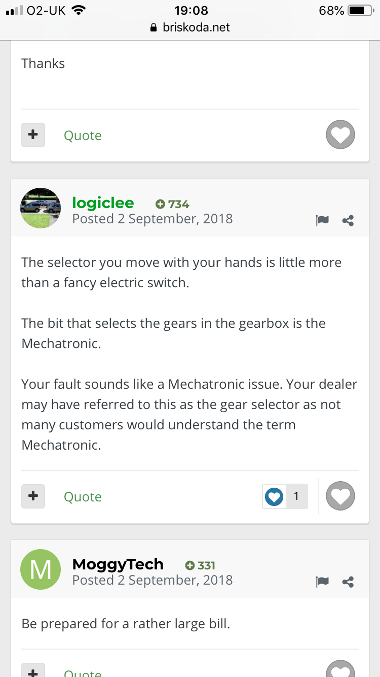

Back in September I was on here to find out about a Mechatronic unit. This bloke in here seems to think the Mechatronic unit and gear selector leaver is the same thing? I know it’s all to do with the gearbox but wasn’t to sure it’s the same thing.  What do
yoi think of his comment?
No not the same thing and that’s not how I read his post. He is right, the selector lever is little more than a fancy switch that sends commands to the mechatronic. But the “fancy switch” has position sensors which can play up, giving you your latest error message.

The Error Workshop P message is when the ECU receives an "Implausible Signal" from the gear leaver.  The fix for this is a new gear lever assembly.
Thank you for clearing this up. I have been getting The workshop message intermittently now for over a year. No sign of it failing so might leave it for now. I’m covered with the AA so might wait until it actual goes rather then spend £1000 on it now and it may never actually need replacing.
