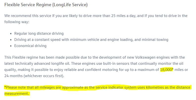

You should be OK, be wary though, variable is "up to" 20,000 miles, so depending on your journey type and driving style it could be less i.e. 15,000 miles.
It is actually 18,641 miles, not 20,000 miles, it's a conversion from 30,000 kilometres.
