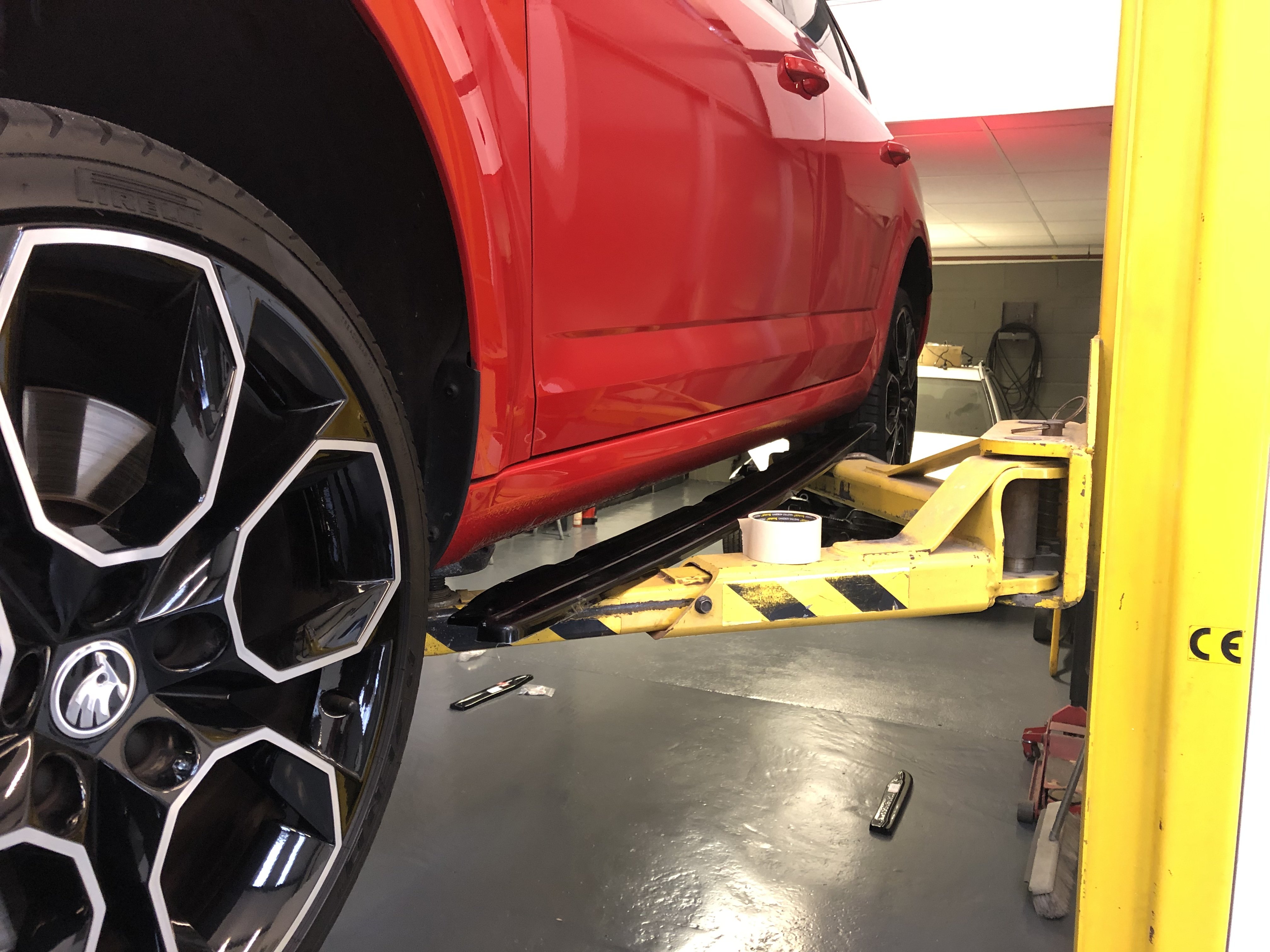

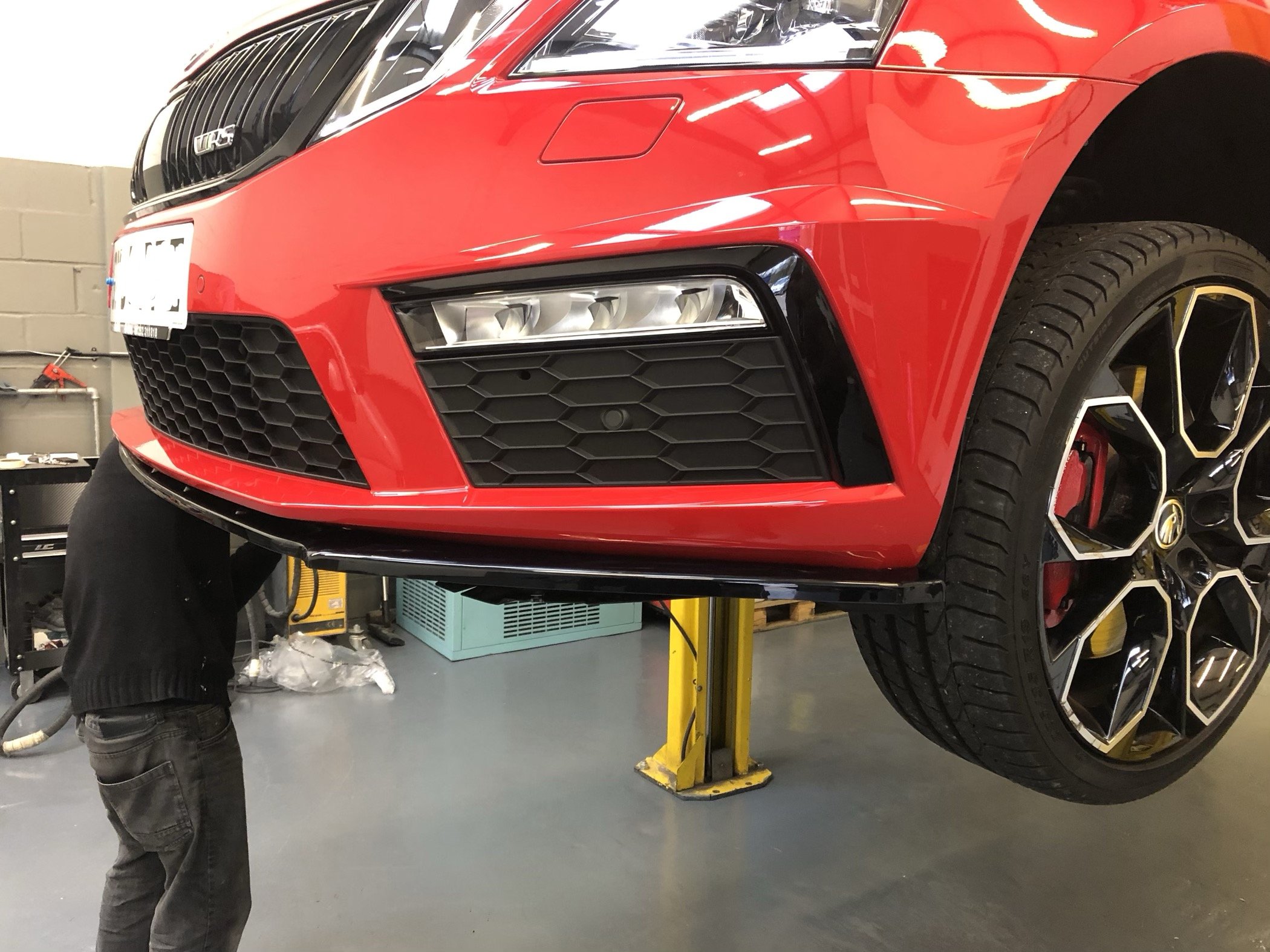

What was involved with the lip and skirts? Much drilling?

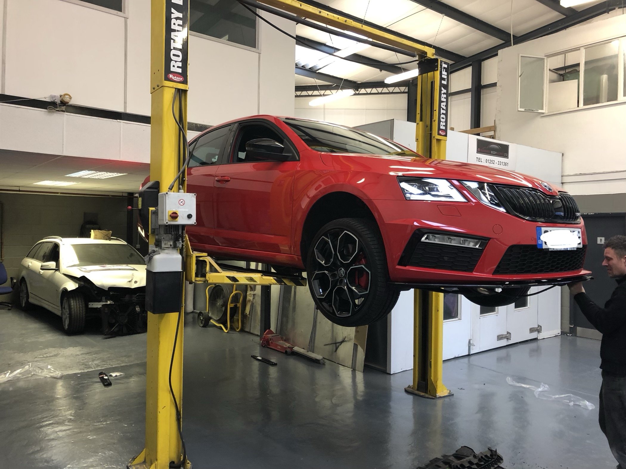

Easy but needs 2 or 3 sets of hands!! Need to remove the front undertray to tighten the bolts and just drill around 15 hols through the splitter and bumper and then use the supplied bolts, took about an hour. The skirts were easy and took about 10mins each side, they come with self drilling bolts and I used 6 across the bottom and then 4 at a slight angle to make sure it was all tight They came with 10 bolts for each side.
Might be trickier on the drive but a good mate runs hos wn body shop so popped on the lift and made life A LOT easier :)

Very nice. Got any closer photos of the skirts? Interested how it looks where they meet the sill.
They should have come as standard on a vRS!
I can get some pics tomorrow but the fit incredibly will and are spot on perfect.

same skirts?
any good?
11 minutes ago, JohnnyType2 said:
same skirts?
any good?
Mine are from Super Skoda, same as the front lip.
