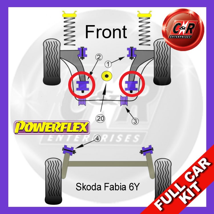

If they mean the console bushes, which I think they do, they are shown in the red circles here....

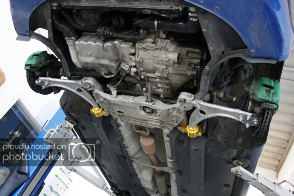

This is a pic of an Octavia but it's very similar. The yellow bushes....
you need to ask the question if its front axle or rear axle//     the front wishbone rear bushes are very common to wear, the rear beam do with high mileage
recommend to change to poly bushes as they will last the lifetime of the car so you wont be doing them again Skoda fabia bushes
