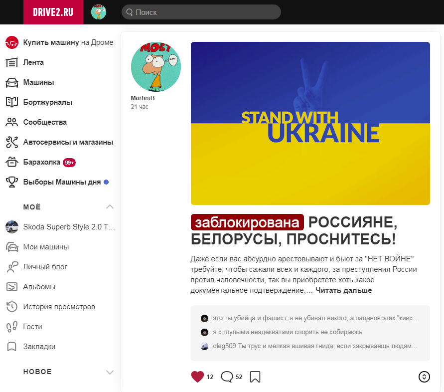

the link does´t work anymore, please share an updated link with us
my account were banned few days after 24. feb. 2022
