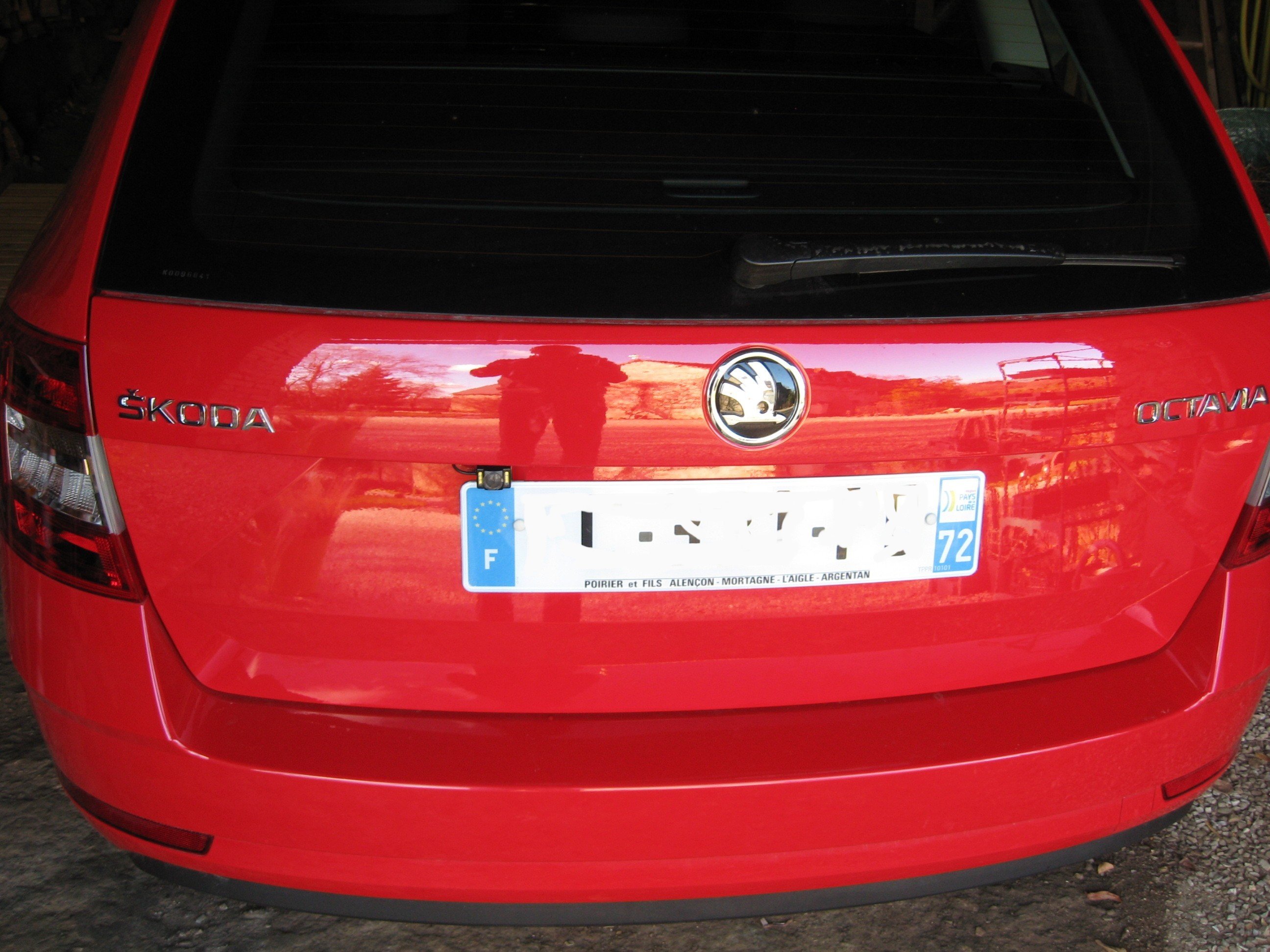

 However, I've had a poke around this morning and I think I've found the best spot; I located the rear camera  at the end of the number plate and checked that the reverse parking view was still good before fixing it (which was a faff as French plates are riveted on).  With the offset position it isn't vulnerable to knocks when opening the tailgate.  As an aside, the camera works great and records front and rear as well as giving parking assist when I select reverse gear, so it all worked out okay. :)

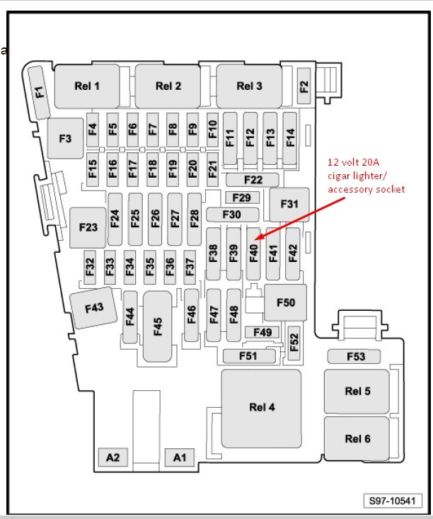

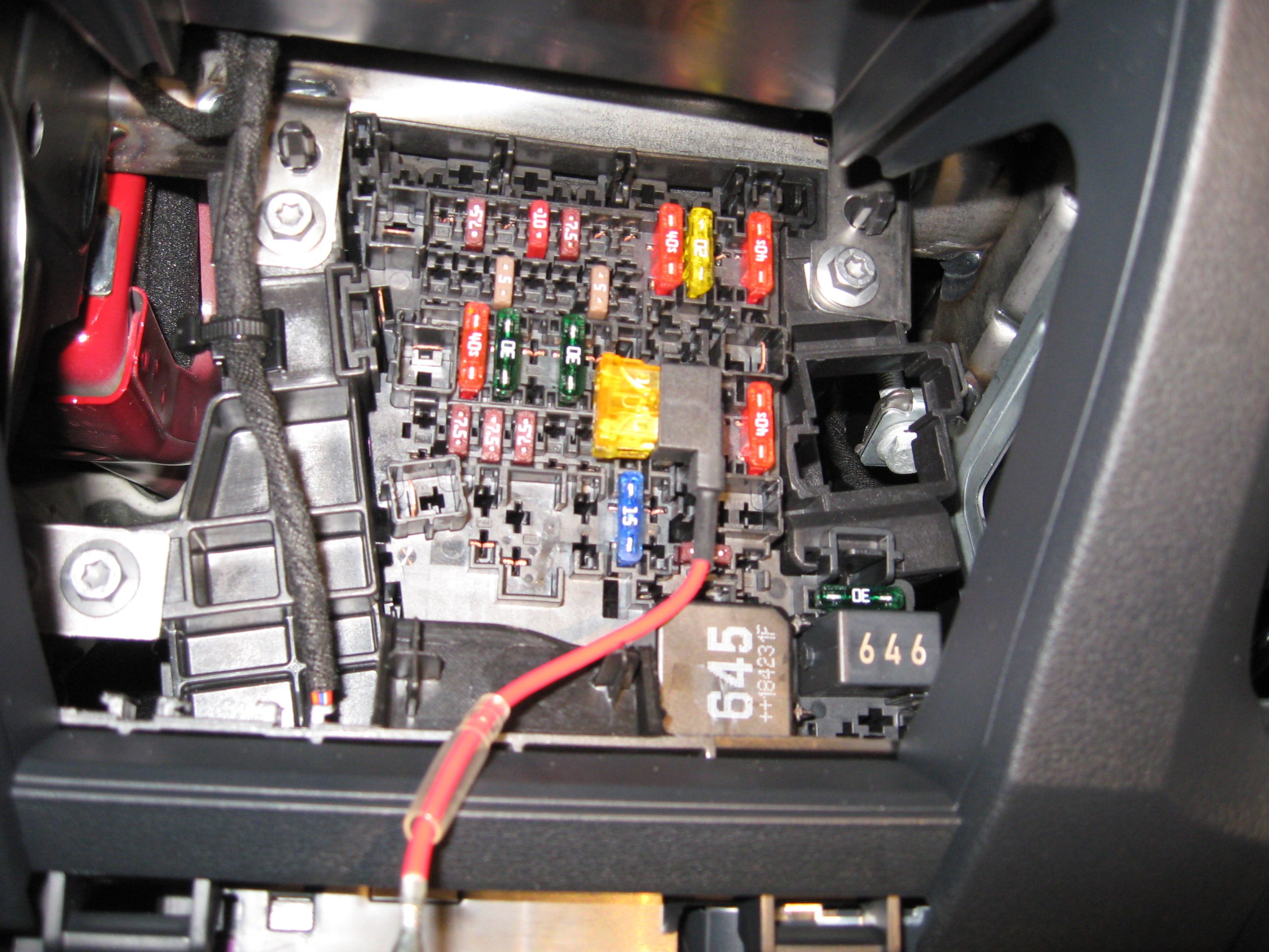

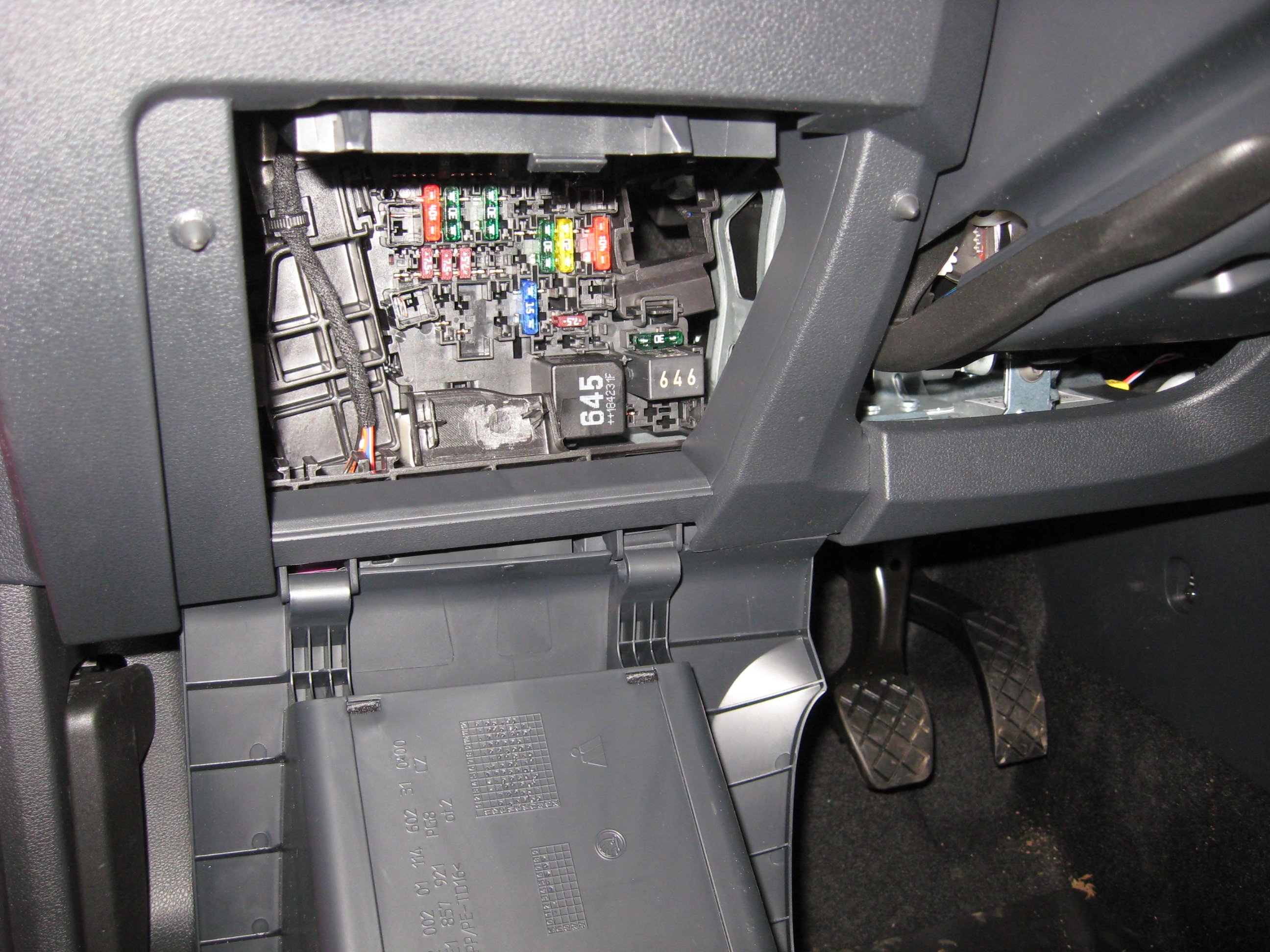

Hi Kev - the supplied cigar lighter lead does indeed contain 5v transformer. For simplicity I bought this kit (see below) when I ordered the dashcam as it contains everything for hardwiring - the fused connection just piggybacks the existing fuse F40 and the lead has a micro usb that plugs into the mirror cam in place of the original cigar plug lead.  I fitted it today (in the perishing cold) and it's all working great. I've attached the fusebox pics and diagram just in case it's useful to anyone - being LHD my fuse box is behind the driver's mini glove box which just flips down for access to the fuses. There's plenty of space behind the fuse box to stash the spare cable and the transformer (cable tied to stop rattles).   :)

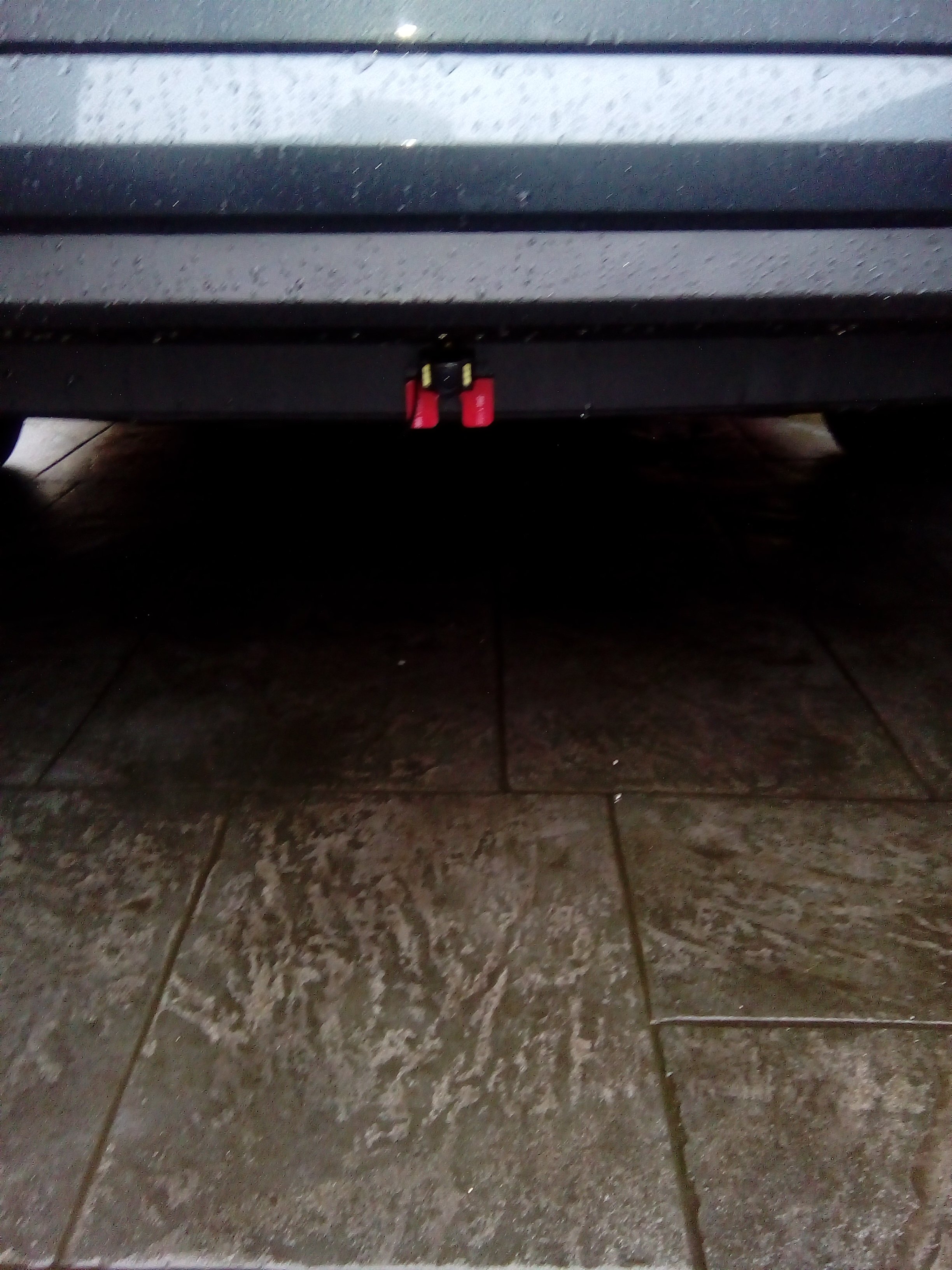

Yes I have that same camera mounted on the rear bottom diffuser. No drilling , just sticks on and easy access to boot via rubber grommet .  feed wire down under diffuser and up through grommet.
Drat - too late.  That would have been easier than guiding the wires through the rear tailgate, too.  Never mind - thank you anyway.  :)
I like your thinking, but doesn't it just get covered in road crud?
