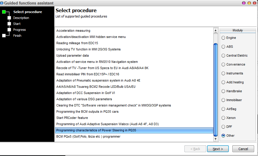

Hey guys, sorry for interupting i have serious problem with power steering, i recoded this but now i dont have power steering, and got fault codes can u help me pls?
 i was using characteristic of power steeering in pq35
What exactly did you do to the module and what diagnostic tool were you using?
VCP, i think i reporgrame that
What exactly were you trying to do?
Do you have any link that describes what you tried? Or can you explain the steps you went through?

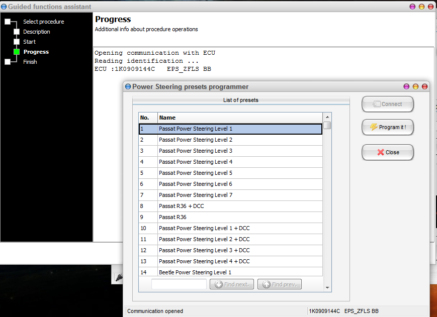

This is what i did, it was silly move ...

When I tried changing steering curves, the first step was to update it to the latest software version. Looking at the part number above, you've not done this which might be why it's no longer communicating.

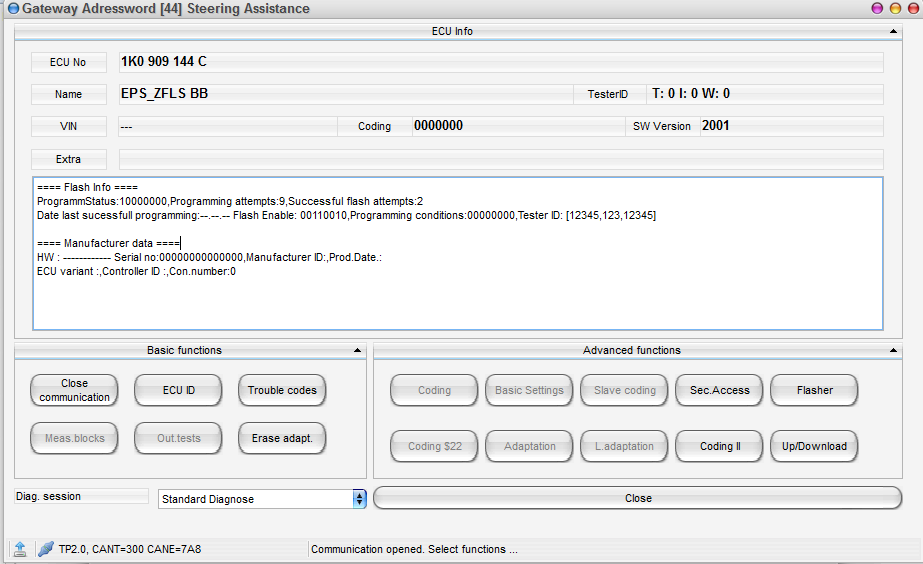

Yo, can you someone give me data from these ecu. important is 1K0909144C,

via drive.ru flashed and paste new eeprom setings
Thank you,
Did you then managed to flash a different characteristic onto the power steering or did you "just" revert back to stock?
Yes, thats its only eeproom problem so you chose curve what you need, i chosed midle, and its harder than its been, compare to next S2.
