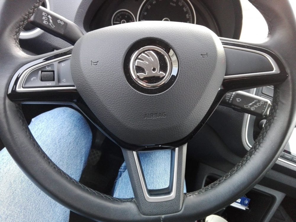

I'm waiting for the parts numbers from Skoda dealership to be confirmed as the one from the photo is a factory fitted citigo with multifunction steering wheel.

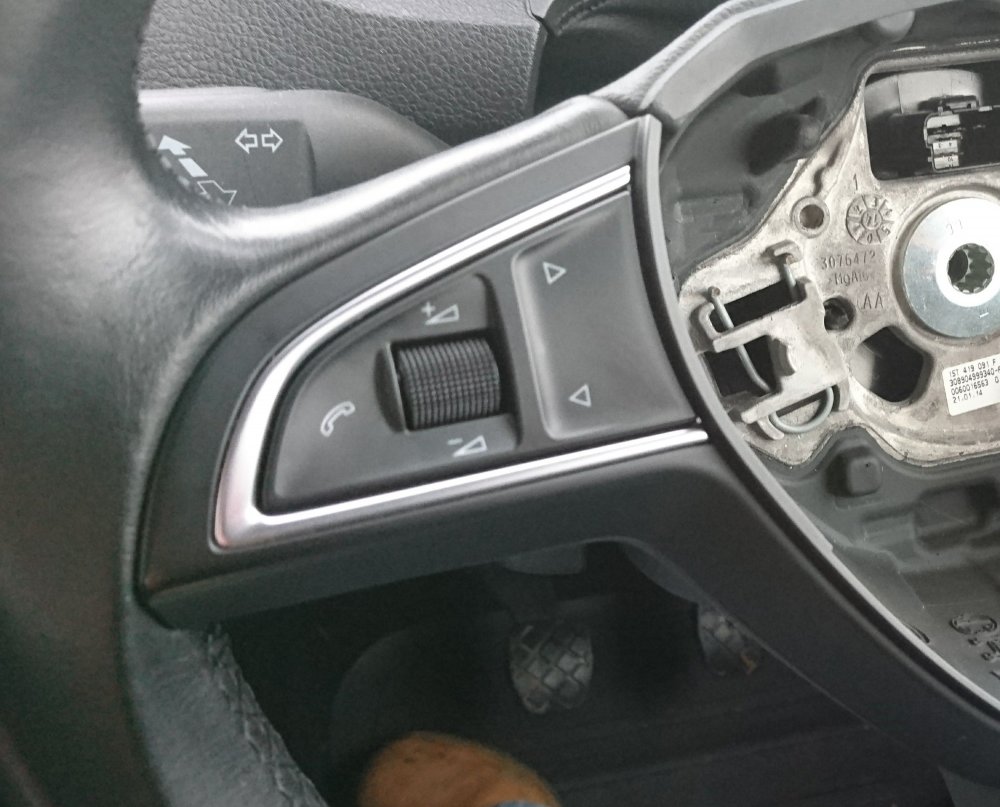

happy days! getting closer to having a MFSW on my citigo. Pictured switch is a # 5E0919719C. Didnt want to LH/RH switches as the "double" ones come with variuos additional options which may not be supported by my ECU/BCM such as lane assist/cruise control.
Somebody on the forum was asking if it is/was difficult to remove steering wheel trim to replace the switch. Trim is just pushed into place, however, main steering wheel body is made out of rubber. as the trim sits very tightly in the steering wheel body a fair amount of mild persuassions is required to pull the trim away.

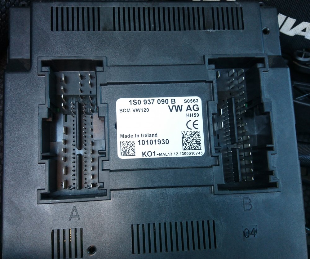

Below are details of my current BCM taken out of vcds scan.
Address 09: Cent. Elect. (J519)       Labels: Redir Fail!
   Part No SW: 1S0 937 090 B    HW: 1S0 937 090 B
   Component: PQ25 BCM      H59 0563
   Revision: -8------    Serial number: --------------
   Coding: 64B8290000010000000009F42C28ACD07740426F7E820440200000420000
   Shop #: WSC 31414 790 00001
   VCID: 326BACC96D2F66DA13-8066

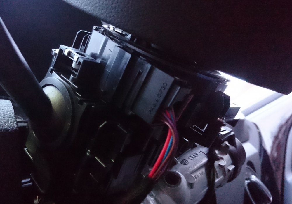

Despite of not being 100% sure if my bcm will support MFSW, I've decided to add necessary wiring.
After removal of steering column trim I was desperately looking for white connector as described in 'how to retrofit MFSW' on polo's forum. To my despair i couldn't find one. After a sleepless night spent on browsing the wiring manual for citigo's I found THIS. On this diagram it clearly shows wiring for the MFSW on our citigo's. So, by following the wire colours from the diagram I've managed to find where the appropriate connector is. It's located on the top left underside, pretty much next to the indicator stalk.

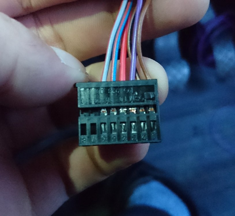

Another difference would be in the pin numbers. As per attached photo:
LIN pin would be no.3 (purple) and +12v would be pin no.4 (red/black).
Today I've run out of daylight as I don't have garage I will resume or at least try to, re-attach added wires at the other end.

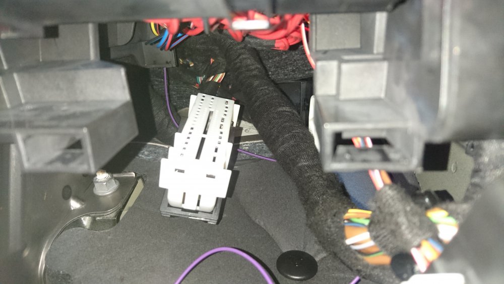

Oh dear! It wont be as easy as would expect. Undoing connectors from the back of the BCM unit was very fiddly
due to a VERY limited space there but doable.
However adding the LIN wire to T73b/PIN 17 looks imposible to me without removing whole BCM of its mount. For ease of access it looks necessary to remove relay holder/fuse box in the driver footwell.
Any ideas? Recommendations?
I have managed to remove BCM unit from behind the relay holder. But despite of gaining bit of free space it is insufficient for me to work on the white plug :(
Luckily for myself, after I have removed BCM i have noticed, that BCM is empty :dull: so even if I would manage to add the wire to the connector ot would not make any difference as its not there... I suppose I need to update my BCM

I'm 99% certain you need to change the BCM. I can't see any examples of a B rev with a MFSW fitted and given the pin is missing, I can't see how it would work.
A similar example would be a MK2 Octavia with a 'lowline' BCM fitted and the owner wanted front fog lights. They'd need to replace the BCM for a 'highline' with the extra pins needed for the fogs.
2 hours ago, P3P5I said:
And mostly thats why I have contacted Skoda as to which BCM I should be upgrading.
If you gave Skoda a VIN from a Citigo with a factory fitted MFSW they might confirm the BCM part number. I think you'll be hard pushed to get anything more from them.
After a quick google, I've found autoscans suggesting a 1S0 937 090 F, H or J rev BCM all support a MFSW but never a B rev.
