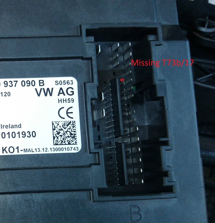

to retrofit MFSW you need facelift BCM with pin 17 ( no prefacelift with it ).  But every facelift need new wiring to clocks ... No wires, no communication with BCM - non running car ... its easy ...
3digit letter code is addictional code - no need for it, its for ordering corfigurations ( coding, adaptations ) - everything can be manualy edited ... Anyway, the code isnt on BCM label, so you cant choose on used unit ...
BCM of same version should have same HW and SW revision ... so all must have same pinout - so pin 17 must be there ... but check it via photo, for sure :)
And pin T73b/17 its easy to find, see my picture above ...

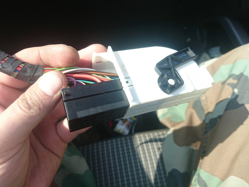

How I gained enough space to work on the plug? Everyone is different in my case, I have removed a bottom part of the dashboard trim. Detached bcm connector from the back of the unit and managed to shift it upwards, just between steering rack and fuse/relay box carrier.
It's only matter of connecting it to the other ends and finally swapping bcm module. Nearly there...

After many attempts and terrible headaches, having my forearm scratch by the body work and being pain in the bottom for @danikd and without his help I wouldn't get this running, finally my MFSW came to life!
First of all, my biggest scare, was how to add the wires to the T73B connector. Tried to follow the advice from team-bhp forum by getting access from the behind of the BCM... nope, couldn't do that. so, I found aa different approach. by loosening bottom part of your dash board trim and pushing the required plug towards the top of the relay holder I was able to gain enough space to work comfortably on through the top side.
