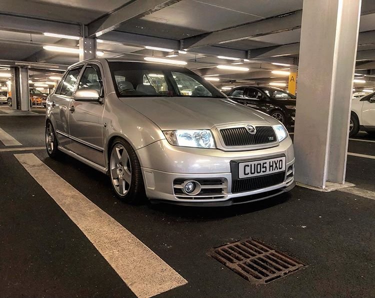

I’m on KW V1’s and can just about put my hand between the wheel and arch.
I’ve not taken any measurements so have no idea how much lower it is, but I don’t not have any issues with speed bumps. I tend to drive over the square ones and have never hit my sump.

Looks really smart that mate, well nice
How much lower do you reckon it is from standard if you was to guess, wouldn't the 17" wheels make a difference as well?
Cheers fella :thumbup:
I dunno, maybe 50/60mm?
A difference, in what way?!

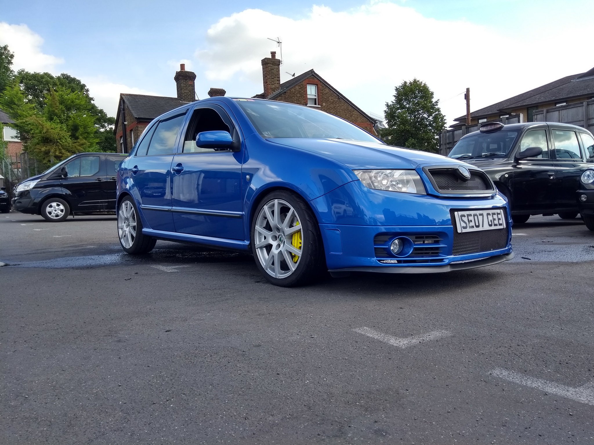

I had AP's on mine. Was wound down 50/60mm. Scraped a few times up ramps but was fine over speed bumps if taken at a lowish speed. Under tray removed. 2018-12-15_09-21-15.thumb.jpg.18da904a50d1a5b7c975537f89b07658.jpg

That's a cracking finish on that paintwork mate! I'm guessing thats been clayed?

Looks smart that mate
Pictures like that make me think just go Coilovers haha
was it the undertray that scraped a few times before you took it off?
are they 17” spiders as well? As if be runnning the standard 16”s

Thanks. I did a full correction about 2 years before that picture was taken then washed it's regularly

Was already off when I bought the car. I've had the undertray scrape even at normal ride height before with a passenger on board. I was taking about the front lip on the bumper scraping lol.
Yes they are the 17" spiders.

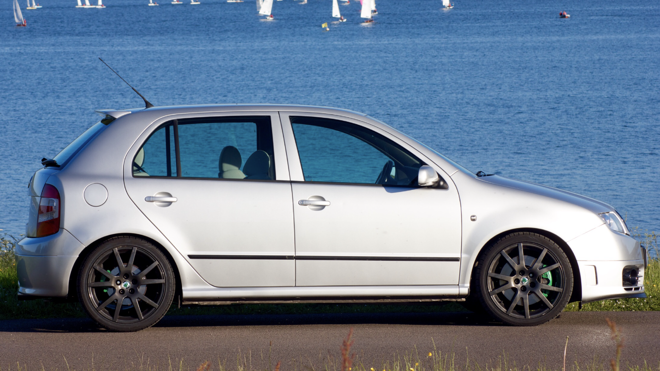

Mines dropped about 80mm, My arb rubbed the driveshafts with puma droplinks so I had to get 160mm droplinks instead. The ride isn't the greatest but i am quite low and I've never hit my sump as it doesn't sit that low on the vRS, only thing I've really rubbed is the subframe and splitter but this rarely happens
