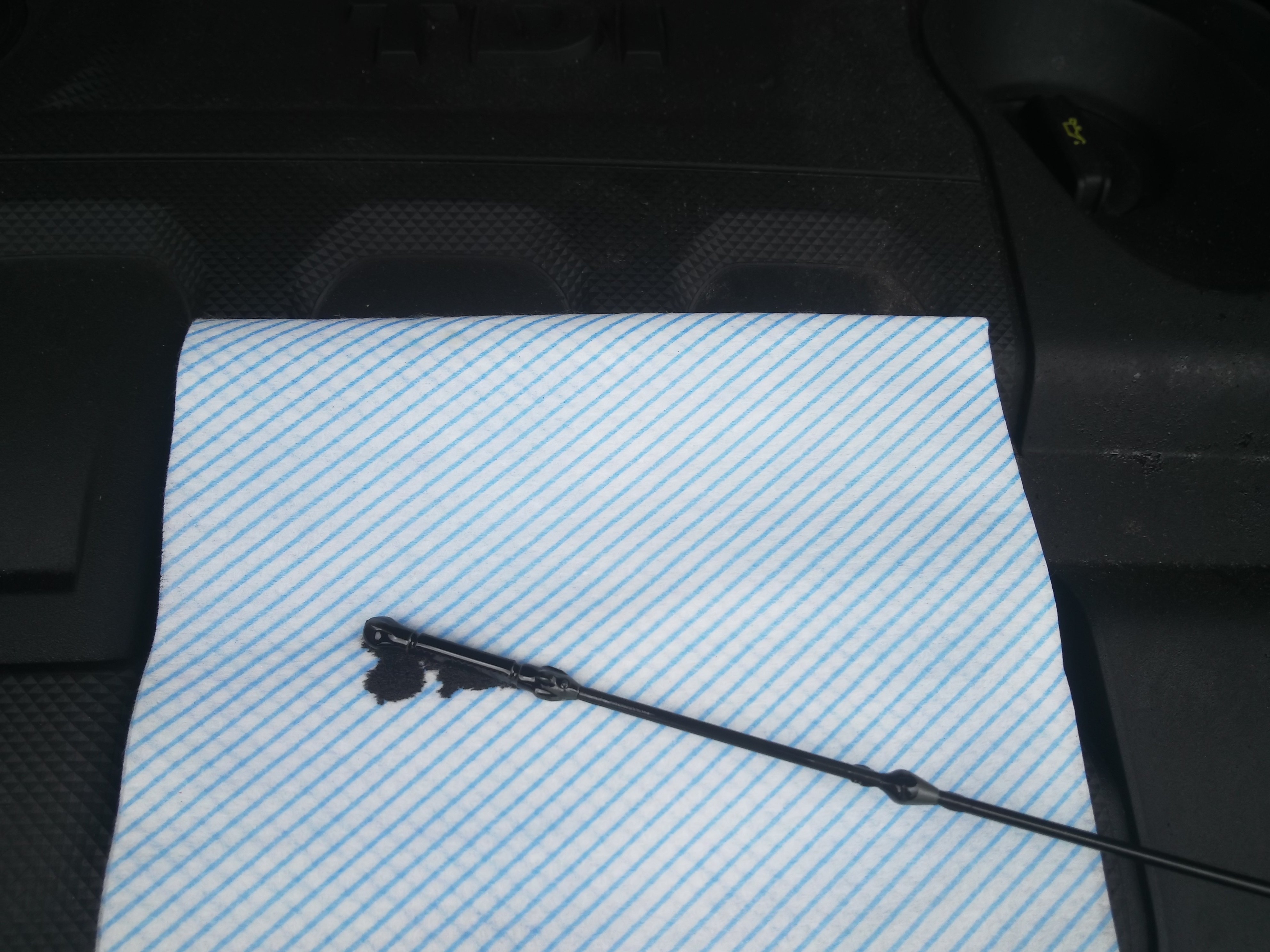

FWIW I have just put 0.5l oil into my 2.0TDi after 16k miles (25k KM). It would probably have gone to the service due in 3K miles without a top up, but I have  tour of Scotland coming up so added some for a safety margin.

How did the oil on the dipstick look at 16,000 miles.
When my SEAT 2.0TDI SCR / DSG was at that miles it was like clotted cream even though it had had some top ups,
by 19,000 miles it was treacle & by the time that it was into the dealership for the oil and filter change i felt for that engine.
It did great MPG though and even better after the new oil and filter.
I would never run a car i owned that long on Oil, even Long Life Oil.
Long life oil / variable - flexible servicing and a car i would not want to own after 5 years.

It looked pretty good for 16K old oil. Black as you would expect, but felt viscous and 'soapy' in my fingers - still like oil should in my limited experience. No clotted cream around the filler or dipstick, no bubbles or anything. It ran off the dipstick not too quick and not too slow when I held it up. Checked hot after a 8 mile run home, last 5 up-hill. Granted, if it was mine I'd have changed the oil before now, but its a lease and I'll follow the manufacturers schedule :blush: In fact the Citigo we own has had 2 oil changes so far in it's 7k mile life.
I was pretty careful to get the right oil to add, there are so many specifications now it is not clear what oil you should use. The days of buying a litre at the petrol station for a top up are long gone, what with long life servicing, DPFs, Ad-blue and all the other gubbins that can be affected. Have to say Opie Oils website was helpful and I ordered from them as living in the sticks means a long trip to get the correct oil. For the record I got Shell Helix Ultra Professional AV-L. (Try saying that after a pint!)
