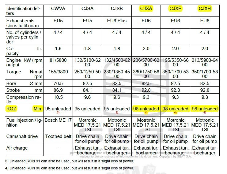

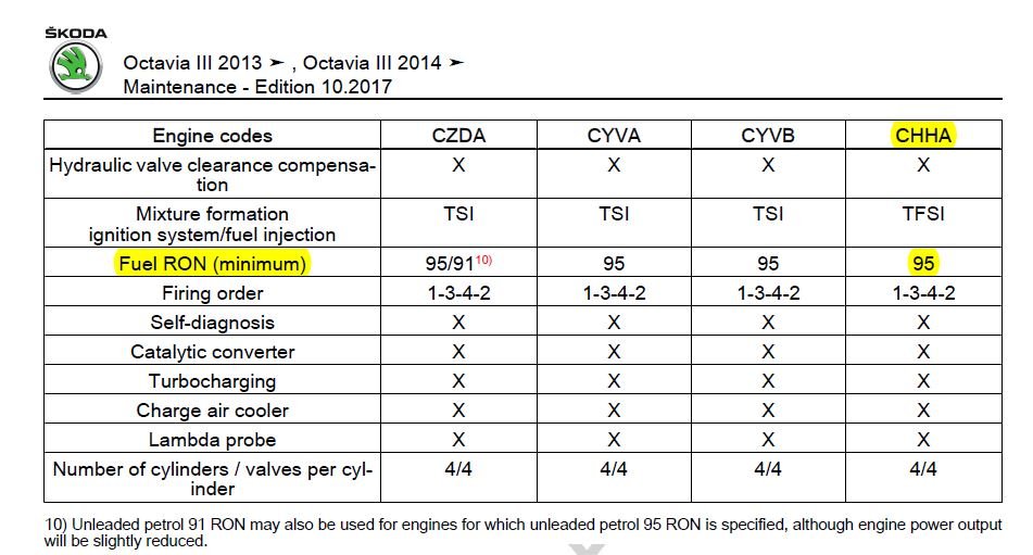

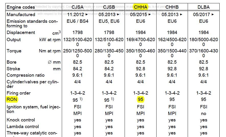

For your engine 95 RON will be OK. I'll post tables with technical data of your engine and a table where is specified the use of 98 RON for other 2.0 engines with more power. Your money, your choice.

ROZ is the equivalent of RON in Germany. All the tables are from EU country manuals. For @Maggle:  Look under fuel flap, you 'll find the octane your engine is mapped, designed for.
