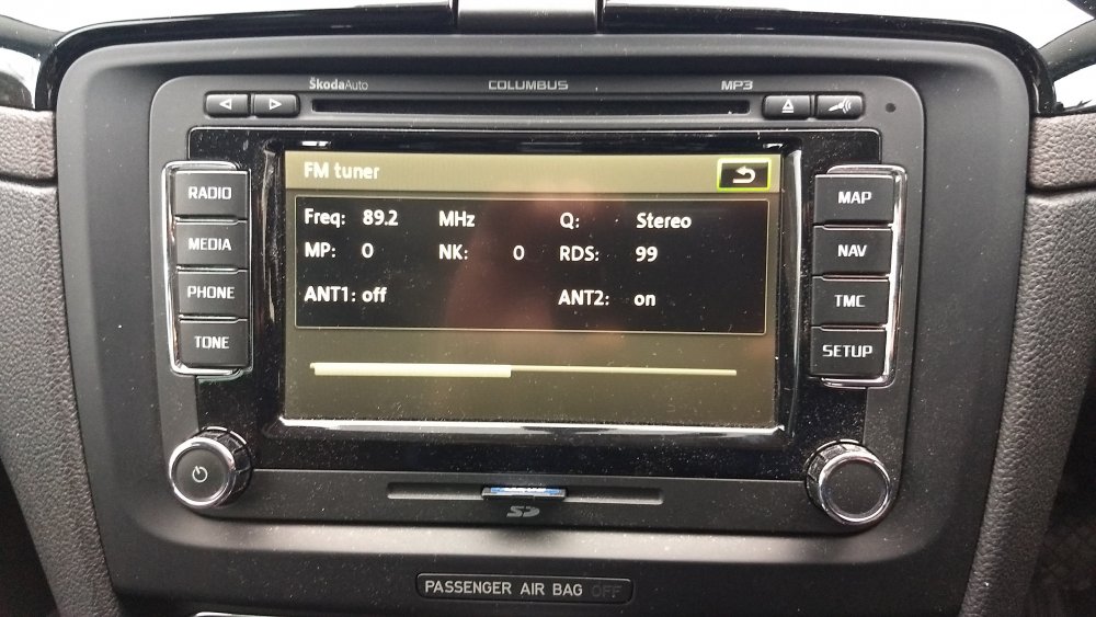

why would this be the case and how do I turn it on?
I have disconnected nothing.IMG_20190124sm.thumb.jpg.3f198c22e5f22bc5c48f39f7fc1ff378.jpg

Is this a new issue?
What age is your superb?
Is this the original headunit, if not, what was?
Do you have an antenna on the roof?
From a cursory google, I found one possibly related result (one ant on, one ant off) here but I'm not sure if the Superb ever had an external diversity box : https://www.mytreg.com/index.php?/topic/8392-required-aerial-mod-for-rns510-retrofit-to-t1/
Depending on your answers above, it might be that one of you antennas or wires has a fault.. :/
@Rustynuts might have some other ideas.
Possibilities are either a faulty roof antenna, a faulty side window antenna (depending on which are actually fitted to the superb) or a faulty radio board in the Columbus.
2016 L&k estate
all original equipment
The tv reception has got worse lately which is why I was scanning around.
Yes sharkfin aerial on the roof.
I will have a look at previouse vcds scans and see if the aerials are reported in a full scan. I may as well do a full scan too.
