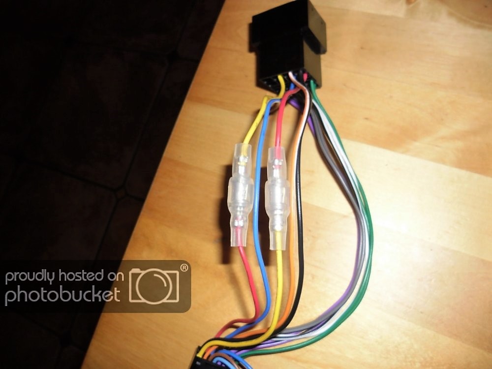

Also, VAG radio wiring is the other way around, so you need to swap the red and yellow feed wires when fitting aftermarket units.
Edited by TMB
