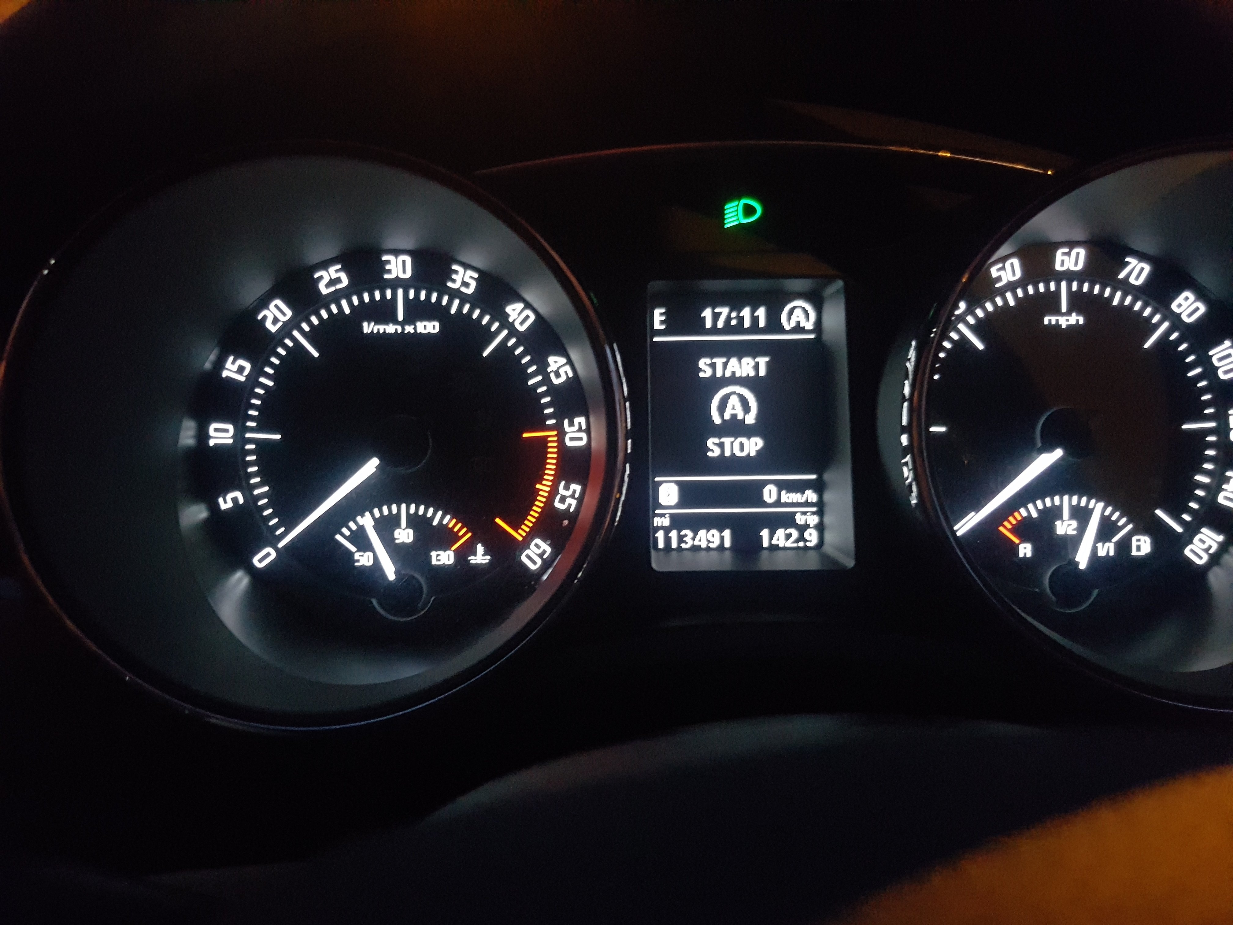

A few months ago I had my Cam belt and water pump replaced [ 5 years old and 110,000 mile 2.0 170 BHP Diesel].
Shortly afterwards when driving after sometime [motorway at 70] the water temperature gauge dropped form its normal 90 to nearer 50 and remained there for sometime. When I checked the oil temperature it also had fallen to 60+. The next day the car would not warm up at all even, after 50 miles the gauge barely moved above 60+.
I took the car back to the main dealer, who after a few days said there was nothing wrong and the car warmed up as normal. This was the case for a few days after which the problem returned, after driving 140+ miles suddenly the temperature dropped and remained between 50 and 60. Back to the Garage where they decided the thermostat was faulty and replaced it [at my cost]. Picked the car back up and after another long drive the problem returned and the gauge fell to about 60 and stayed there. The following day it took almost 100 miles of motorway driving [70] to reach temperature.
The garage have no idea what is wrong, can anyone offer any possible causes and solutions?
To "Lawlesstce" - If the Car is with automatic transmision ("DSG"), there is two thermostats and you need to change the "DSG"-thermostat.
It is a DSG auto, thanks and back to the garage tomorrow
