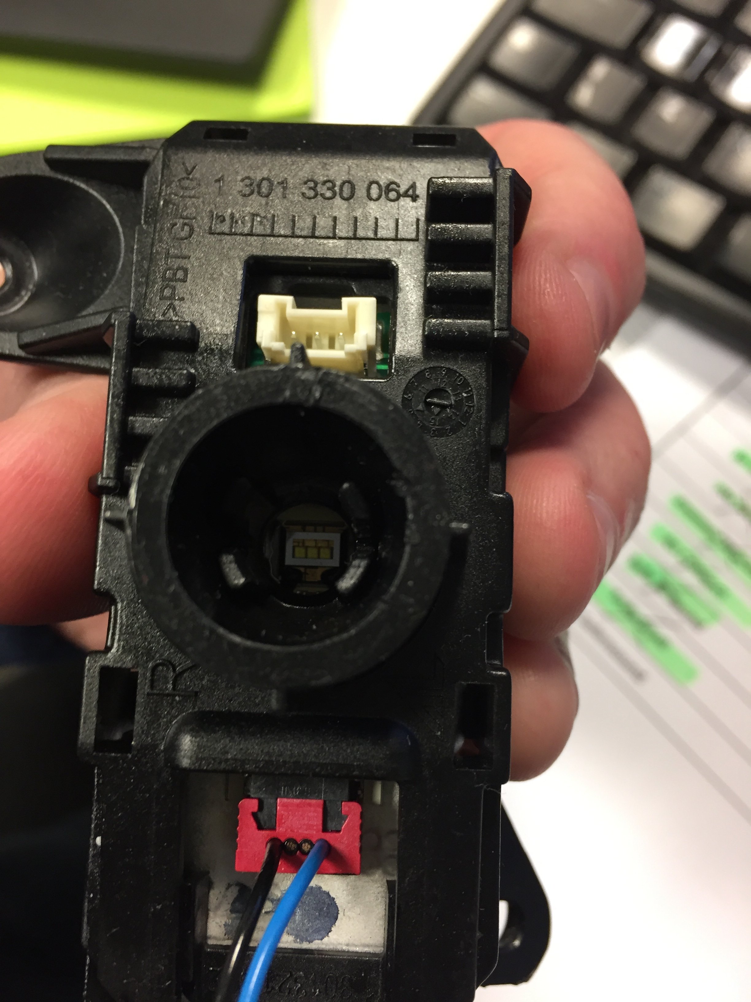

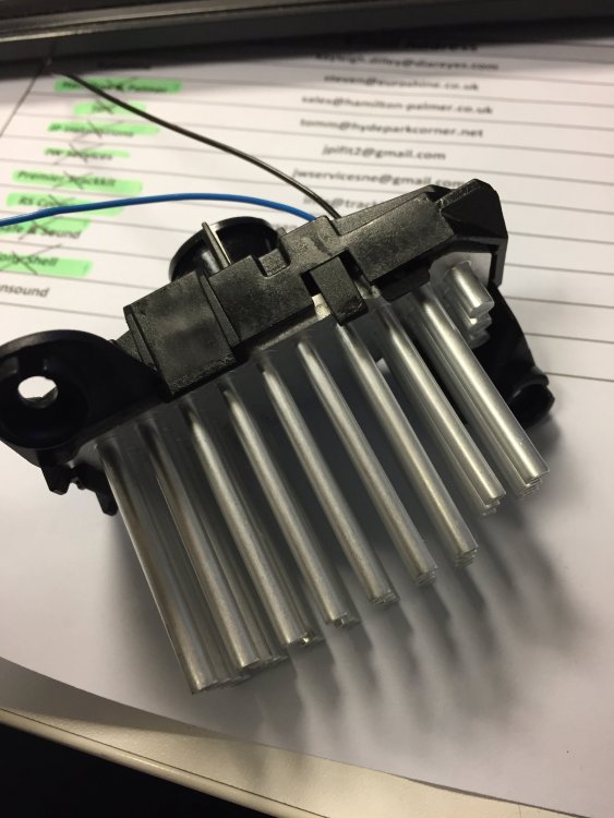

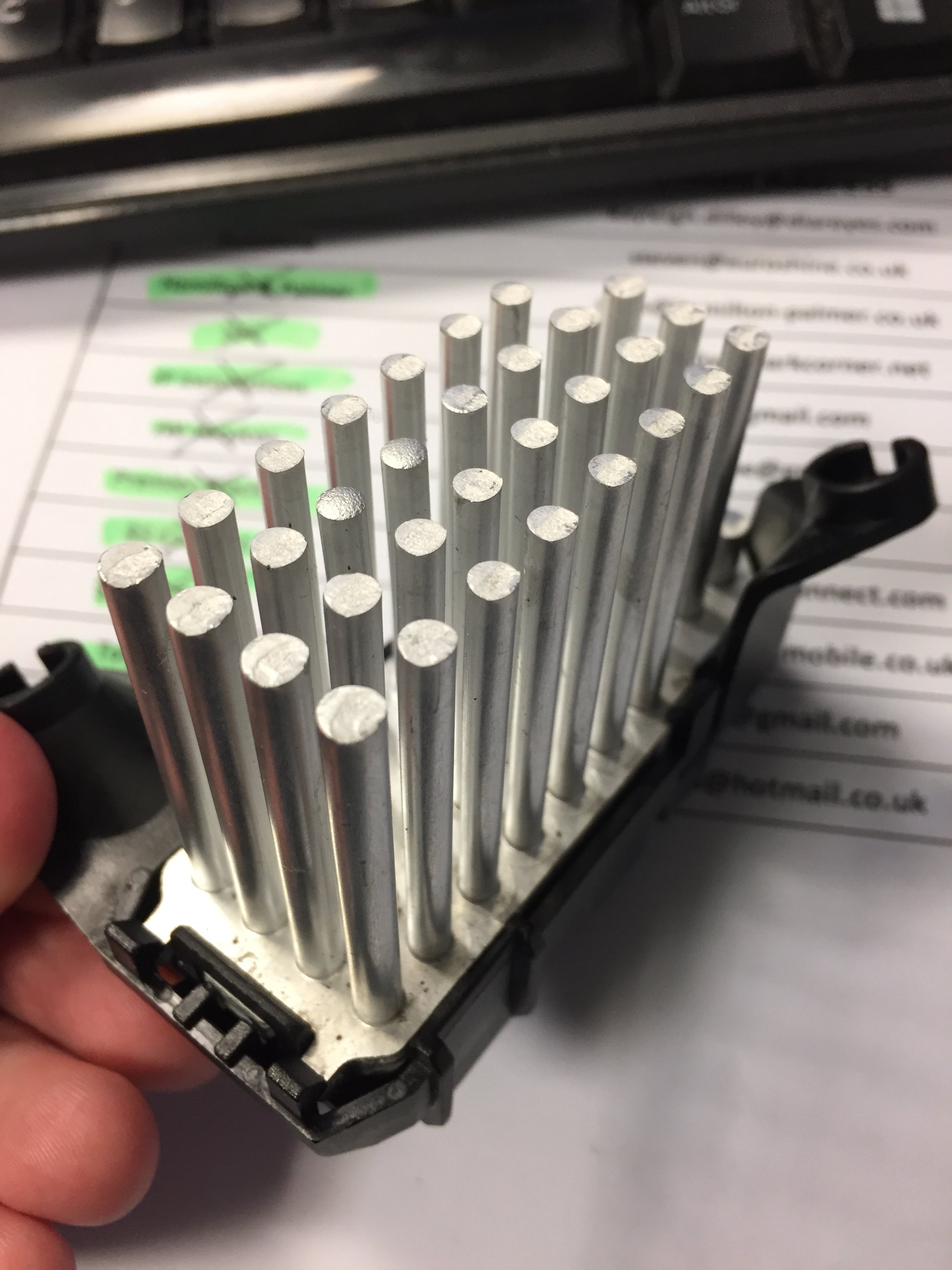

One of mine packed up too, but the full unit was £750 from Skoda or approx £300 off eBay 2nd hand.
I didn’t really fancy either of those, so I bought an knackered headlight (broken lugs, cracked case and lens etc) off eBay for £40, and then removed the LED part (see picture), to put into my existing headlight.
It takes some doing, as it’s a sealed unit, and I had to use a heat gun to warm up the butyl that seals the light, and then use a knife to cut the butyl, and wedges to prize the light apart, and also the bumper and inner arches need to come off, but it was the cheapest option and I like a challenge!
Fair play to you that's fierce going! What are the job of all the rods on the piece?
I think the hedgehogy looking part of it is a heat sink.
