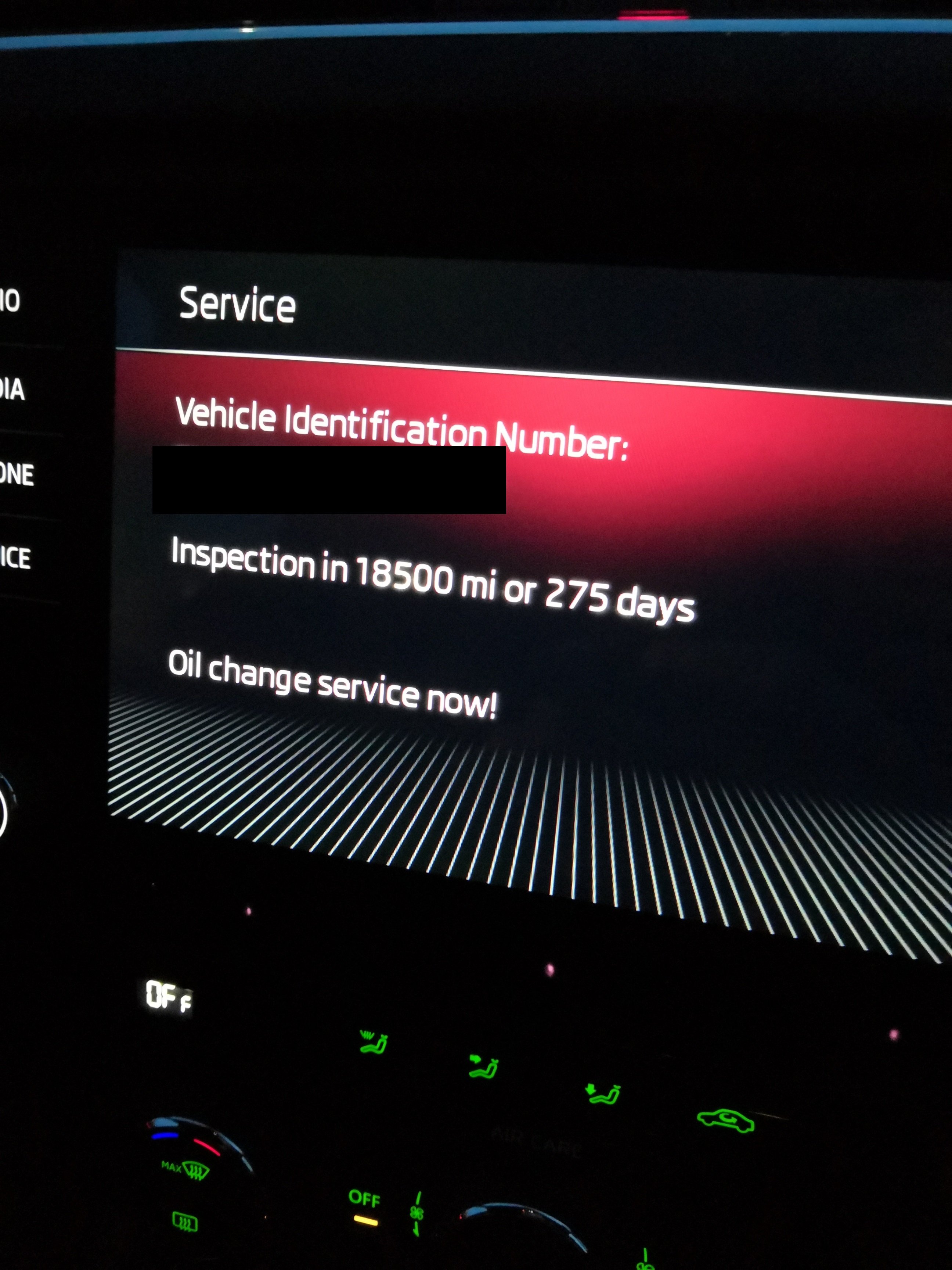

On Saturday I bought my new car, a 67 plate FL Octavia from a national dealership chain (not Skoda specific). When test driving the car below warning showed on the dash. The salesman assured me that the vehicle had been serviced and that the car had not been updated to show this. He would arrange for my local dealership to update the car and all was fine. I was obviously very sceptical but took him on his word. I tried to check for a service book and proof but one was not included with the car. I was told this is due to all Skoda servicing being kept online instead. He was meant to get back to me this week with an update but has yet to respond to my calls and emails.

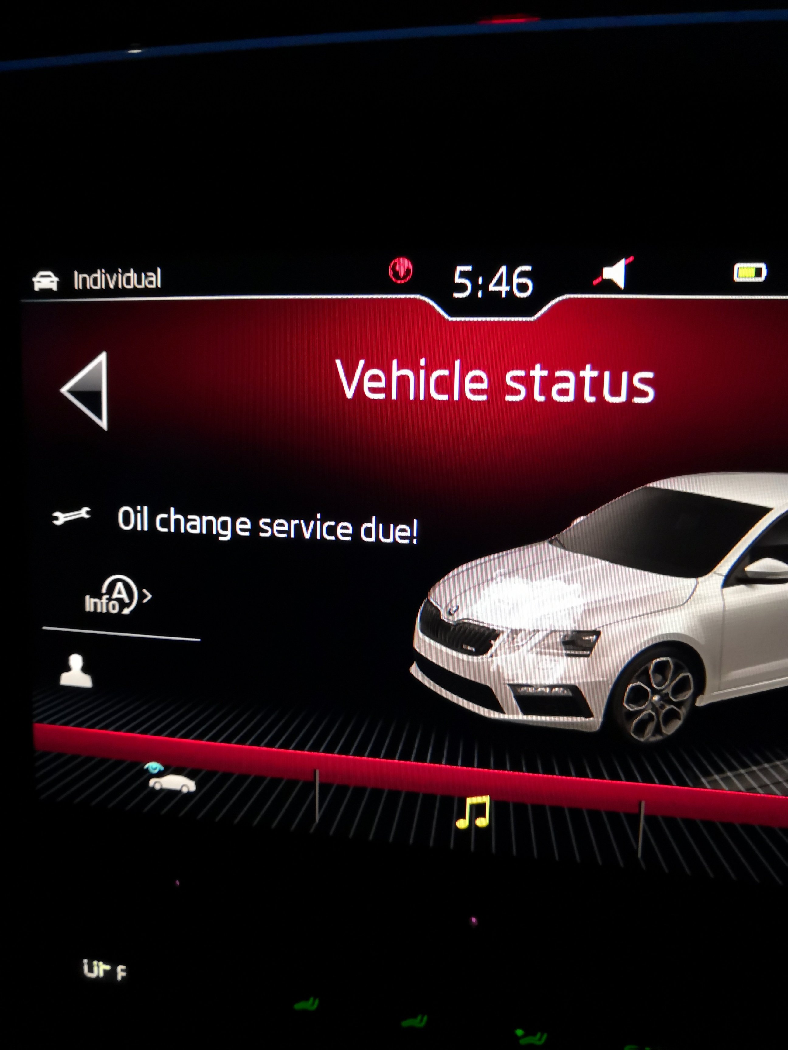

While I wait for him to get back to me I thought I'd ask here if this seems feasible. Can a service really be carried out without the car being "updated". I didn't find the below screens in the car until I got home. One of the screens is contradictory as it says a service is not due but an oil service is. Their is a branch of this dealership near me (although a Citroen dealership) so I can go there to get some answers and I have a local lookers skoda dealership if I need them to give the car a once over.
Any advice at this point is welcome.
The fact that the inspection mileage is showing 18,500, which is nearly as high as it goes would imply someone has tried to reset something recently but hasn't managed to do it properly (as fully reset the days would be nearer 2 years to match) or to include the oil change counter - there are 2 different service timers and this potentially is confusing to someone not experienced with the cars.

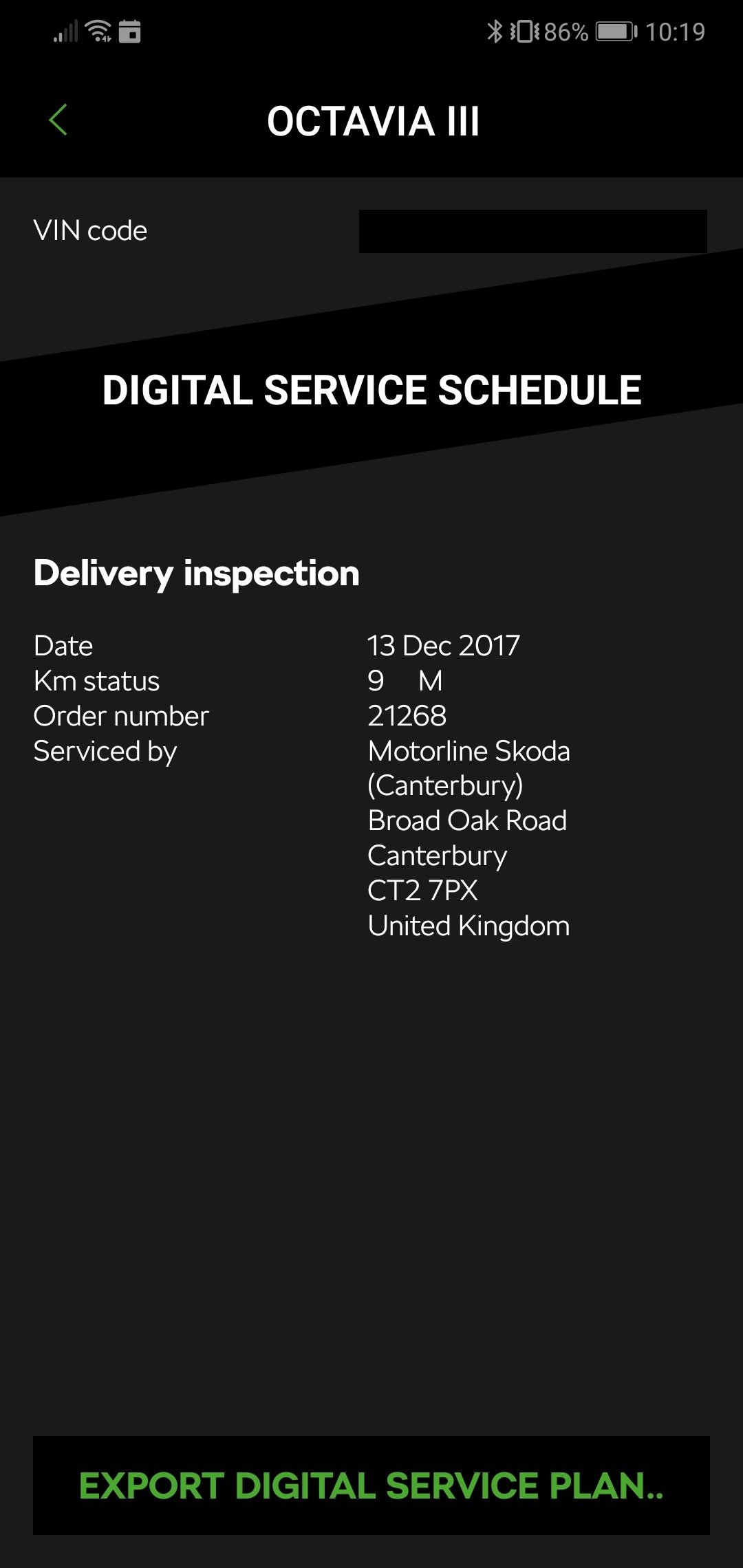

I used the myskoda app and put my VIN in and the only details it has for a service is the delivery inspection (see screenshot from phone). I'll keep chasing the dealership to get confirmation it has carried out otherwise they can do it at the dealership local to me.
I don't get the option for a digital service book in my mySkoda app?
This is the first time I have used the app, it's on an Android phone if that makes any difference.

Turn ignition off and wait for 20 seconds, hold down trip reset button turn ignition on - 1st display is oil change, keep hold of it second display is inspection service. Depending on the one you want to reset, let go of the button and then press it again.
When I got my car from a Skoda dealer, I had the same thing and doing the above reset the oil service message.

Is the major service not the "inspection" that is shown on the screenshot in my first post? That states it's 275 days away which would be about 2 years from new.
