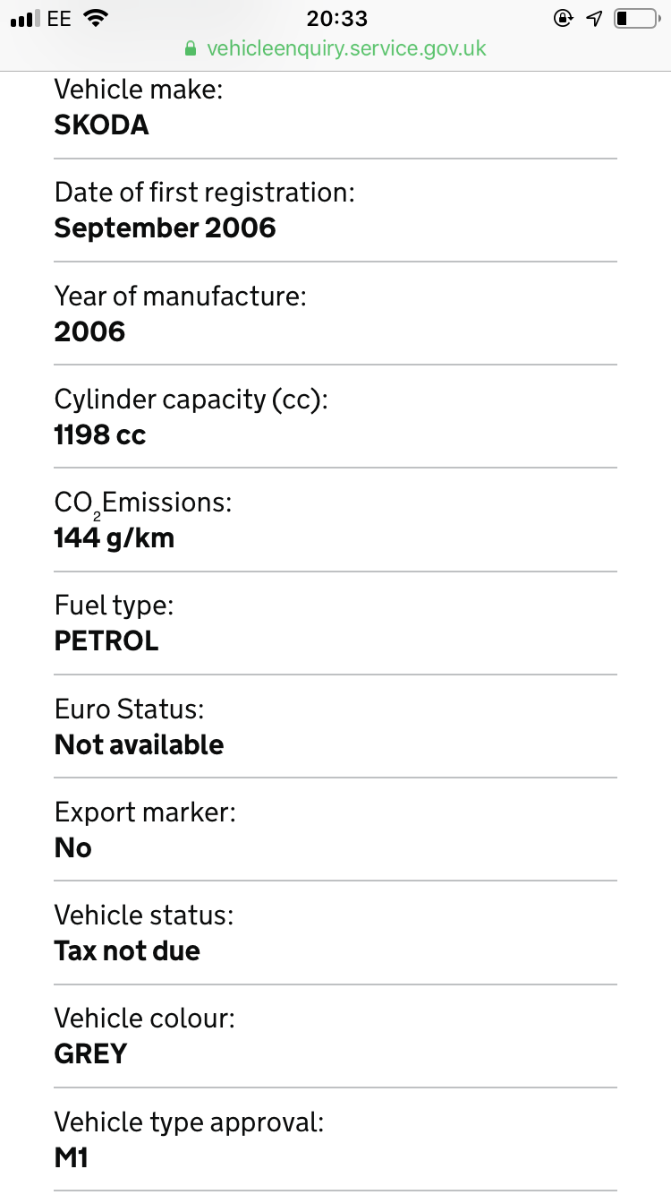

Hi Sepulchrave and Wino - I may be confused about the make/model. It does say its ‘Vehicle type approval’ is M1 - it’s a Skoda Fabia 06 plate.
I am attaching the details in a screenshot if that helps.

It's a 1.2, let's hope it not the 6V with burnt out exhaust valves, they light the CEL.

I think the CO2 figure suggests 12V. Is the 'p' of the HTP on the back red, Sophie?
