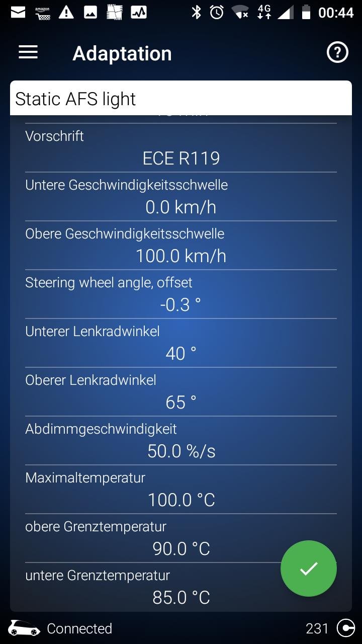

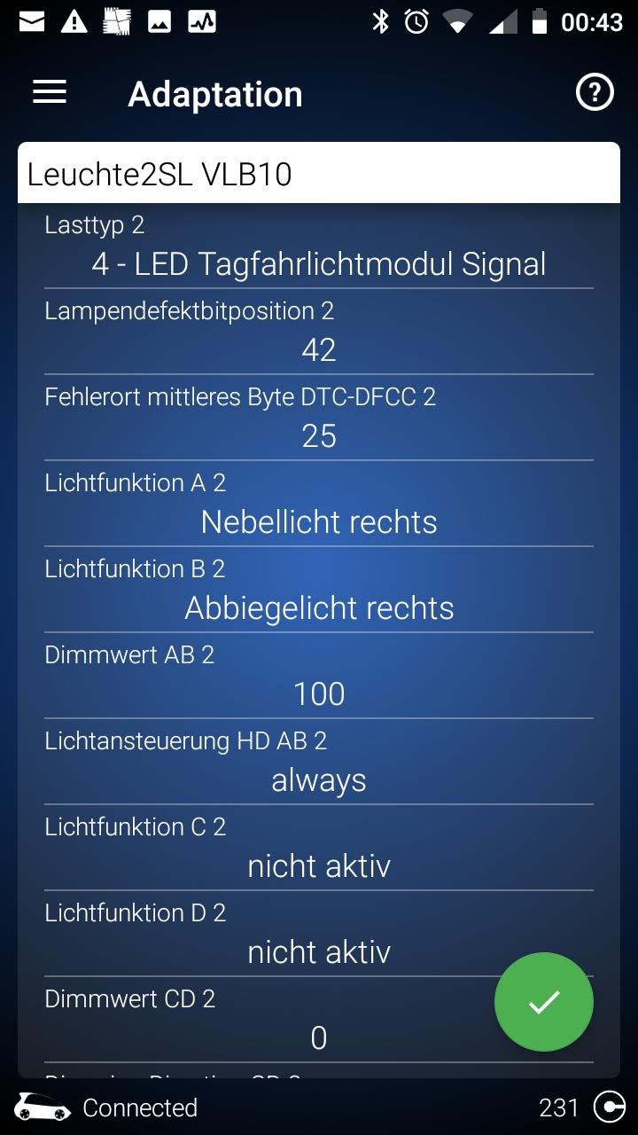

OBDEleven screenshots for you, works on my MY17 VRS245 I upped the speed threshold a little as well, good luck!
Ooooh, that looks different, will give that a go tomorrow and report back, thanks @vfrguy
Will be waiting ;)
10 hours ago, ExSEAT said:
Will be waiting ;)
@vfrguy You sir are a star! All working and correct, one very happy man here! Thank you sooo much! @ExSEAT We have the answer.

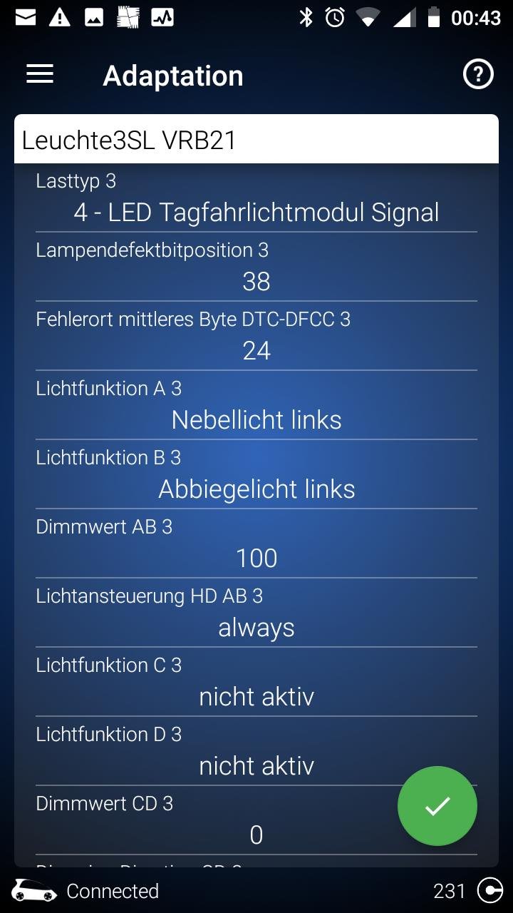

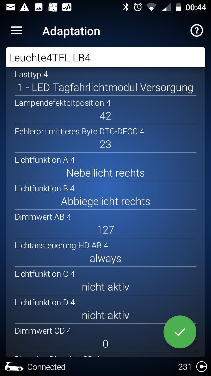

@vfrguy Don't suppose you know the settings for the second rear fog light (Near side) on the 18MY car also???
Edited by Maggle
Have look here (third of the way down)
Basically, the LHS has blank values, you just need to copy the ones for the RHS over :)
Yep, I've been looking at my admap and noticed that I hadn't changed lasttyp26 to 32 - allgemeine LED bis 12W so I reckon that's the final hurdle to overcome. Will try later and report back. Thanks @Cakemonster

@vfrguy Thanks for the screen shots, Its a much easier way to follow the changes! Ive left mine at 40km/h for now but might up it in the future

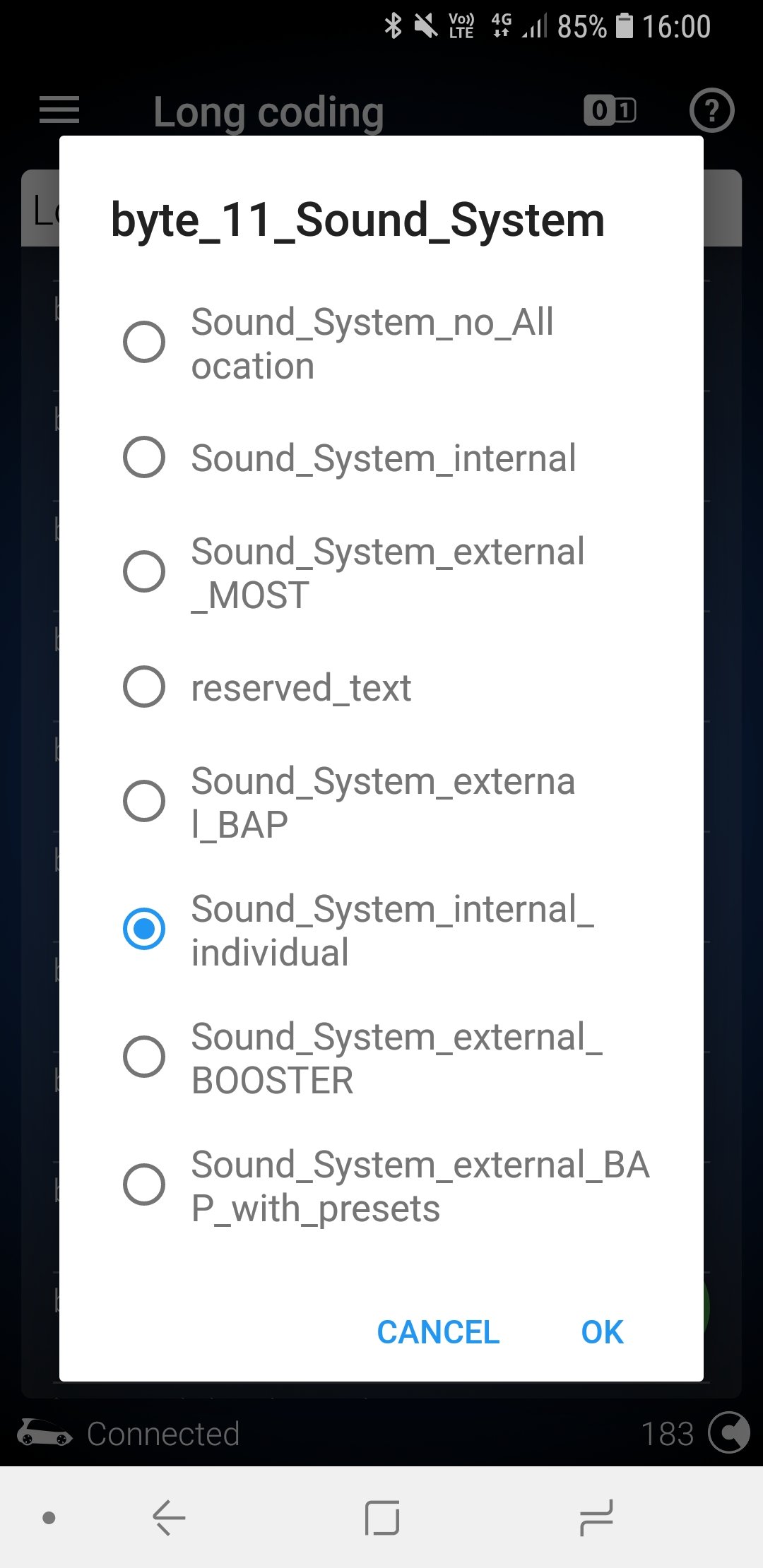

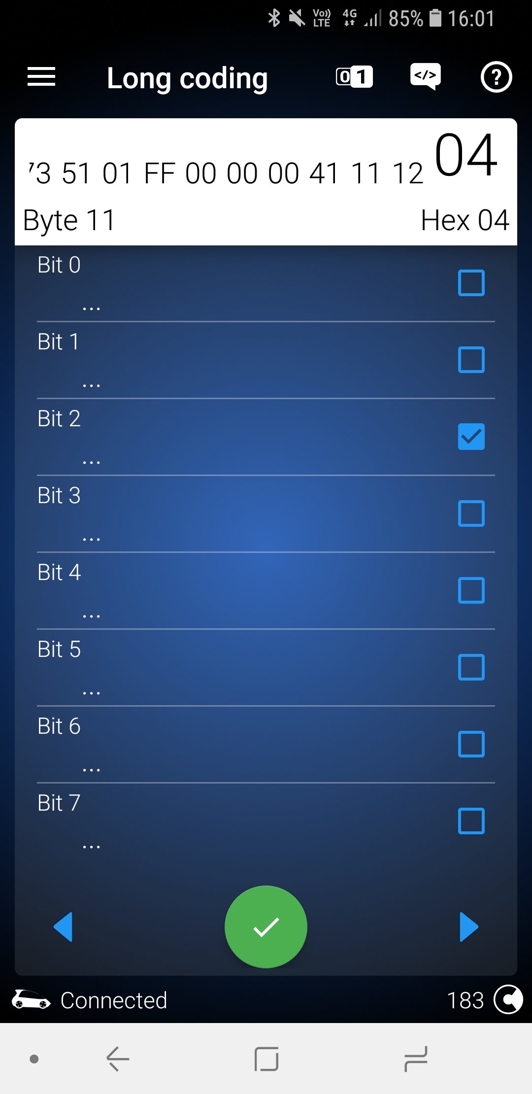

The virtual surround thing, I tried doing it on mine without success. So, is it only applicable to certain infotainment units (mine Amunsden on a 18MY car) and do you have instructions or screenshots that could help me with this please?

My only problem is know for each MY car which channels are to be used, if someone was able to write a guide it'd be great. For instance the instructions on the sticky here for cornering fogs talk about making changes to Leuchte 26 and 27, but actually for my car it has to be Leuchte 2,3,4 and 5 or something like that. How to know.

The Skoda Surround Coding should work on all cars, some people with MIB2 Columbus are reporting that it’s not working, but the MIB2.5 Amundsen and Columbus have both been successful. My MIB2.5 Columbus is running it perfectly.

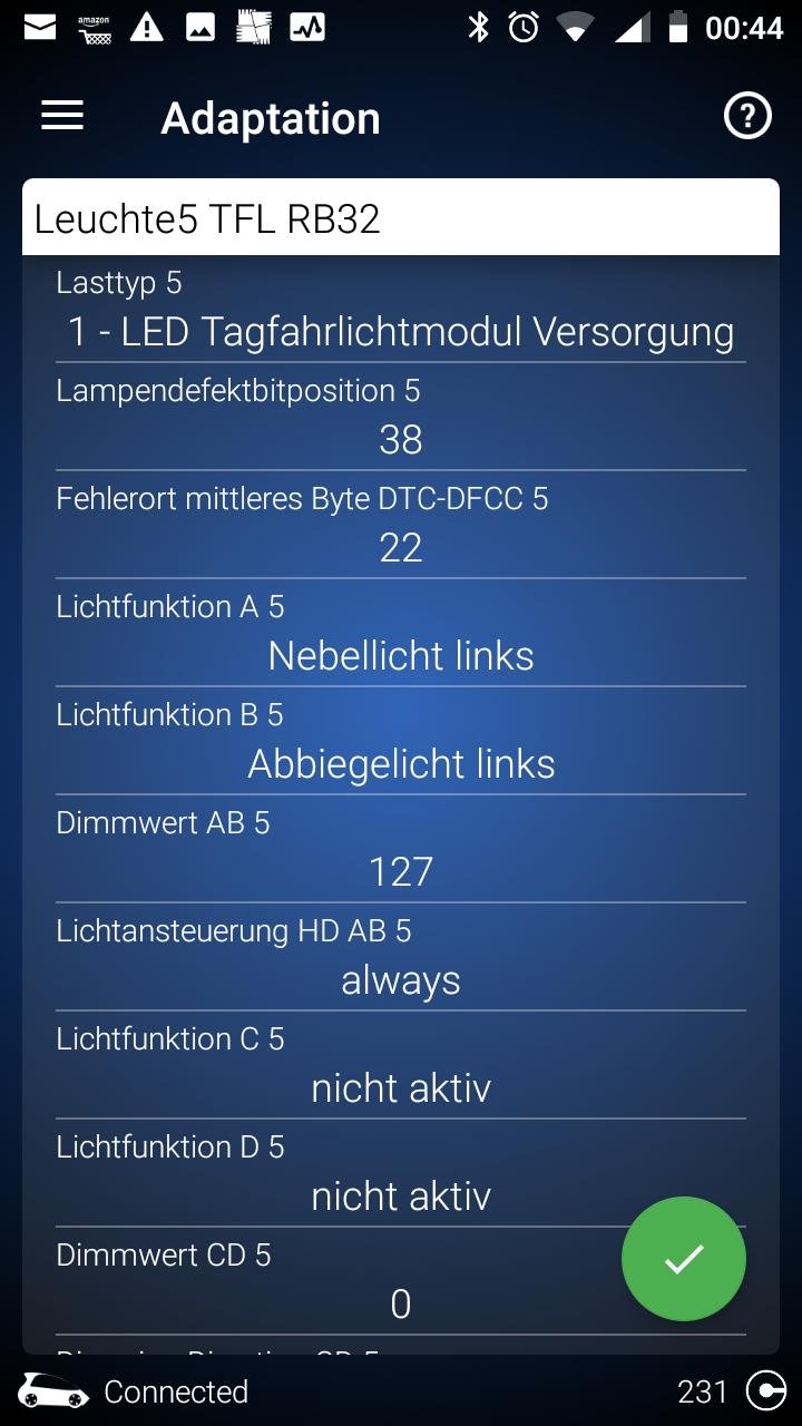

@Maggle in fact ignore the post above, its incorrect!! Just had a look at the car and this is the setup instead...
