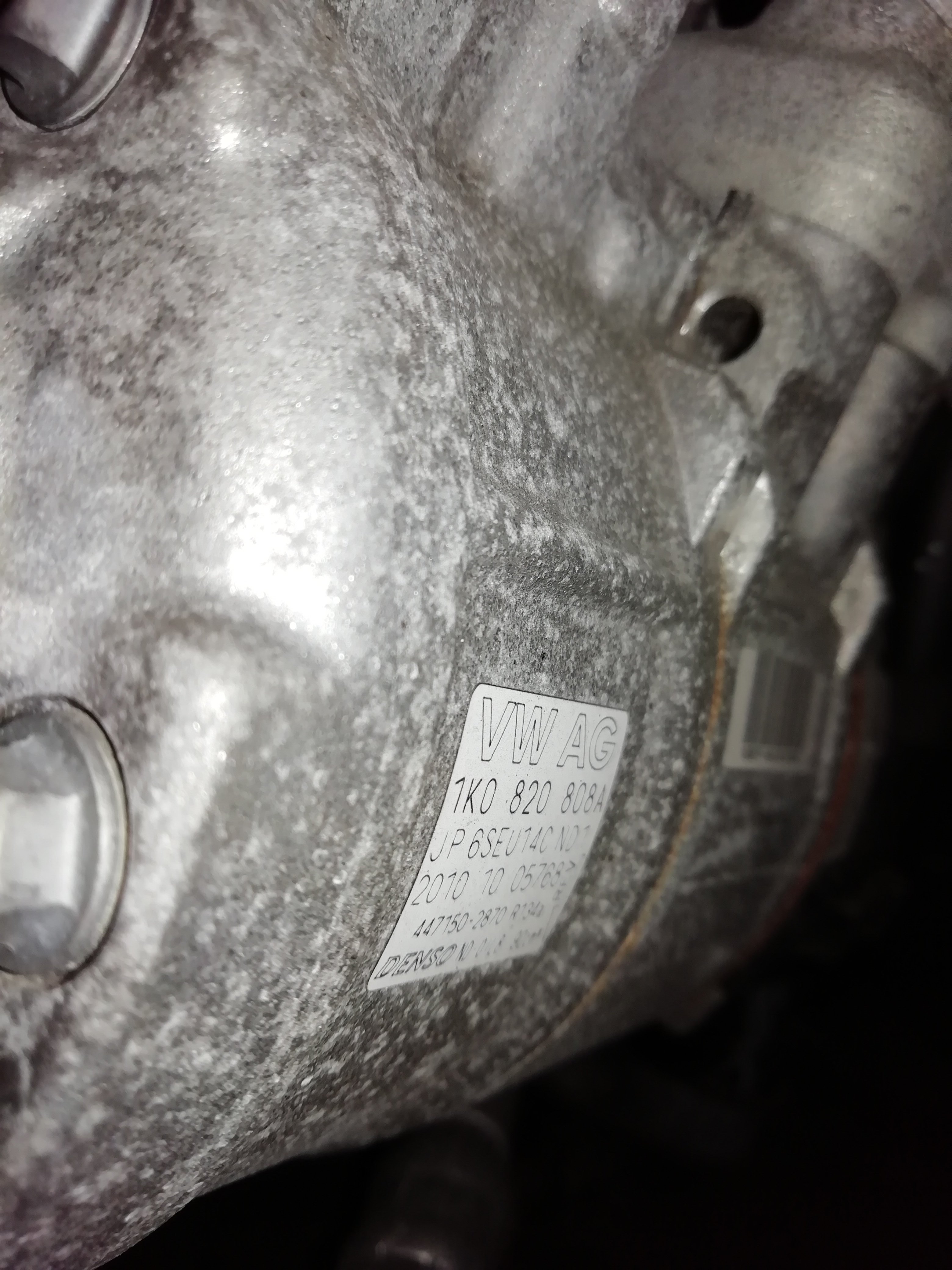

Thanks for advice;
My local inde garage have been checking VIN with ECP but cannot confirm match so risk is with me if I supply as you say.
The ECP fitment details includes
Compressor ID 6SEU14C
and VIN From 1Z-4-000 001
and my VIN has 1Z5 in it and my part has 1KO 820 808A and 6SEU14C written on it so it should match imo.
AC was tested in 2017 and compressor was not keeping charge after regass so replacement was advised back then.
I only do short trips so I have lived with invonvenience but want it fixed now.
Getting car serviced tomorrow so will talk to garage about it.
Edited by GreyTSI
Added photo

To get from the full VIN, to the format you show from ECP (and what you'll see on ETKA lists), you need to replace the 9th and 11th characters of the full VIN with dashes. Then compare what remains.   Tenth character, in between the dashes, is model year, so yours will definitely be higher than 4 as from 2010 they went to letters, A for MY2010, then 2011=B, etc.
For your engine (CCZA code?) It should be the same part number as suggested above by TheClient, according to lists shown here: https://skoda.7zap.com/en/cz/octavia/oct/2011-663/2/260-260010/  If your engine code is different, just look at the relevant lines where your engine code does appear.
Edited by Wino
Part number is surprisingly easy to read with a poundshop mirror on a stick, the part number is in large bold font on a contrasting background.

I see you managed to photograph it after my last post, including getting a match with the 6SEU14C
