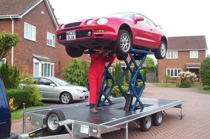

@Wino how about this?  A man of many talents like yourself could knock one up in an afternoon :biggrin:
  • Sponsor
Hehe, I appreciate the confidence, but there's no way I'd stand underneath anything that looked like that if I'd made it myself!
