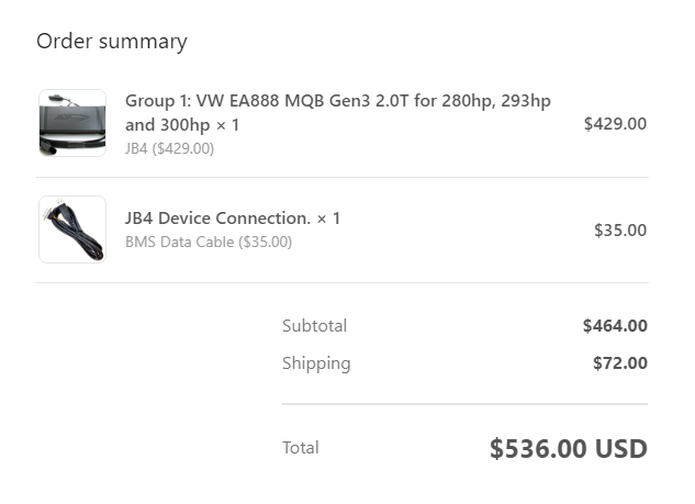

Just placed my order 1hr ago...
...before even picking the car up :D
I've had the JB4 on the same engine for 1.5 years and couldn't fault it. Performance was practically on par with a stage 1 map and the support was great. JB4 has a number of features that place it higher than the rest of the tuning boxes imo, most important being the AFR monitoring and ability to bias fueling as needed, not just blindly adding boost. There's also stuff like boost by gear and rpm, the very handy logging and custom mode (with BMS support) for those that like/want to mess with their settings till they find the absolute sweet spot. For me, it's the only box I would consider over a remap.
I will be measuring (and reporting on) 0-60 and 60-120 times stock vs JB4 once I get to put some miles on the car so keep an eye for them.

I won't get the BT module as I find it way too expensive for what it is. You have the exact same access and adjustability/logging options with slightly less comfort if you opt for the data cable shown above,  a USB OTG adapter and the JB4 Mobile app. Cost of all those is not more than 50$ and I have purchased the app already for my previous JB4 unit. The only difference is that you connect to your phone physically, by running the extra cable through the firewall (same as you have to do for the OBD cable anyway) but I keep the phone down there in the cubby anyway when I'm using the app to log or fine tune.

Incidentally, an hour ago FedEx tried to deliver it to me but no one was at home so they left a notification. I mean I placed the order Sunday night, chose Express shipping as it was just 17$ more on a 550$ total and it took just 2.5 working days to arrive from California to my door in Sweden :o:o  That's unbelievably fast!  Another reason to buy directly from the manufacturer.
