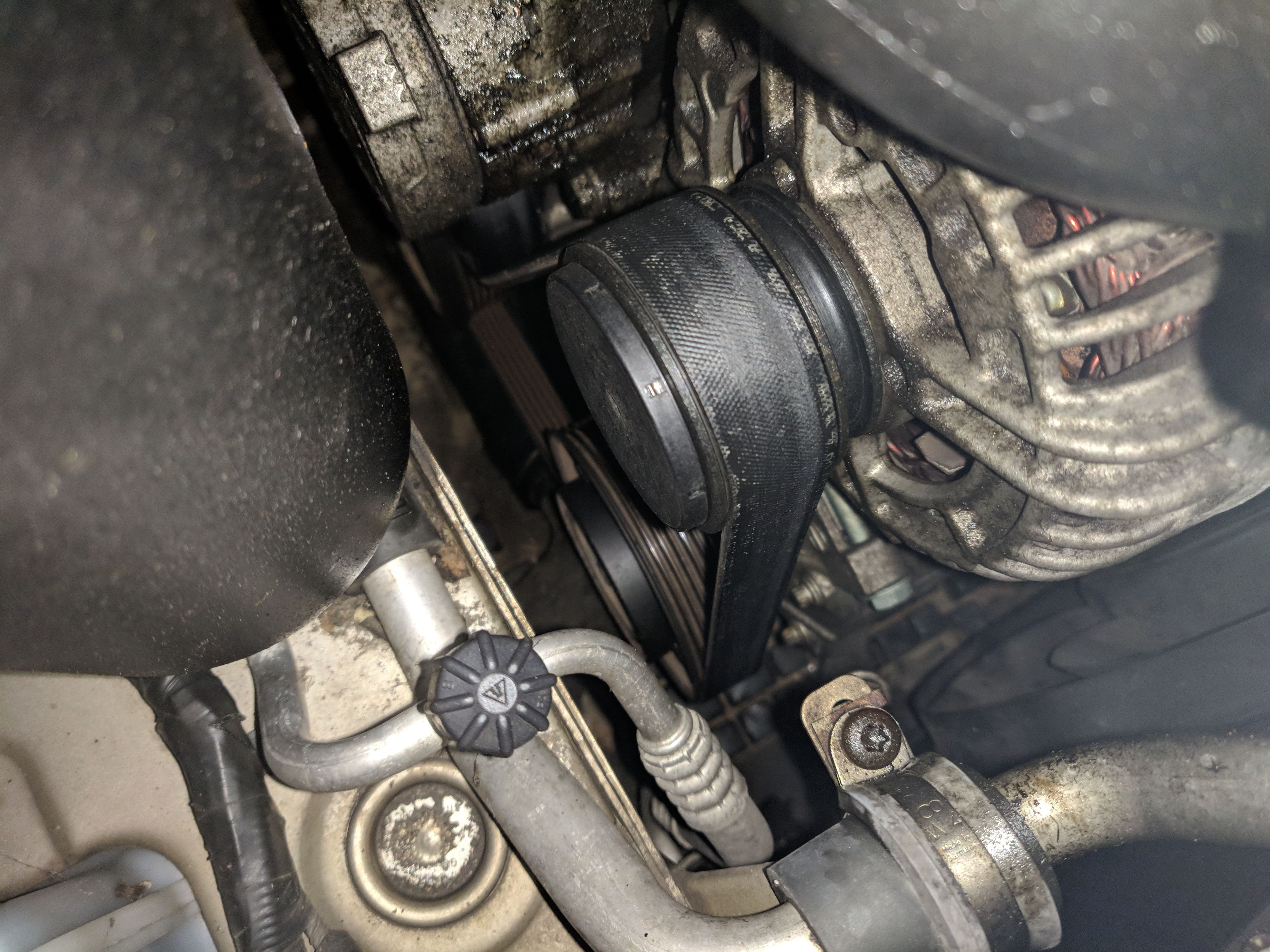

2005 Octavia has just started making a weird noise. The exact same noise our Kia Sorento has just started making funnily enough.
Sounds like something being tightened a bit too much and creaking/clicking. Not constant, but fairly regularly every few seconds or so. The kind of sound like when you would wind up a wind up toy or something and you wind it up past the limit?
Looks like it is coming from the alternator area, like with our Kia.
Any ideas? We are relying on the Octavia, so it'll need to be sorted asap if it is a big issue.

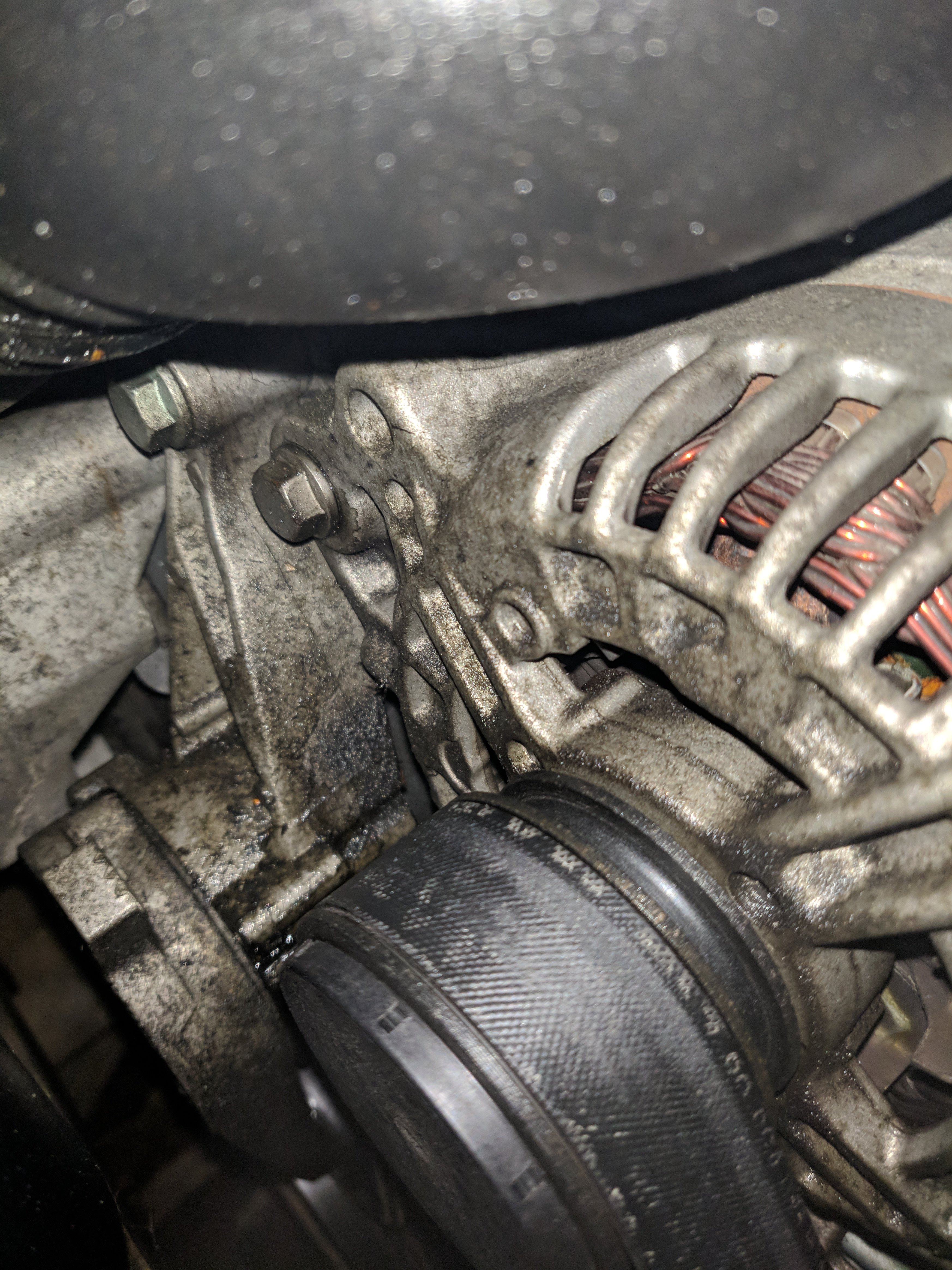

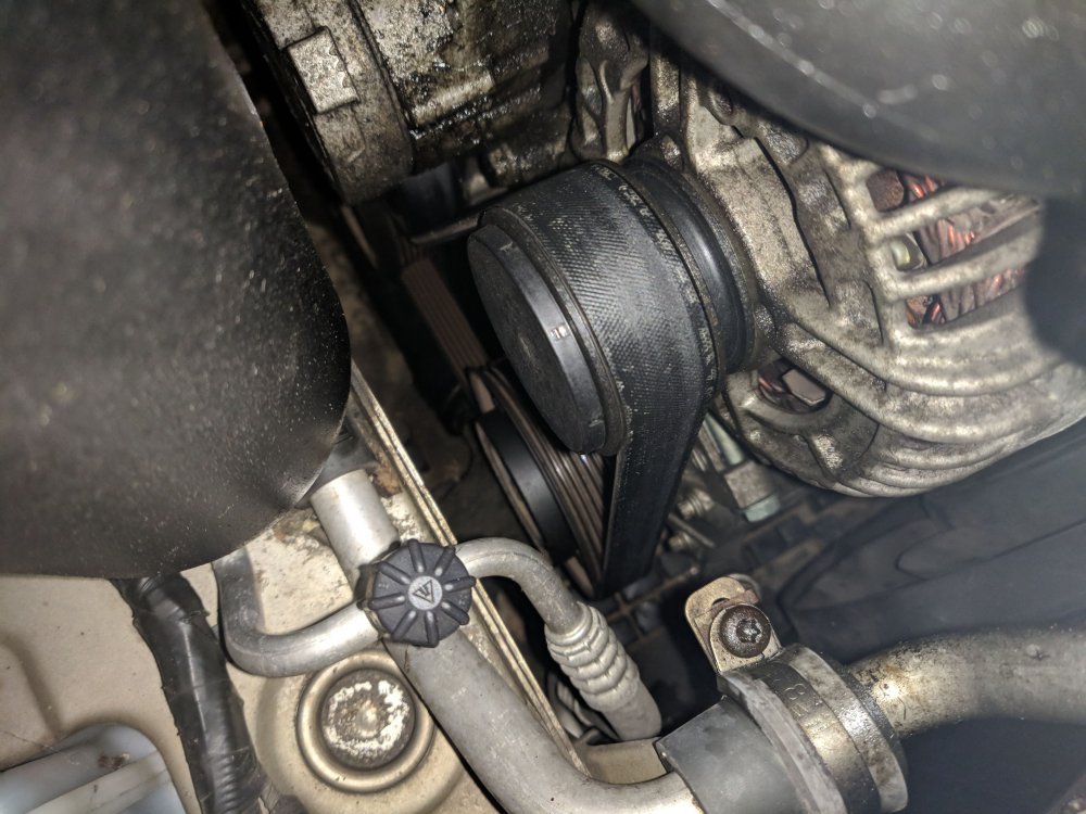

Here are some pictures of the area. Tried to get a video of the sound, but all I got was a hissing sound of that area, like an air leak almost?
Can't upload anywhere near what I wanted to upload due to file size.
There seems to be oil around this area too. Splattered onto the bonnet directly above? Can't really show what I'm trying to show with the picture it is letting me upload. Directly below the alternator there is an oily patch and on the pipe below.
No oil is left on the ground however.

I can't play the clip but I would guess it's road salt that's making the auxiliary belt noisy on the pulleys.
A good hosing of the belt with the engine running should clean it or just give it time to clear itself.
Is that common? It is quite a loud creak when it does it
Just to rule it out, I would check the belt tensioner for wear.
Can I do that whilst it is in situ?
You need to take off the aux belt which will mean taking off the road wheel, wheel liner and under tray to gain access.
Unless you are competent with the spanners, the rest is probably best left to a garage as it requires releasing the tension and locking the tensioner in place.
As your belt looks a bit shiny due to oil or wear, an alternative is to ask a garage to replace the belt and check the tensioner for wear. When was the belt changed last?
Remove belt, run engine and if noise is no longer apparent then its either the belt, tensioner, alternator bearings or clutch if fitted.

I'll check again later, but I think it may be oil on the belt? There seems to be a splatter of oil in that area that has gone onto the bonnet as well. It last had fresh oil in September when it had a new turbo.

A loud clicking might be a dry or collapsing bearing or tensioner.
At 100,000 miles, with no history of a cambelt change, that would be my first priority.
Whilst the belt is off it'll be easier to either diagnose or rule out the source of the clicking.

Isn't that a clutched pulley on that alternator? Won't it be that?
Edited by Wino
Sorry, should've said. The cambelt was last done in 2014 at 36k miles I believe. Nothing since then.
As Wino said it could be a one way pulley as that was used in 1.9 L Mk1 Octavia. A failed alternator pulley will quickly cause the aux belt tensioner to fail too, so both will normally need to be replaced at the same time.
Just give the belt a splash from a cup of water whilst the engine is running, if it's contamination that's making it noisy it'll stop almost immediately and return as the water dries off.

So I've sprayed the pulley + belt with wd40 silicone lubricant spray and the background hissing sound went away immediately. I can't get it to reproduce the weird creaking sound now, but will keep trying. I revved the engine to 2k RPM and shut the engine off. All I got was a sound of air releasing, I assume from the turbo. No odd noises other than that.

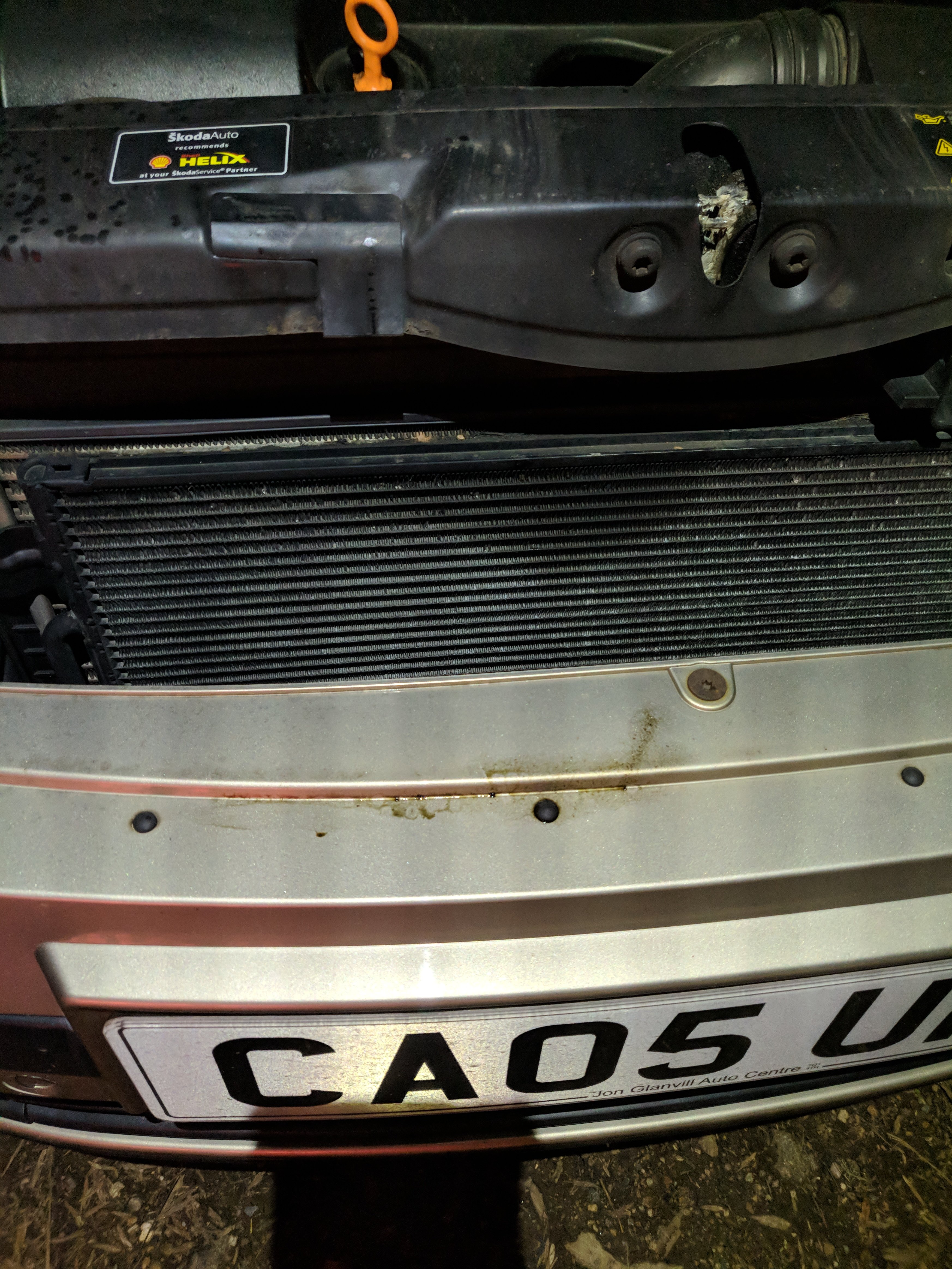

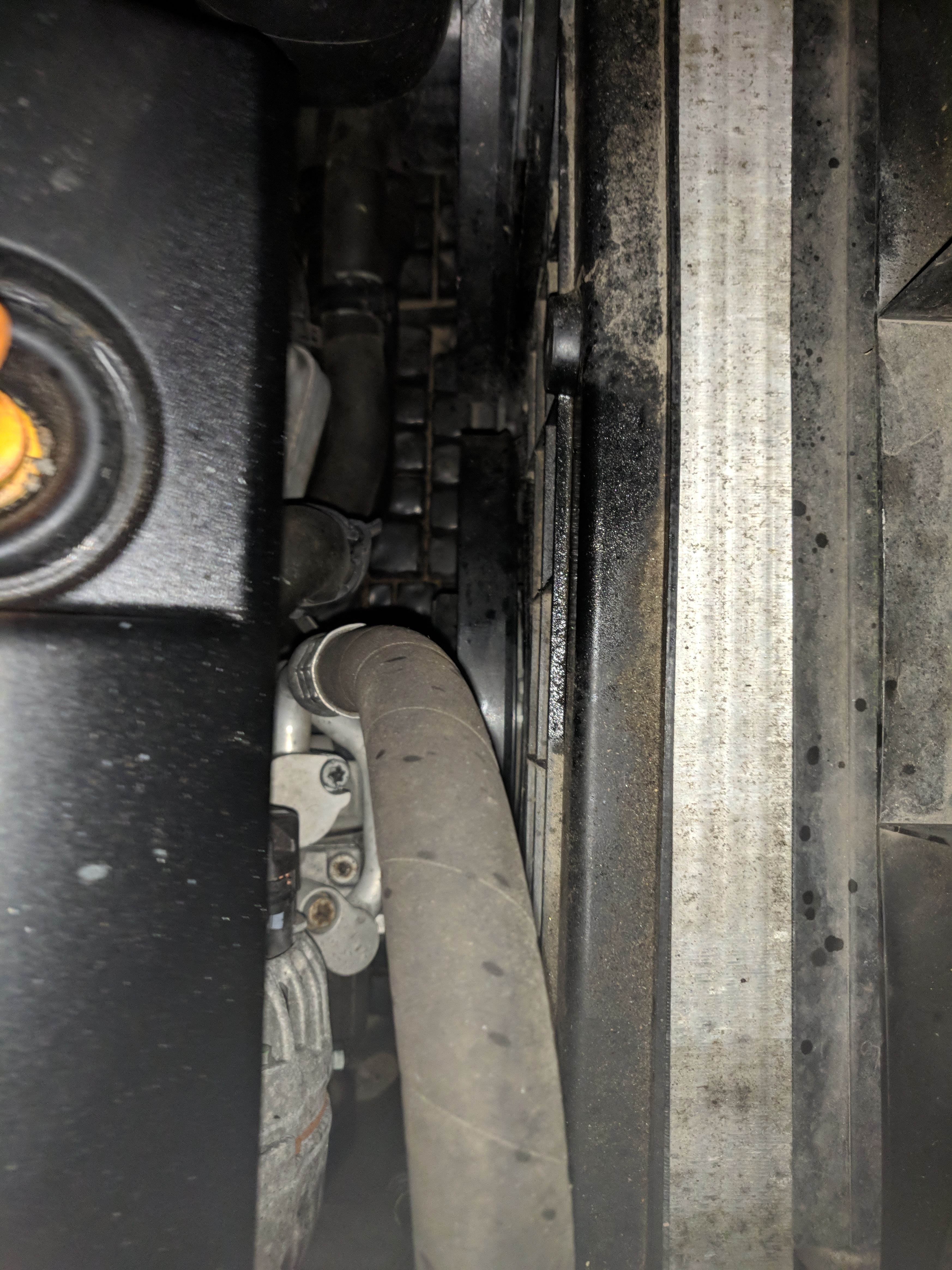

One odd thing is, my radiator has a wet patch on it and behind it and in front of it on the bumper where the bonnet shuts there is a small patch of dark oil. Strange? I'll attach some shots of it lets me, if not I'll try and downgrade the quality and add them.
From the photos you can see the bonnet latch near the radiator has oil on top of it, so does the edge of the engine cover. Could this have been just spilt oil when the garage topped it up when they did an oil change in September?
Also, if the tensioner pulley is the bit that is diagonally backwards from the clutch pulley, then that doesn't have excessive movement, it moves maybe a very small amount each way, when the engine is running.
