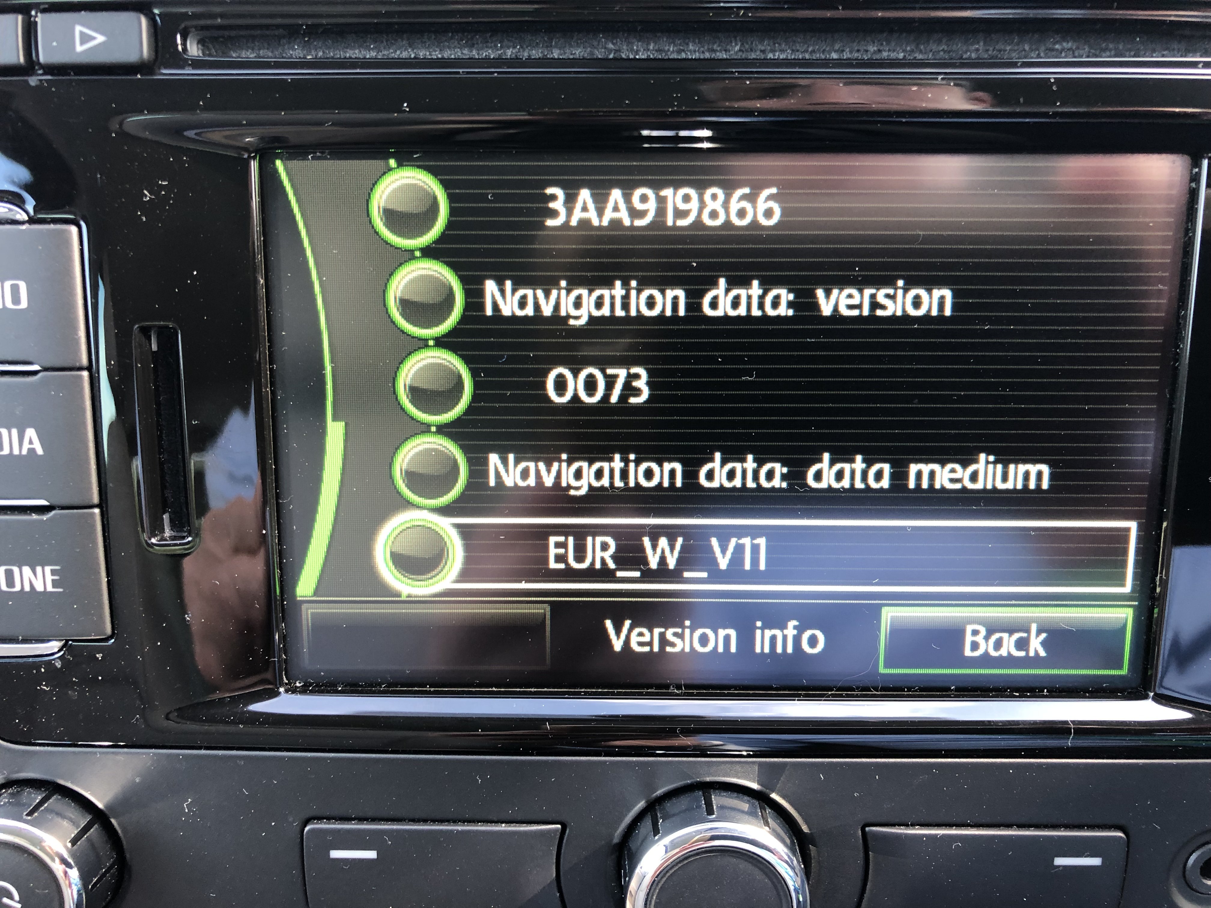

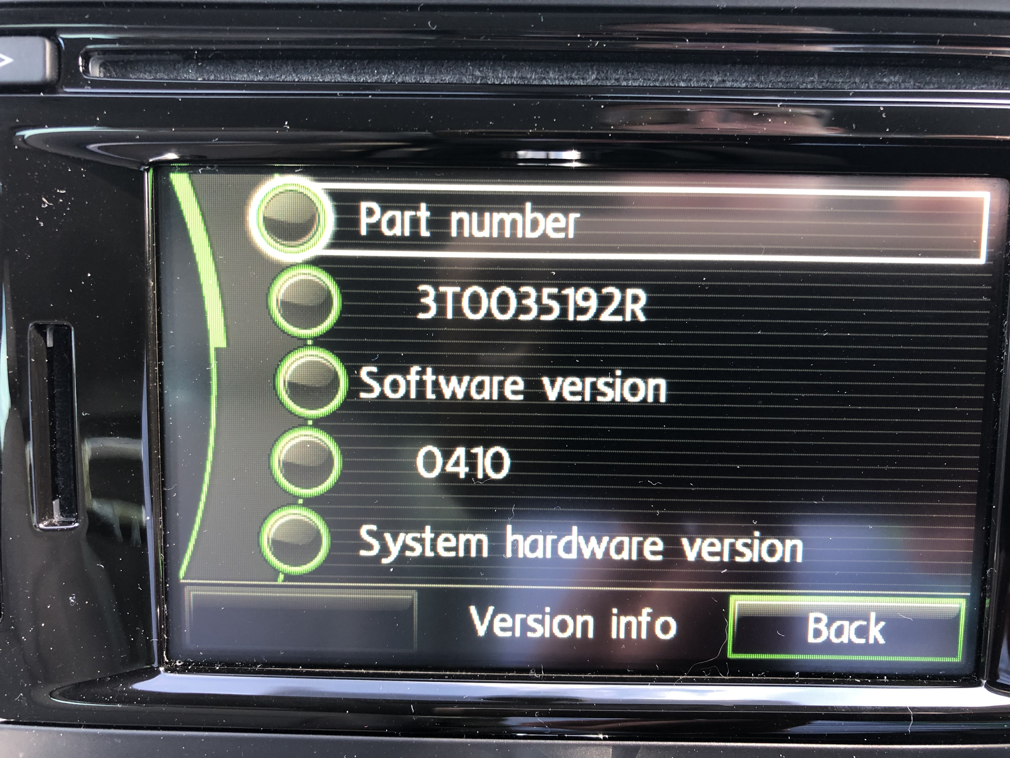

It appears that I have v11 if I have looked in the correct place. Can somebody give me some guidance where I go from here.
Attached are screenshots of the version numbers etc from the screen on my radio.
Edited by DRGW
Yes, you have V11. You'll need to downgrade to V9 for a stable unit again.

9 minutes ago, DRGW said:
They don’t appear to be able to cross reference anything.
Does that surprise you???
Show them the pictures you have here and ask them where it says CW 45/18. Then tell them that the Navigation data version on the maps you've bought from them is  (according to the system details) 0073. The navigation data version for V9 maps is 0069.
Ultimately I think they're just going to bury their heads in the sand on this one and keep on claiming they know nothing. I guess you're going to have to provide a V9 maps copy for yourself. Or you can send me the unit and I'll downgrade the unit for you for free. However, I'll need to retrieve the security code which costs a tenner (unless you already have it), you'll need to join Briskoda Freedom membership which costs £12 for a year, and you'll need to cover postage here and back. Overall, it'd be cheaper to buy a card off Ebay I reckon.
Reading through this long thread on another (GPS) forum shows that there is a definite problem with V10 & V11 Map updates to the RNS315 units with certain versions of firmware in the UK. It apparently causes a random restart every few minutes and is thought to occur when the system receives traffic information updates. Downgrading the map data to V9 fixes the problem. According to posts in that thread 'VW tech' are aware of the problem?

Yeti is now booked in with main dealer for early June. They need it for a couple of days to run tests etc to see what is causing the issue! Despite advising them that v9 is a stable version etc, they still claim not to know anything about this.
Main dealer has had my Yeti for 24 hours and has updated the radio software from 0410 to 0417.
The satnav software is still v11 and I haven’t had any issues at all with the radio resetting.
Fingers crossed this has fixed it.
If it has fixed it then it's the first time I've known it. As you say, fingers crossed.
I think I spoke to soon. Just been out and it has reset again. Doesn’t do it as much though.
As the dealer has updated the radio software itself, would this still need to go back to V9 for the satnav software to cure it once and for all?
Yes,v9 is the fix
