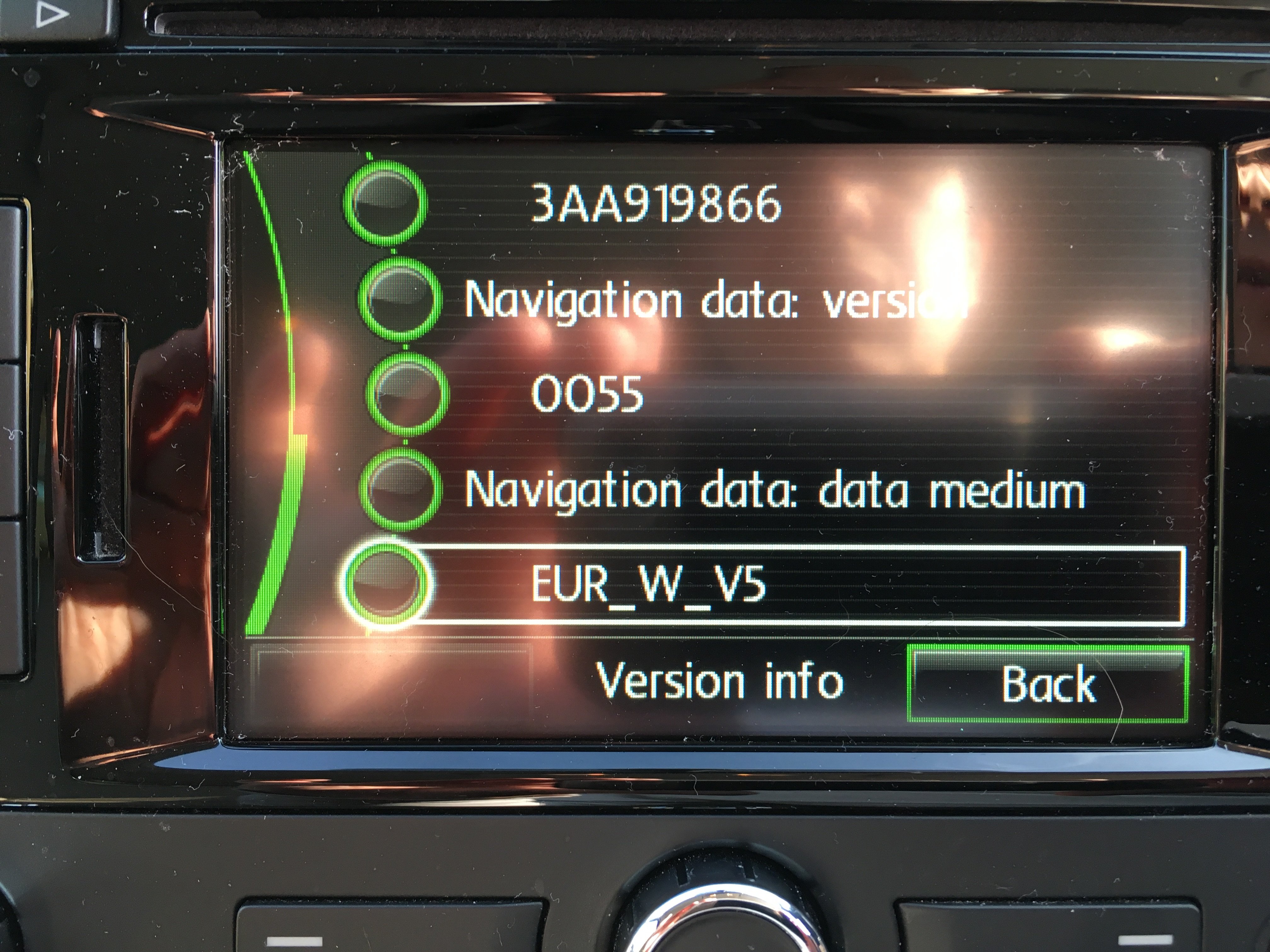

How can I find out what version I have?
1 hour ago, Rustynuts said:
Many thanks.
From the photo, does this mean I’m on version 5? What new features etc will be on the latest version?
That's your maps version, newer versions should be updated with new roads etc.
