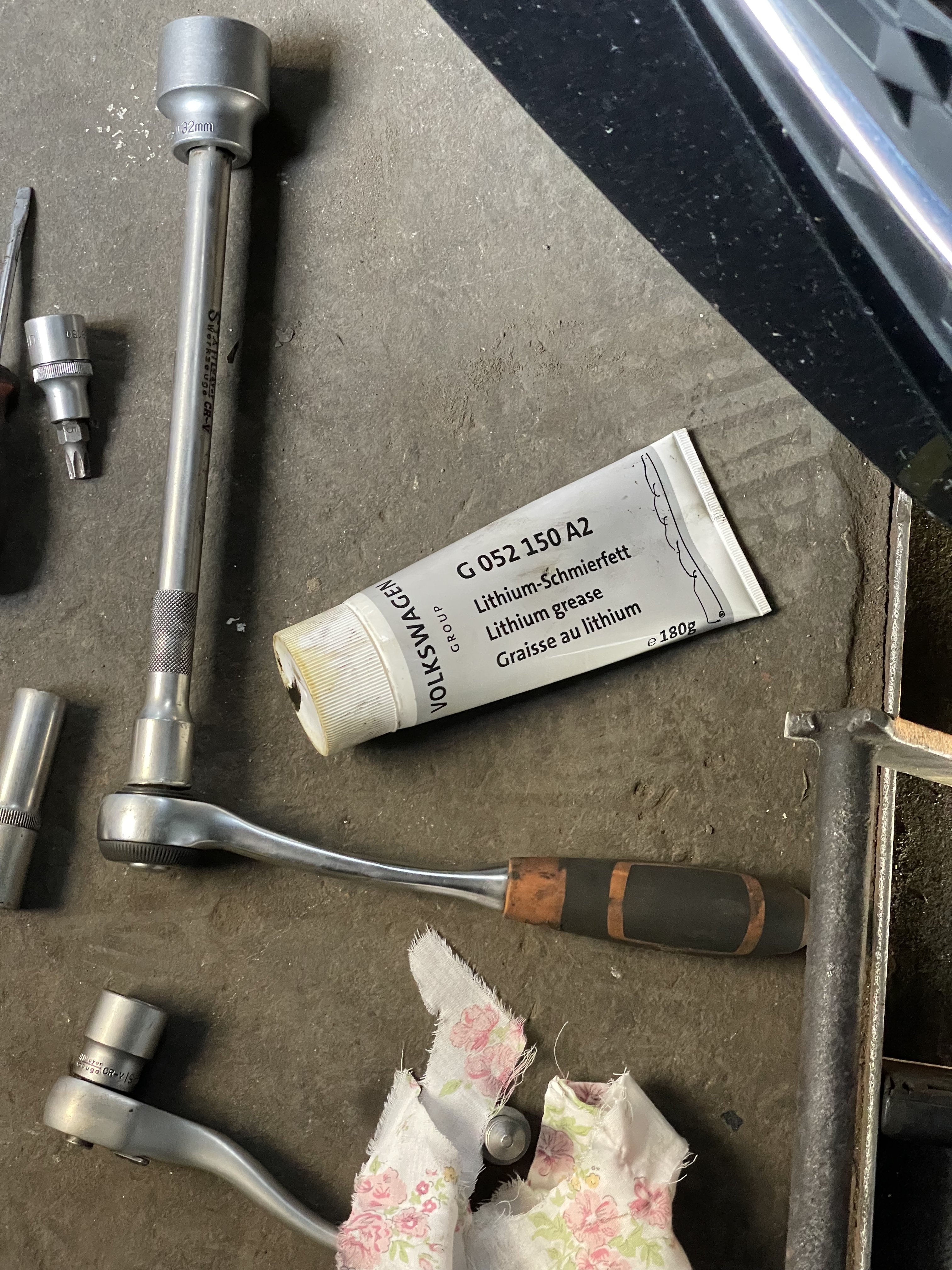

For anyone else experiencing creaking when going over speed bumps:
my Škoda mechanic used this Volkswagen Lithium Grease G 052 150 A2.
The VW lithium grease is about £50 a tube... for anyone wanting to use the exact same stuff but 10x cheaper, multi purpose lithium grease in a tube from eBay/amazon is the exact same stuff
Only issue with this stuff is, it doesnt last forever.
Instead i would recommend Morris K99 marine grease - £10 a tub and will last a lot longer and much more water resistant meaning it will last years without issue
