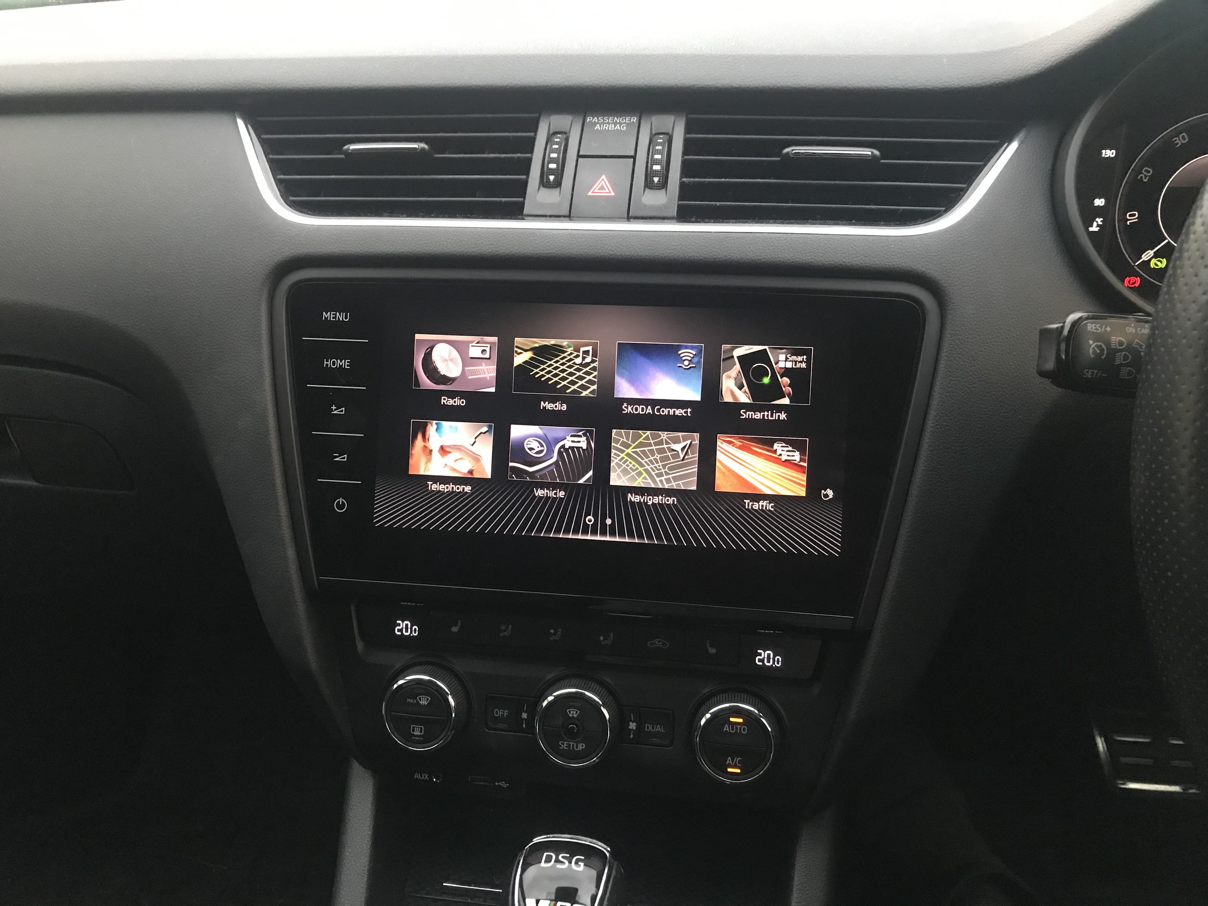

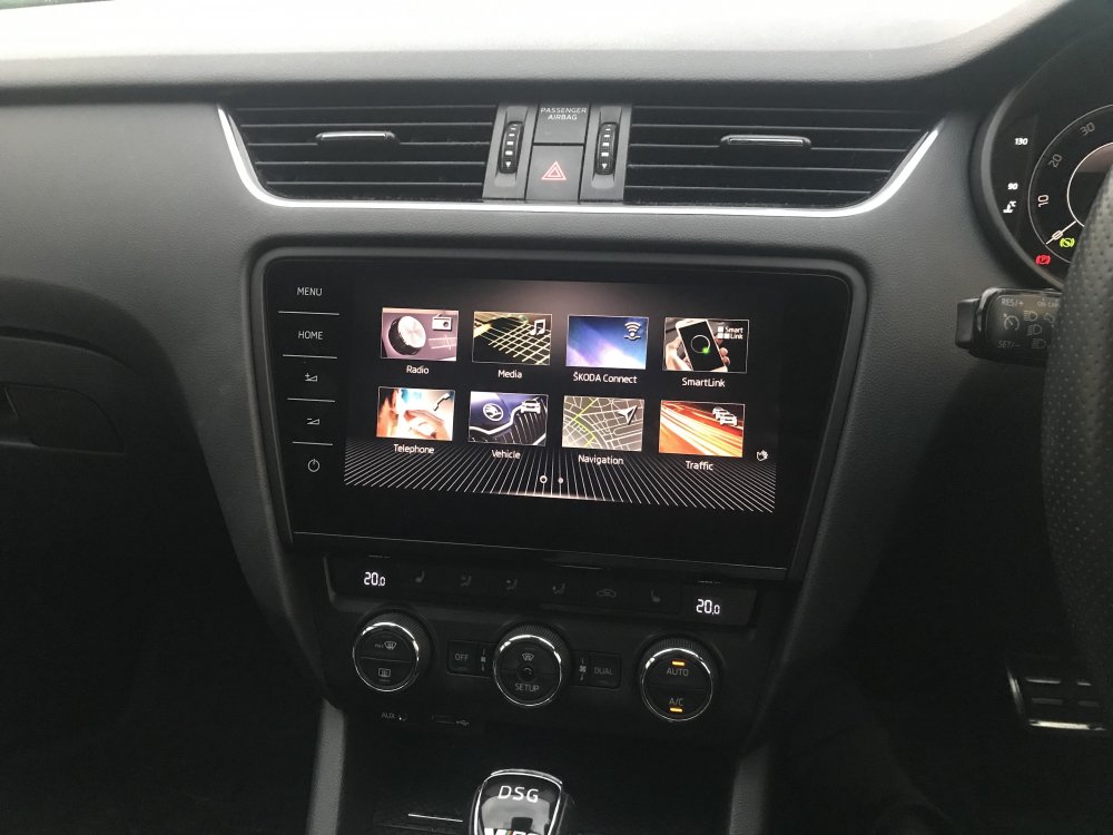

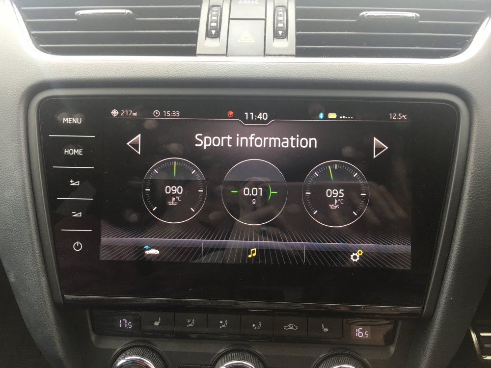

Depends on what you want to spend. I think the 5Q0035874A MIB2 Amundsen is a great unit. It can run an 8 inch screen, it has SmartLink and they are cheap to buy. The maps are SD card based and you can get links from this forum to the update portal to download the maps when they are released. I really liked mine but during the virtual cockpit retrofit I upgraded to a MIB2.5 Columbus with the 9.2 inch screen and it is awesome. Is it worth the £1100 upgrade cost from the Amundsen on a new car? Probably not. Is it worth the £1100 install cost vs £5-700 install cost of the MIB2 Amundsen? I would say if you have the funds to spare then yes. Yes it is!
love the whole look really minimal.
