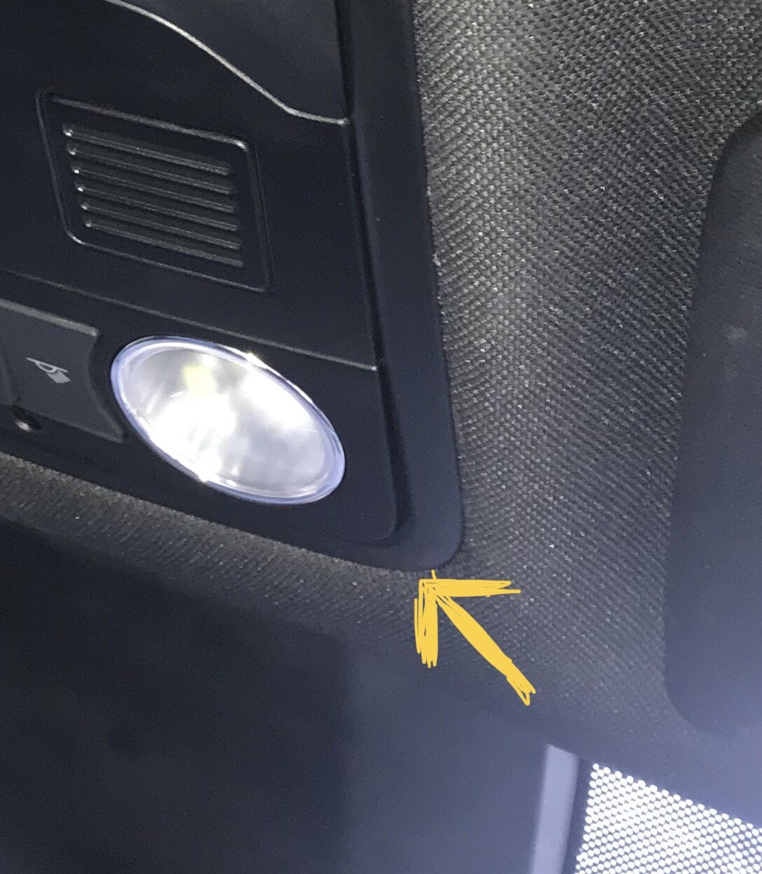

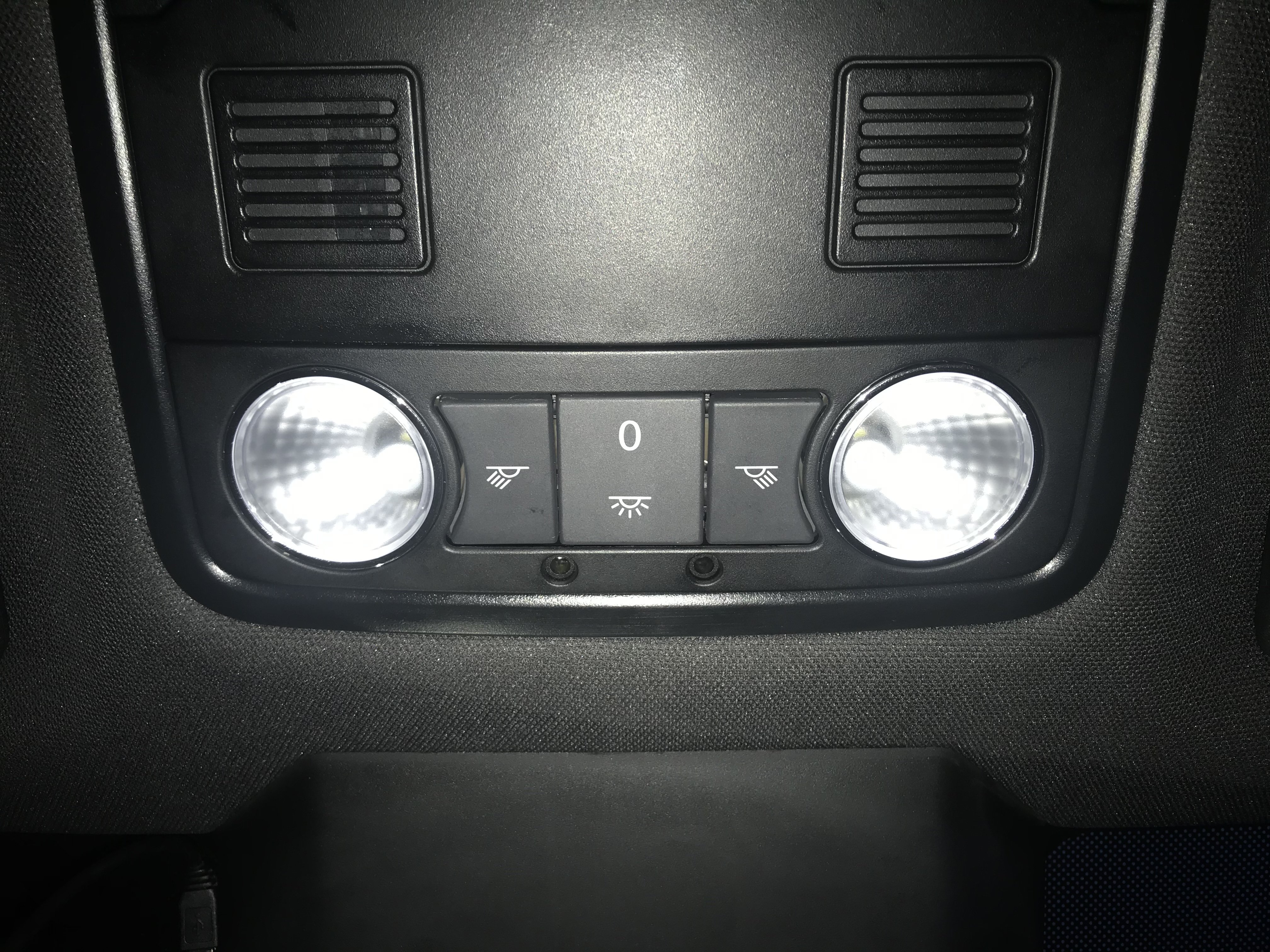

After another two days in the garage to fix noises etc, Skoda are claiming the roof rattle noise I'm experiencing is due to me fitting "non standard" leds to the roof lights and the light cover does not sit correctly. Now I'm prepared to admit that maybe removing the light cover has warped/upset it ever so slightly but I know this is not the cause of the noise*. Nor are the bulbs stopping this panel from sitting flush.
Either way I'm looking to replace this light panel cover but Skoda have said I can't buy the piece individually and the whole roof light console is £141.55 +VAT!
Can anyone help me source a brand new one please?
*the noise is actually coming from the rear view mirror cover touching the windscreen and vibrations are generating a creaking and cracking noise. But Skoda ignored this info and focused solely on the fact i'd fitted non standard bulbs.
They did the same thing with the buzzing noise coming from the passenger door. When they saw I'd fitted cameras so had removed the side dash cover they didn't explore the noise issue because they thought it was my cameras and leads. I removed them all on the second visit and low and behold they put the noise down to the B pillar fitting.

I did wedge some foam in there but Skoda removed it when they were investigating and ignored my suggestion. I'd like to remove the cover and do a proper job but I can't actually work out how to do it without breaking or scratching anything?

It looks like the mistake I made was popping out this light cover rather than releasing the whole surround from the roof. Propably by squeezing the light cover only it's warped it slightly?

Are we talking about just the cover? With the two circles in it for the light to come through?
If you are then the garage are talking nonsense, Ive taken mine off multiple times on both of my last two cars withiut any issue. Surely if the morons are saying thats whats causing the problem then just take it off and the problem noise will go.

Yes that's the cover. You are 100% right that once the light cover is removed the noise still occurs. As I say I've identified the mirror cover as the cause as it has no padding so vibration from the windscreen is going through this plastic to the roof lining. Ive proven this by wedging some foam in the small gap and noise went away.
The technician who dropped my car back at showroom made it clear if they do 8hrs work for example then Skoda head office only pay for 4 so the incentive to work on potential warranty issues is not there, especially noise problems. As soon a they noticed I'd fitted LED bulbs they clearly concluded I'd caused the problem so not a warranty fix and no further investigation required. The light cover doesn't quite push in flush as it's curved slightly so wants to squeeze out on one corner. Push the corner and the other side squeezes out slightly. We're talking a couple off mm.

The very slight curve is the design. No bend or broken clip. It's just doesn't push flush anymore on corner. If I push this flat it lifts slightly the other side?

Hope you can get sorted. Id be happy to remove mine and take a photo of it on a flat surface to compare if it would help.
Mine also sits like that since I replaced the bulbs for led. Just accepted it though. If you manage to source just that bit as a replacement let me know where and how much :)
