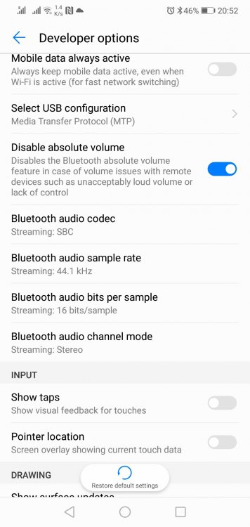

Good find!!  I completely forgot about developer mode. (I used to hack around with Android, installing third party roms and what not, but eventually found the best solution for me was the stock option). Anyway, when enabling developer mode I get 4 BT options:
BT audio codec
BT audio sample rate
BT audio bits per sample
BT audio channel mode
Everything is set to default except the audio codec which is set to SBC.  I'll try setting that to default as well and see if that makes any change.  Other than that, what can do to fix this problem?
Edit: Actually i can only change some of those settings, and they don't "stick" - i.e. they are reset when i go back into the menus.

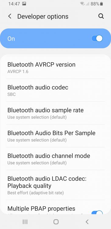

Try changing:
Bluetooth audio LDAC to balanced (606) rather than outright quality.
Bluetooth AVRCP to 1.6
Bluetooth audio codec to aptx or other.
Bluetooth audio channel to stereo.

I find BT audio codex aptx and audio channel, but nothing about AVRCP. Where do I find that?  I am looking under Developer Options.
Hopefully you'll see this in settings.
No, mine looks a bit different:

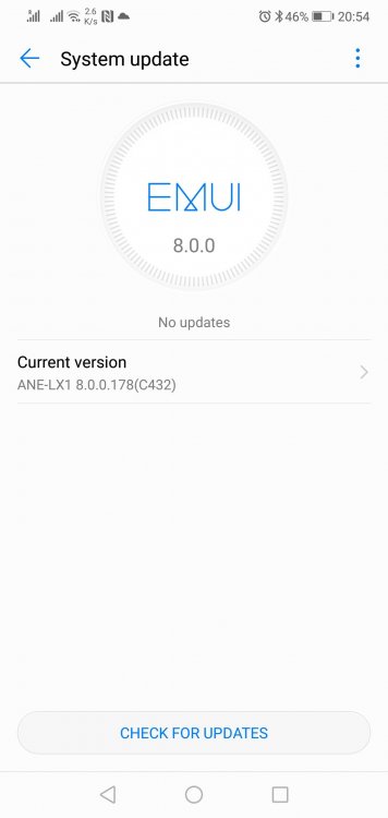

Are you sure yours is a P20 lite?  This is my system settings:
Try an update to Android 9.0, I'm using a Samsung Galaxy S8 on Android 9.0 and when I link it to the car it performs faultlessly, but I have tweaked the Bluetooth settings to balance the connection quality over sound quality.
https://www.technobezz.com/how-to-fix-huawei-p20-pro-bluetooth-issues/
Edited by TheWanderer
I am already on the latest OS available for this phone. I know I could sideload Android 9, but i think I'll just wait for it to happen automatically.  Thanks anyway :)
