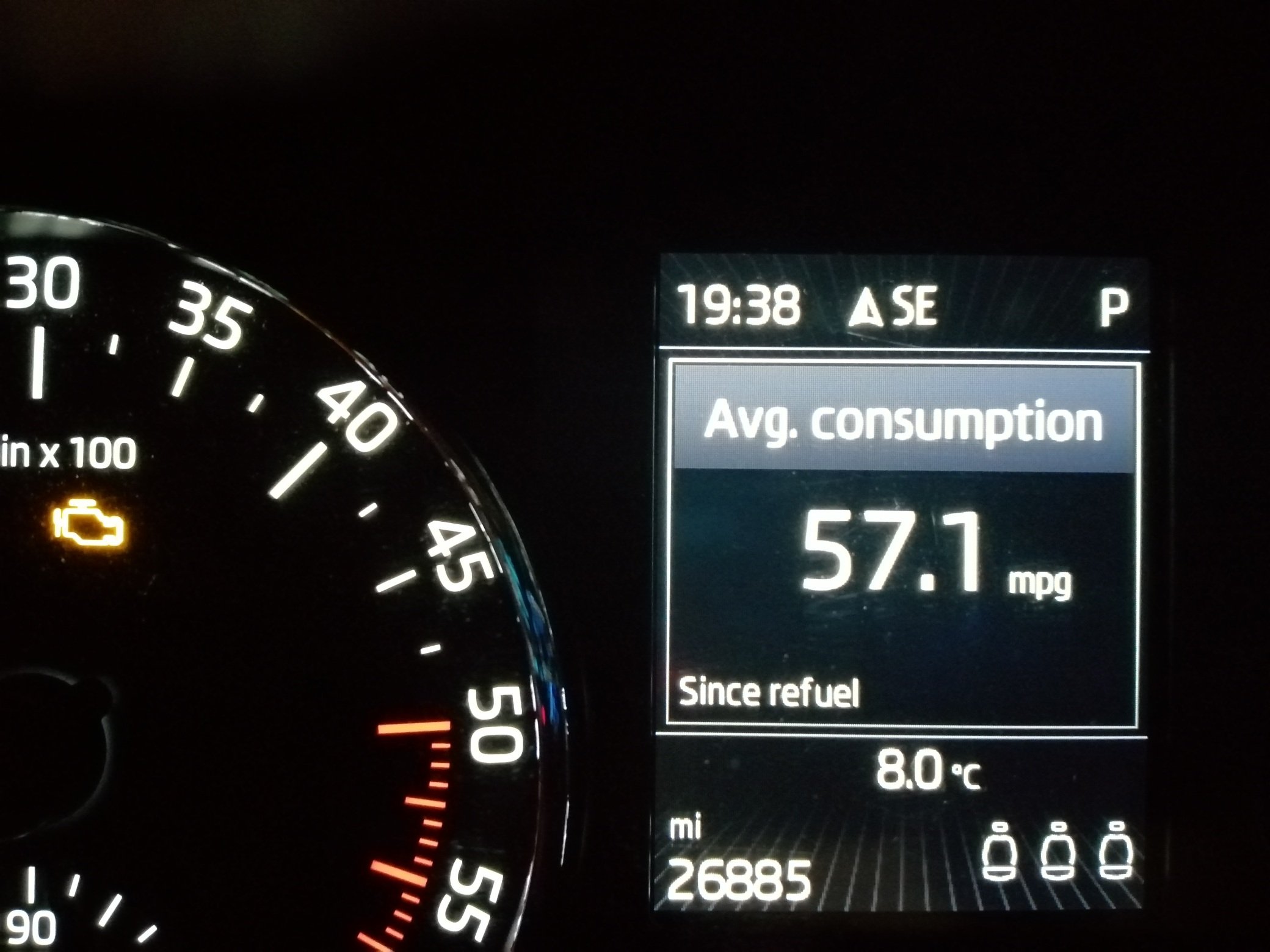

So I've not been particularly happy with my mpg since getting my 1.6 DSG estate. It has typically being doing between 45 and 47 on my commute and on a 550 mile round trip to Plymouth last month, it returned 49.02 - this is done using the brim to brim method and an Excel spreadsheet but largely agrees with the on board computer +/- 0.5mpg.
However, yesterday I did the exact same round trip of 550 miles to Plymouth and back, this time with my roof bars on, loaded with a 10ft paddleboard on the top and I got 57.19 !! That is a massive difference and I had the wind resistance of roof bars and a paddleboard. The onboard computer said 57.1 so again, very close.
Only 3 things have happened since my last round trip:
1. I ran some diesel fuel system cleaner through it
2. I changed the air filter
3. I removed my summer 17" alloys and replaced them with Goodyear Ultragrip 16 inch steel wheels.
I can't actually beleieve that any of those would account for so much difference, but I could beleive the each one my add up a little. Any thoughts? The car has now done nearly 27k. The air filter might have been the original, but it didn't look particularly dirty. The summer tyres I took off are Continentals, so a half decent brand. Tyre pressures are correct on both sets.
I'm a bit stumped really :)
Nick
Your figures seem a little low to me, even this latest figure of 57.1mpg. My regular commute is 90 miles daily, mainly motorway, and I've got used to putting in 20 litres at a time (to help keep track of MPG and also to be able to pay contactless, once you've added a couple of tasty snacks comes to just under £30). This usually gets me 270 miles or 3 days commute, and works out at about 60 mpg. I do stick to the speed limits but like to get to cruising speed as quickly as possible :dry:.
The only "mods" I've done are Pipercross Air filter and Pedal box - gets me to 60 quicker. How's your DPF - have you checked with VAG DPF and an ODBII  dongle?
