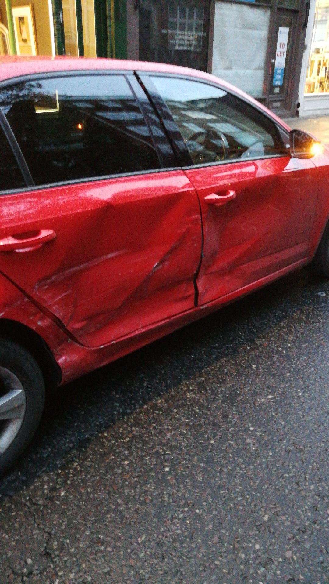

GUYS...THANKS ALL OF YOU FOR YOUR VALUABLE ADVICE...BUT I THINK I HAVE TO CLOSE THIS THREAD AS SOME A***O*L* HIT MY CAR AND SMASHED DRIVER'S DOOR AND ALSO REAR RIGHT PASSANGER DOORIT THIS EVENING. SO I MAY NEED TO LOOK FOR TO BUY ANOTHER CAR. IRONY IS MY INSURANCE IS RUNNING OUT TOMORROW AT 13:42 AND I ALREADY BOUGHT A NEW COVER LAST WEEK WHICH WILL BE STARTING TOMORROW 13:43..
SO, ITS OFF TOPIC BUT IF ANYONE CAN ADVISE ME REGARDS OF INSURANCE WOULD BE HIGHLY APPRECIATED, LIKE WHETHER I SHOULD CANCEL THE NEW COVER OR I SHOULD JUST NOTIFY THEM ABOUT THE ACCIDENT. THE FAULT OF THE ACCIDENT IS OTHER DRIVER. I WAS CROSSING THE JUNCTION AND HE WAS TURNING RIGHT..HE DIDNT STOP OR COULDNT CONTROL HIS MB E220 AND THEREFORE COLLISON. HIS AIRBAG WENT OFF AND CAR WAS UNDRIVEABLE BUT MINE IS DRIVEABLE AND I RETURNED HOME SAFELY BY DRIVING MY CAR.
The only advice I could give you would be to contact the insurance who you were under when said incident happened. It was their policy you were under.
Hope all is resolved quickly and effectively mate.
I am no expert, so take this as thoughts, not advice.
if you change insurers at 12:00 and have an accident at 11.45, the old company not the new is the one you raise it with.
i wold assume, but it’s an assumption, that would apply to you. I would make sure you report it to your insurer before the old policy expires and take their advice.
Looks repairable from just the pictures tbh, so you might need the new policy anyway.
