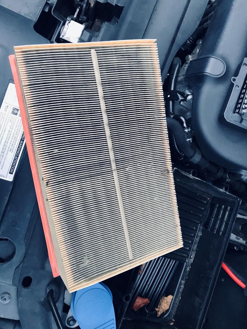

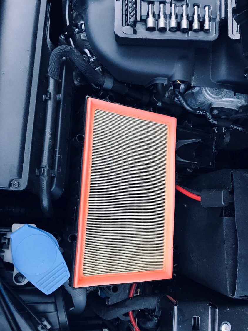

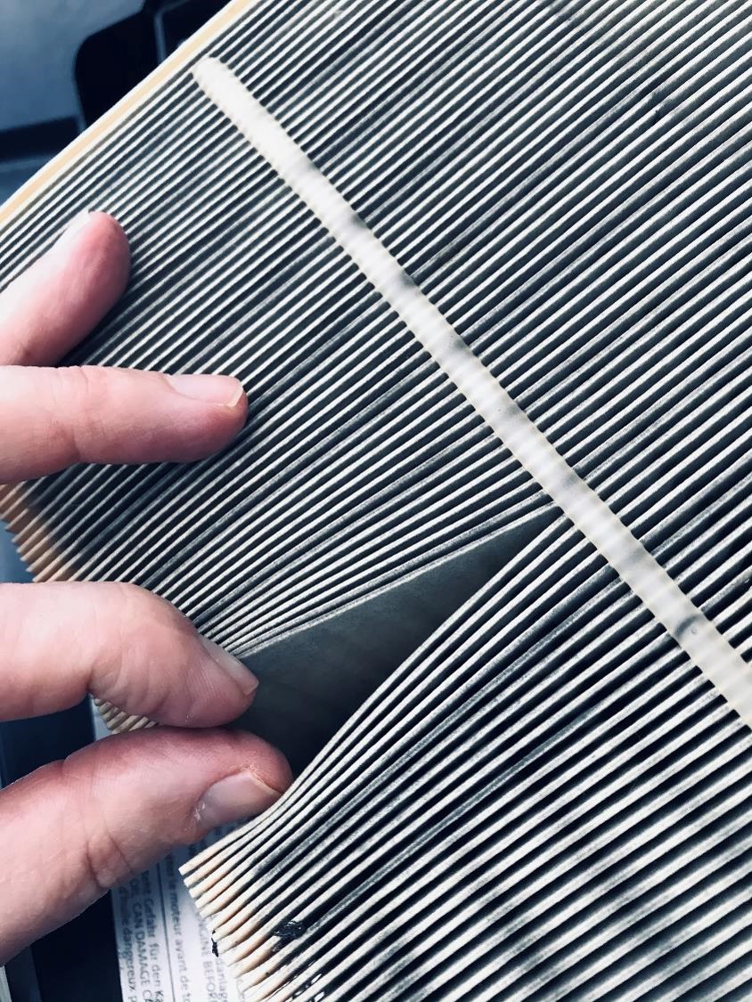

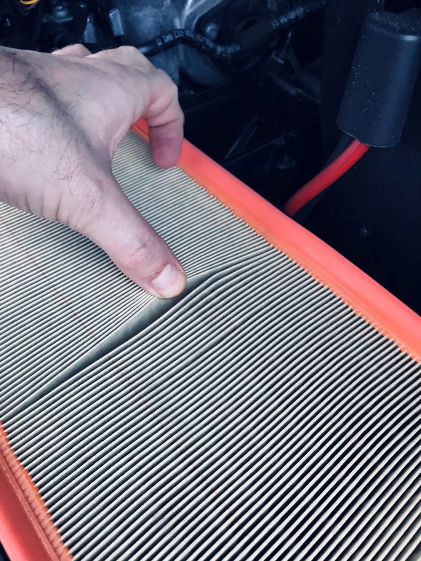

Back to the car, today I have checked airfilter, pictures attached. I am not an expert, does this need replacment?

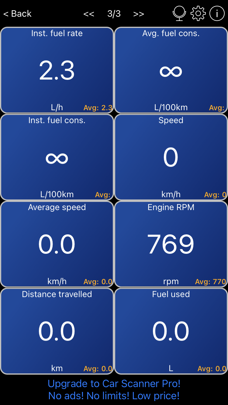

1. Fuel consumprtion durring idle, it was 2.3 liter per hour. No A/C or mirros heating, just engine. I was expecting values about or below 1 lietr per hour, see attached pictures.

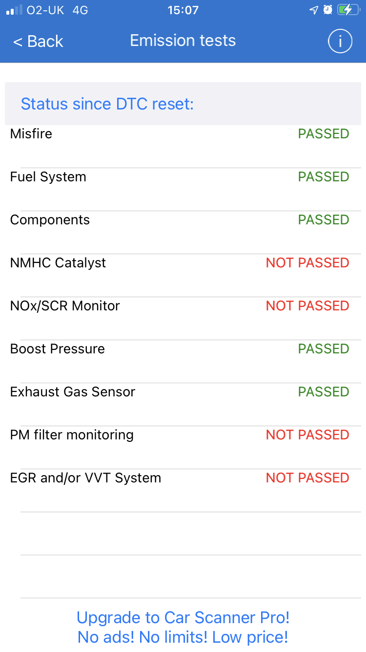

2. Emission test, there are few points which has failed. Is it something which I should worry? Just to add on Monday I have scheduled MOT, wonder now if I will pass it. See attached pictures.
During car scanner there were a lot of sensors and readings. For most of them I have no idea what they are showing. Can someone advise on what I should focus on?

I would change the air filter as I would say it’s due. That will be different to the official Skoda line no doubt.
I use Skoda or Mann Filter.
Whilst that will give a slight improvement in mpg and generally allow the engine to work more cleanly, I doubt it is all if it.

An indicated consumption figure of 2.3L/hour at idle with no ancilliaries running is very high.
I have not owned a diesel with a dpf filter but my old 1.9pd diesel in the mk2 used to show 0.5L/hour at its natural 900rpm idle when warm.
Even my current 1.4tsi display shows 0.5L/hr at idle in similar circumstances.
Sounds like the car is locked into a permanent and continuous regeneration?
Only with the aircon on at full blast during a 47 degree day have I seen idle consumption near 2L/hour.

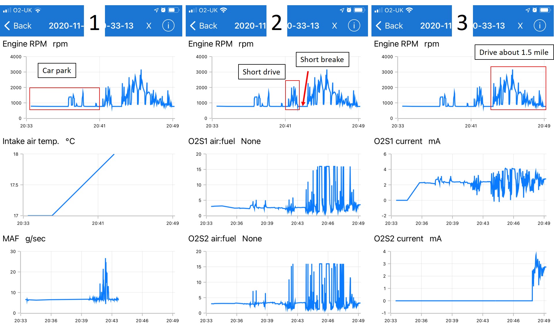

I have done small sesion to capture few parameters to see how they are behave during stop and drive, I have combined three pictures of different parametes with reflect to rpm.
Part 1 is showing air temp and MAF, from some strange reason readings has stoped recording. It might be that I have clicked someting during short breake.
Part 2, air/fuel ratio normally should be about 14.7. What I can see it is about 4 and sohastically going up when rpm increasing. Does it should be conversely? I am not sure this variability, it does not look good for me.
Part 3, readings of O2 sensor (lambda sensors). What I have read is that the mA should be around 0 mA otherwise fuel mixture is rich or lean. What I do not like again is this vairability. O2S1 looks like have higher values constantly where O2S2 has proper values on the begining, but the end is rubish.
Basically when I was googling I have found information that so high increase consumption of the fuel is matching with lambda sensor failure (up to 50% higher consumption and less power during acceleration). There is just one problem, there is no DTC error. Any ideas what it might be? Sympthoms are muching to lambda sensoer failure, but there is no error.
I have been today to do MOT and surprisedly I have passed MOT.  After my findings I was pretty much sure that I will fail MOT, but I did not. In the service they have explained to me that for diesel they are not doing the same emmision test like for petrol engine.  Anyway they have ignored me when I started talking about my readings. For them there is no error so there is no problem.
I will be much appriciated if somone can have a look on my readings and advice what I should do next. I would prefer to take some more measuremnts from the car to better understand what is happening rather that replacing bit by bit.

You could disconnect the MAF sensor and get comparative readings.
The car has a default program which will not have the car running well but will help to diagnose things.
If you disconnect the MAF wire and fuel economy improves, you then know that is a good place to start.
I take it you have checked the intake is free from obstructions (leaves etc) and also checked the exhaust for leaks/holes?
You are getting to the limits of my knowledge here, so the above are based on things I have seen/had on other cars in the past now.
