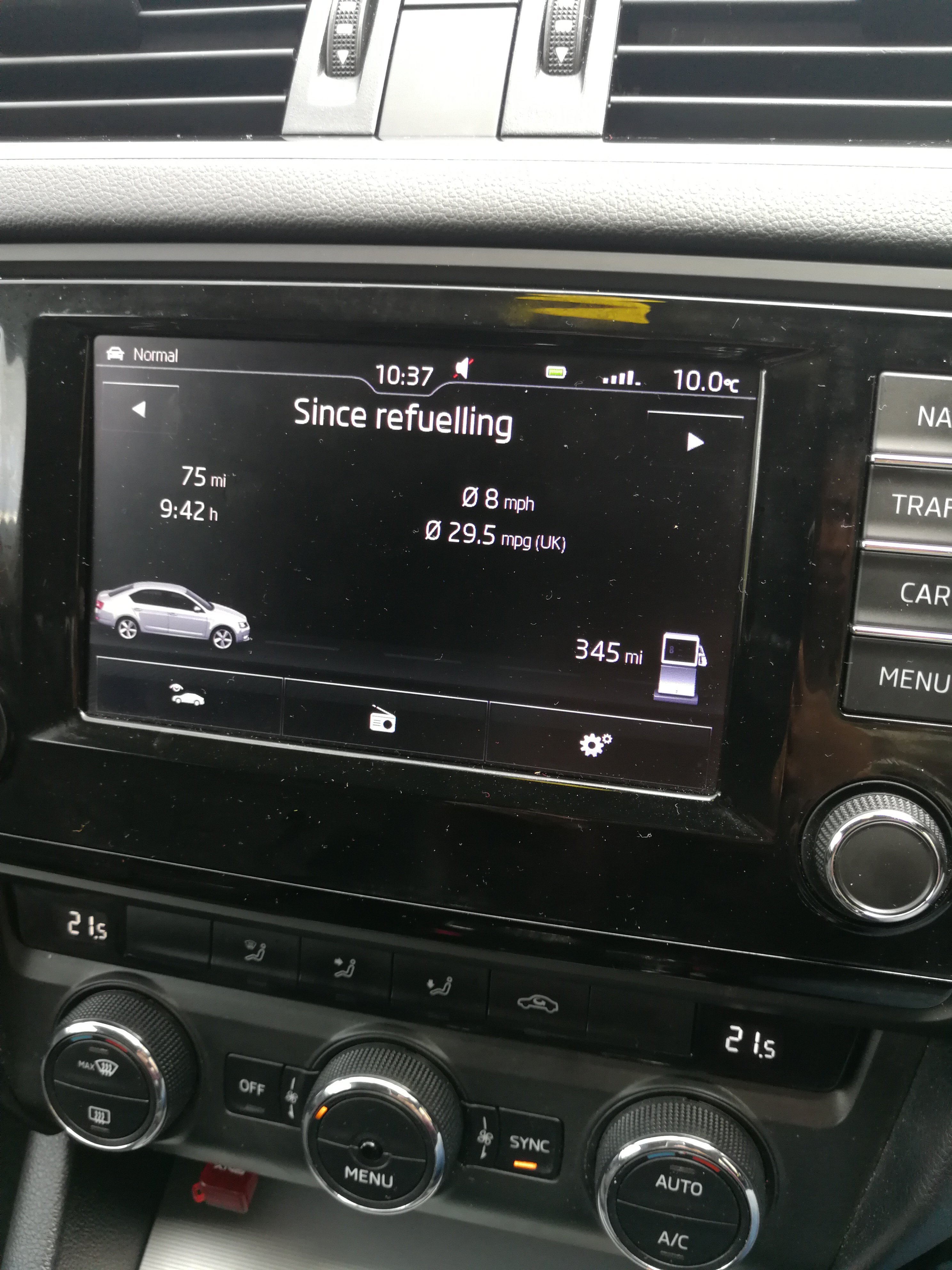

I don't know how to make you guys understand. but honestly speaking I had the similar car (63plate)..so I can easily compare my car's fuel consumption and again I drove this car 4/5days before changing the fuel filter and I haven't had any concern.  Without any heater or A/C on the consumption is 38-42mpg in mixed city drive for the whole 40liters fuel where as I used to get 48-52mpg with the other car. Well, don't know what's wrong. I will get the brake fluid change within few days. I may ask them to check the brake bindings.
I think the most obvious causes have been suggested. You need to start making proper fuel consumption measurements and getting parts tested/checked...
The engines have probably changed from Euro5 to Euro6 between the '63 and '16 plate cars so making a direct comparison isn't valid.
This!!!!  Please don't use the on board reading as a fair comparison.  It can be wildly out especially after performing maintenance on the fuel system.
As you only drove the car for 4/5 days before changing the filter you cant really use that time as valid data either.
As you are starting to get (possibly) unfair comments, I would suggest taking the advice on here and using an app or calculator to work out the proper average over at least 3 tanks.  This will give you a good baseline.  My old mk2 1.9tdi used to over read by about 10% where my mk3 2.0tdi burns more fuel and the reading is more accurate causing the on board reading to be massively lower (46 compared to 60).
