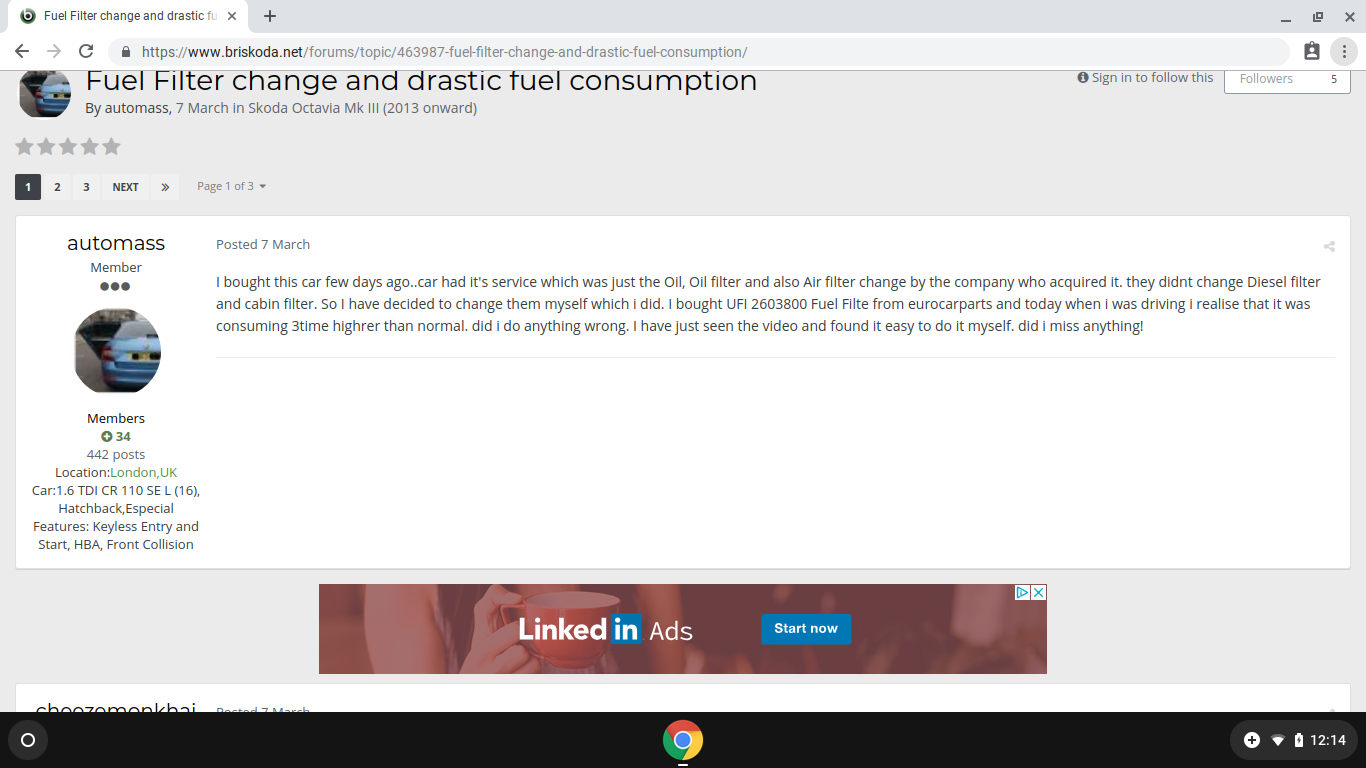

Fuel Filter change and drastic fuel consumption
its not. i was getting way more than that before i touched the fuel filter. 49mpg where half of it was motorways free flow roads.

Guys, many times tank has been refilled and many hundread miles have been driven so far. I can manage to get  42mpg (average) in city+motorway drive and 52mpg in long stretch road.  I am not telling about the infoteinment reading..it is my proper calculation and to be honest with you my infoteinment system also shows me the same.
As i was keep telling, since the fuel filter was changed this issue (unusual fuel consumption) arised. car had been diagnosed in skoda,no fault found. they visually checked and said there was nothing fault with the car..
i dont know what else is left to sort this consumption problem. any idea!!!
