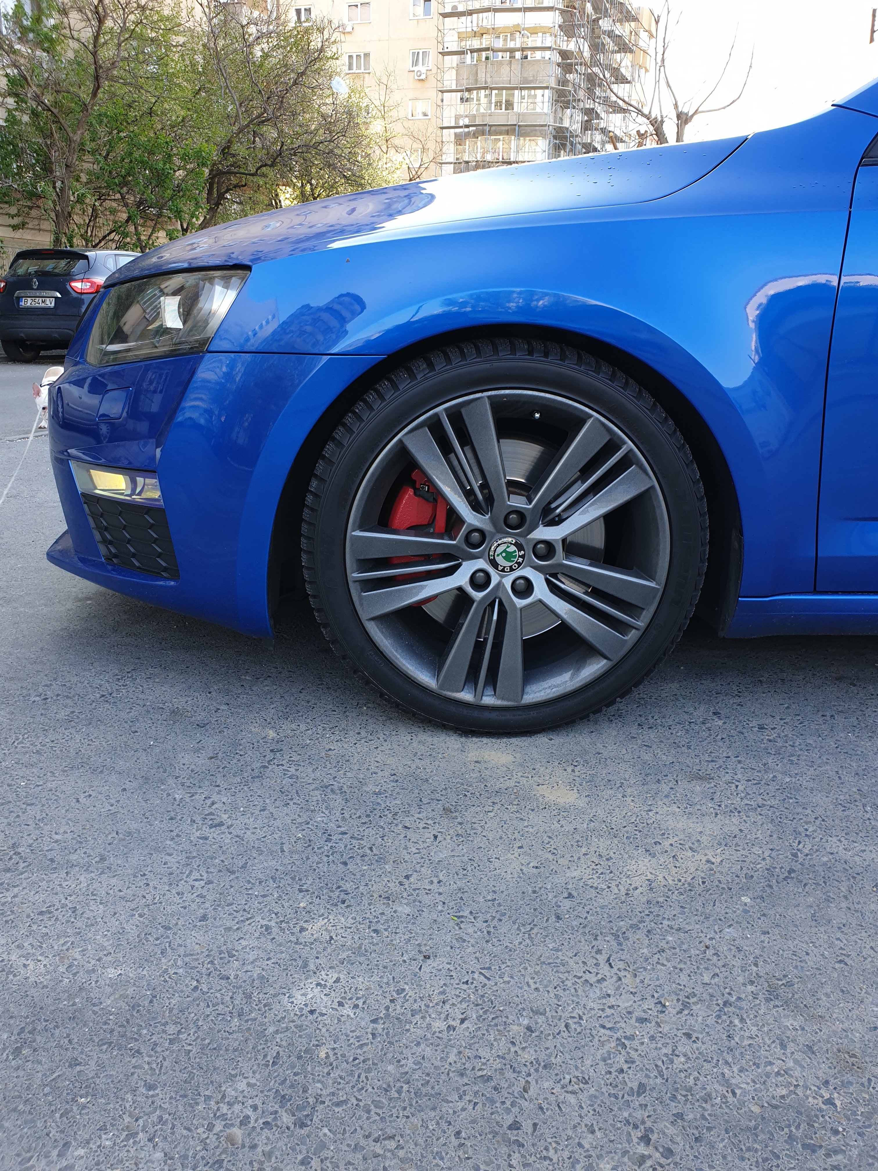

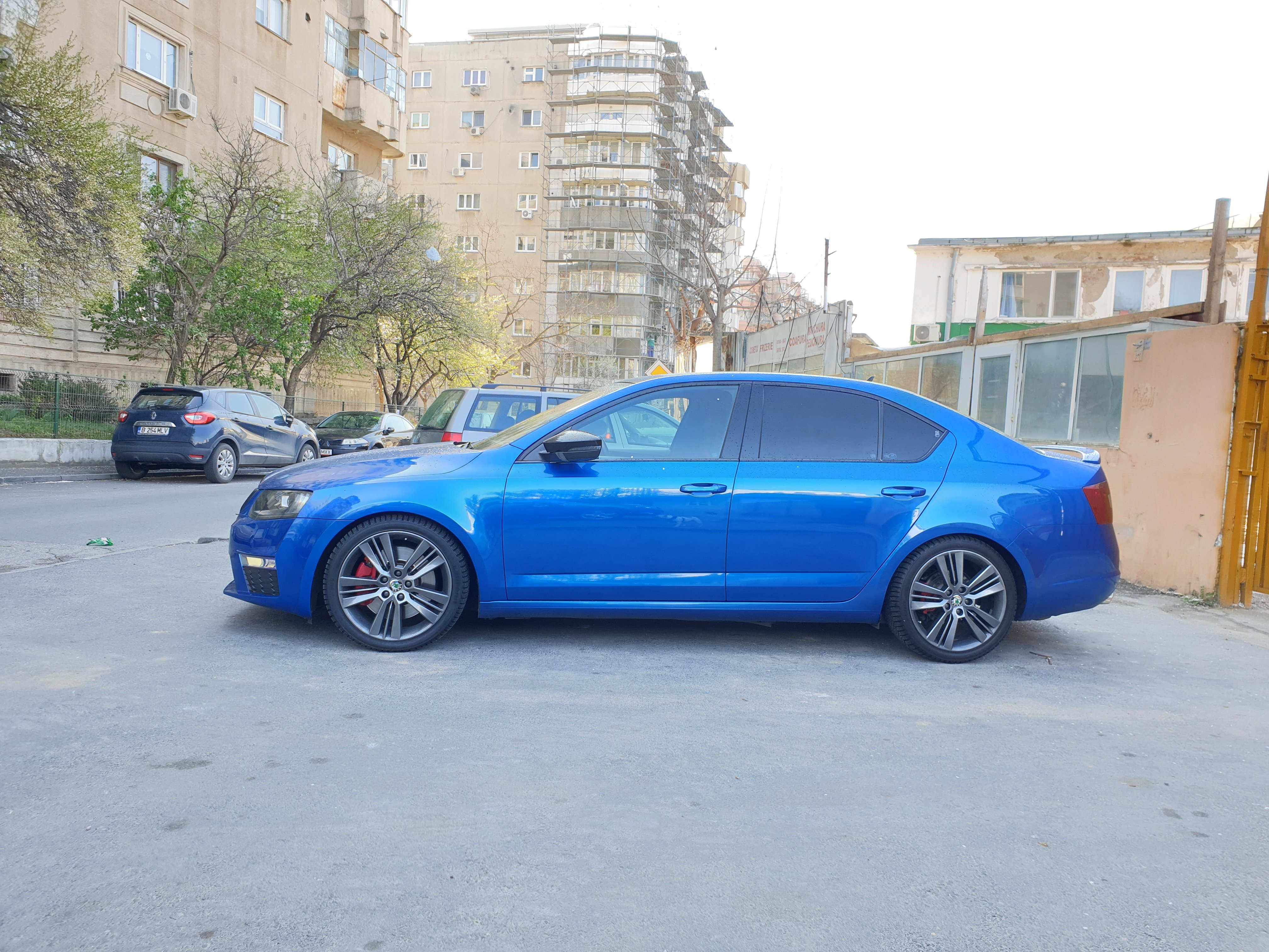

My height is now 65 cm from ground to fender on front and 64 cm on back. I will put a photo as soon as i make one :)

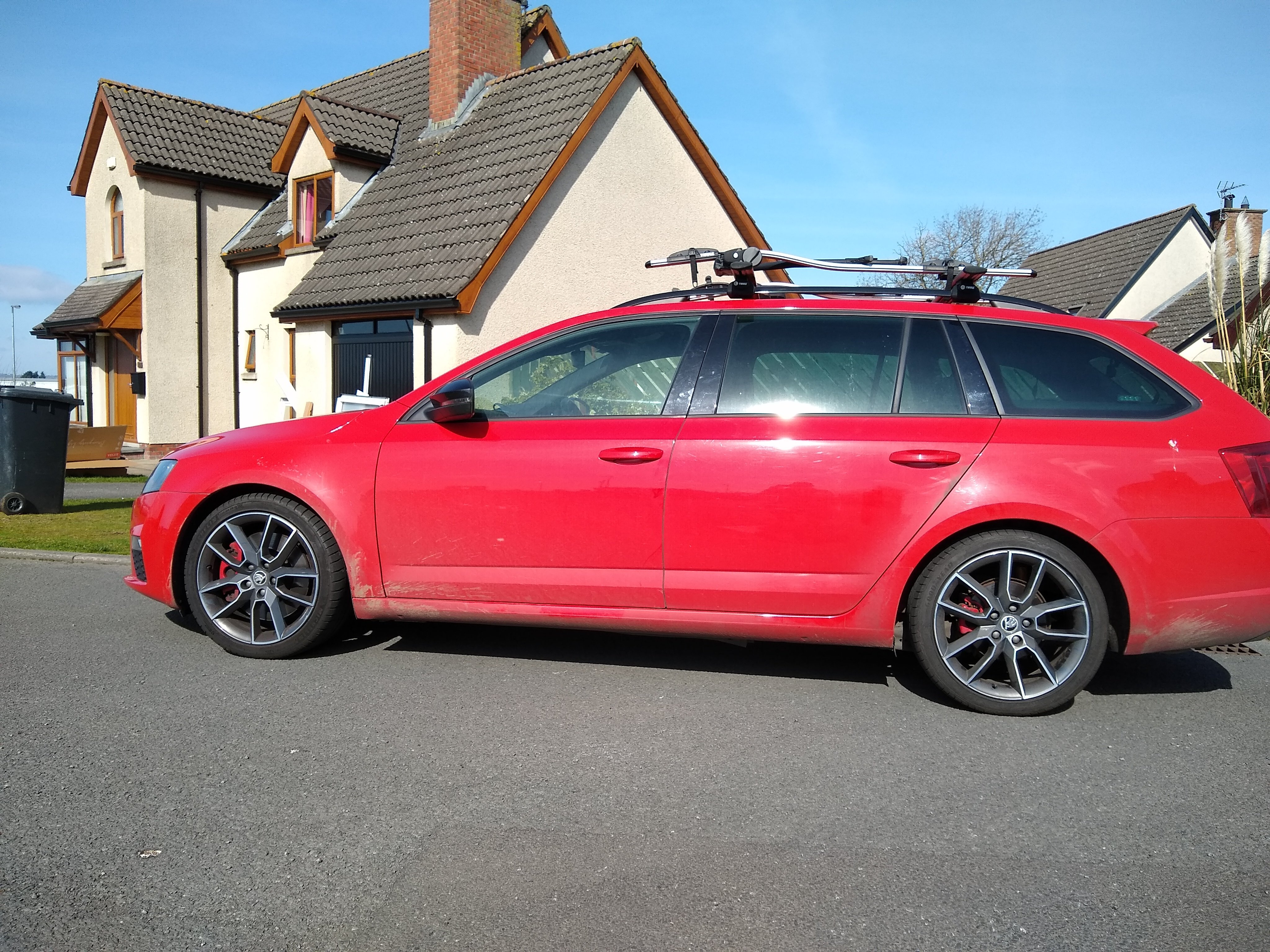

Your b12 kit is with eibach pro kit springs(black) or sportline springs(red)? A picture would be nice to see the height. Thanks
they are the black (pro springs)
