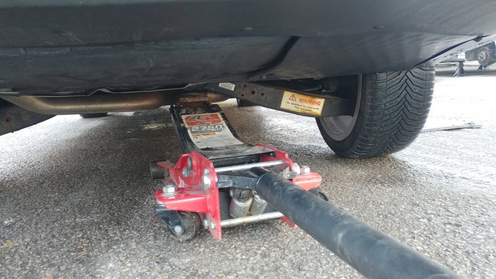

You should never jack in the middle of the control arms, they're not engineered for that type of load. The factory recommendation is to jack at the points where the subframe is bolted onto the chassis.
Failing that I've found putting a block of wood on the jack pad and jacking at the sills works as long as you're careful and pay attention to the jack as the car is going up.
Stole this from other post to highlight no jacking
They even put a sticker on it

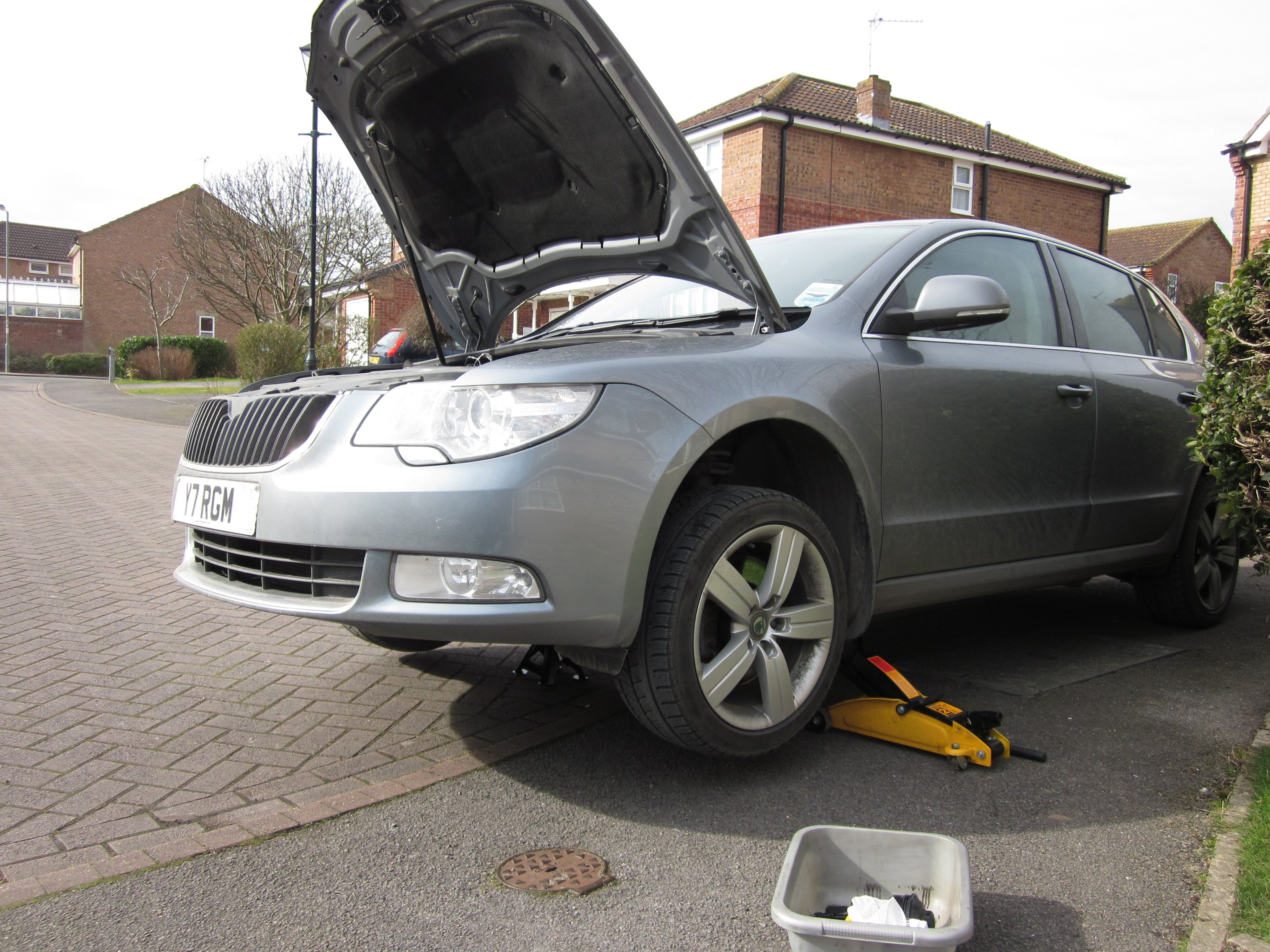

The jacking points are marked on the sill with an indented triangle. A trolley jack and puck work a treat...

It's a bit of both to be honest.
If you look at the shape of the standard scissor jack provided with Superb's with the spare wheel kit, you'll see that the top of the jack is stepped. It's higher on the inside than it is on the outside.
My picture is a little misleading, in that the puck isn't compressed, there's no weight on it when I took the picture. Once it compresses it moulds around the front, middle and rear of the sill, doing a fair job of spreading the load and protecting the sill.
I normally jack it up using the sill, and then lower it onto axle stands under the front suspension.
It's 8 years old now and I jack it up roughly four times a year, twice for the winter wheel swap, and twice for servicing. No damage to the sills, although I have split a few hockey pucks over the years.

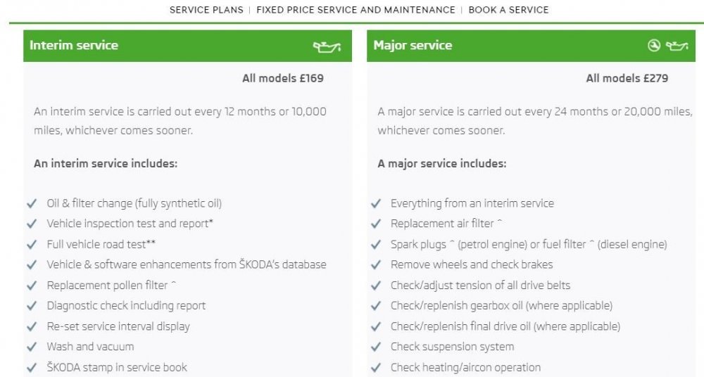

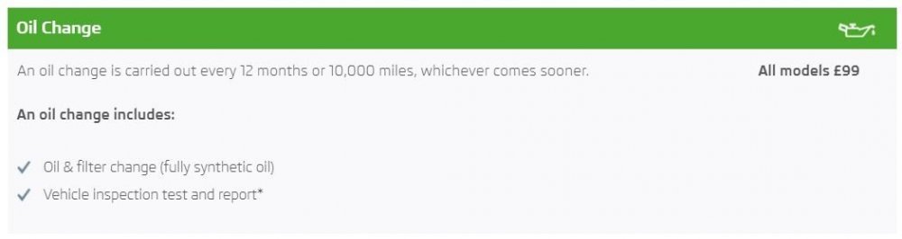

Independants aren't always cheaper than main dealers, especially on older models such as the MkII Superb.
Vehicles 3 years or older get discounted rates...
11 hours ago, newskodadriver said:
You mean you change the tyres over and service the car yourself??
See here...
