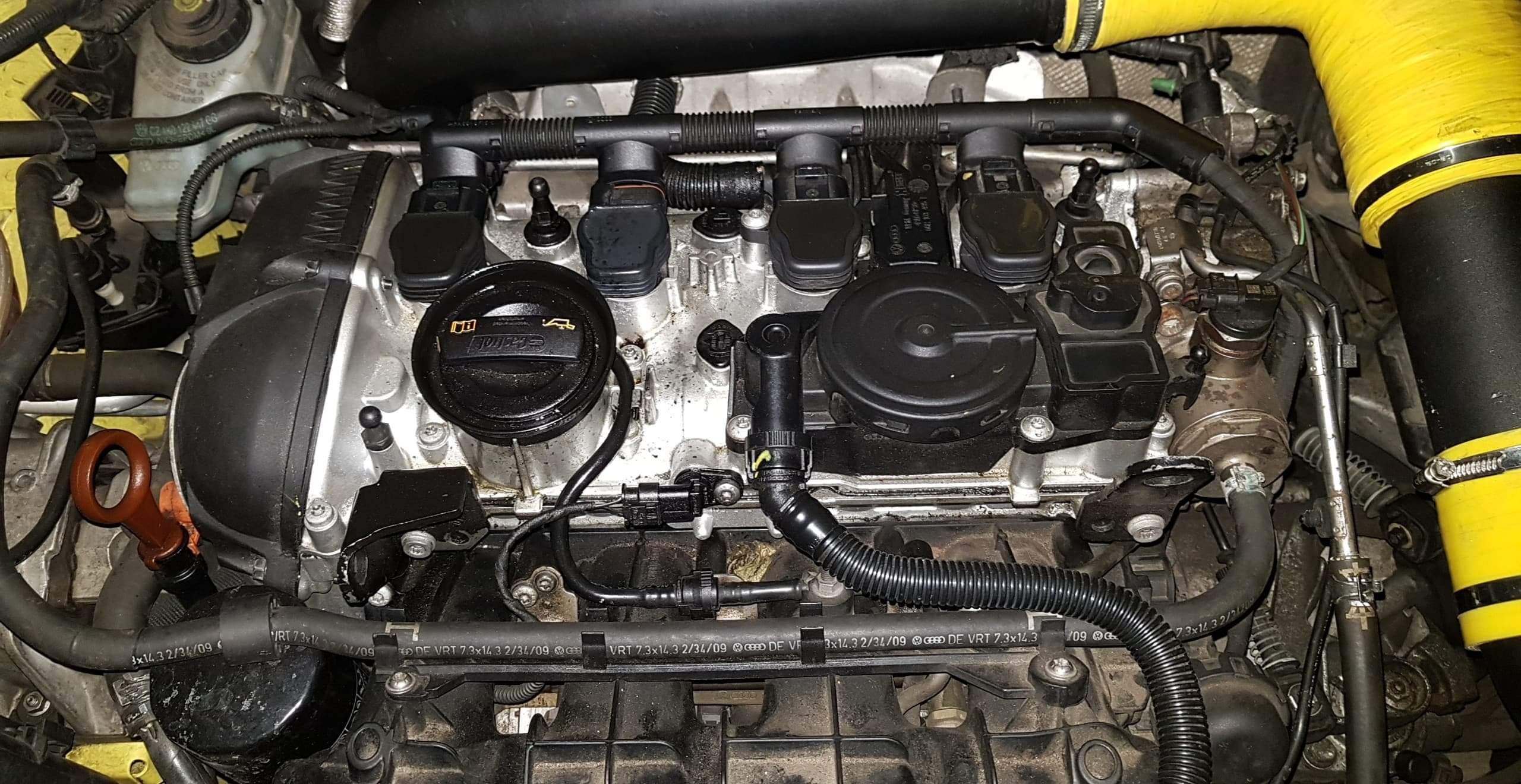

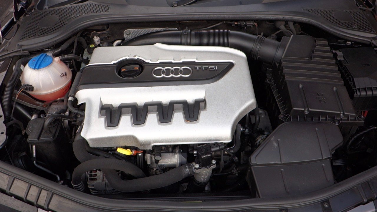

its a Tsi :thumbup: this is Tfsimaxresdefault.thumb.jpg.47cdf593fbd1b1fd9c8a15c26bd5c54d.jpg
Edited by vonbeck
That is correct - the difference between TSI and TFSI is the engine covers :)
