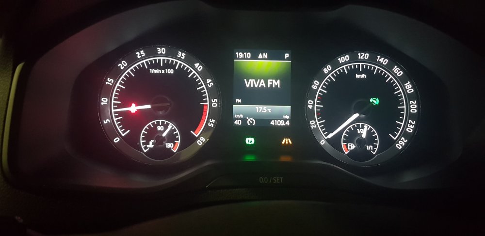

Coolant temperature increased to 102°C
After driving 30 minutes in town, for 9 km, mostly by waiting in traffic, and arrived at home, I noticed that the temperature of the coolant was at 102°C. Then, the cooler started and, in one minute, the temperature dropped to 90°C.
Oil temperature: 108°C
Outside temperature: 17°C
14000km
2.0TDI.
Do you think that is normal?
Note: With some minutes before arriving, the Start-Stop didn't stop the engine, because it was not possible to maintain an operating temperature. It was the first time I saw that reason. The temperature was then at 90°C. Strange.

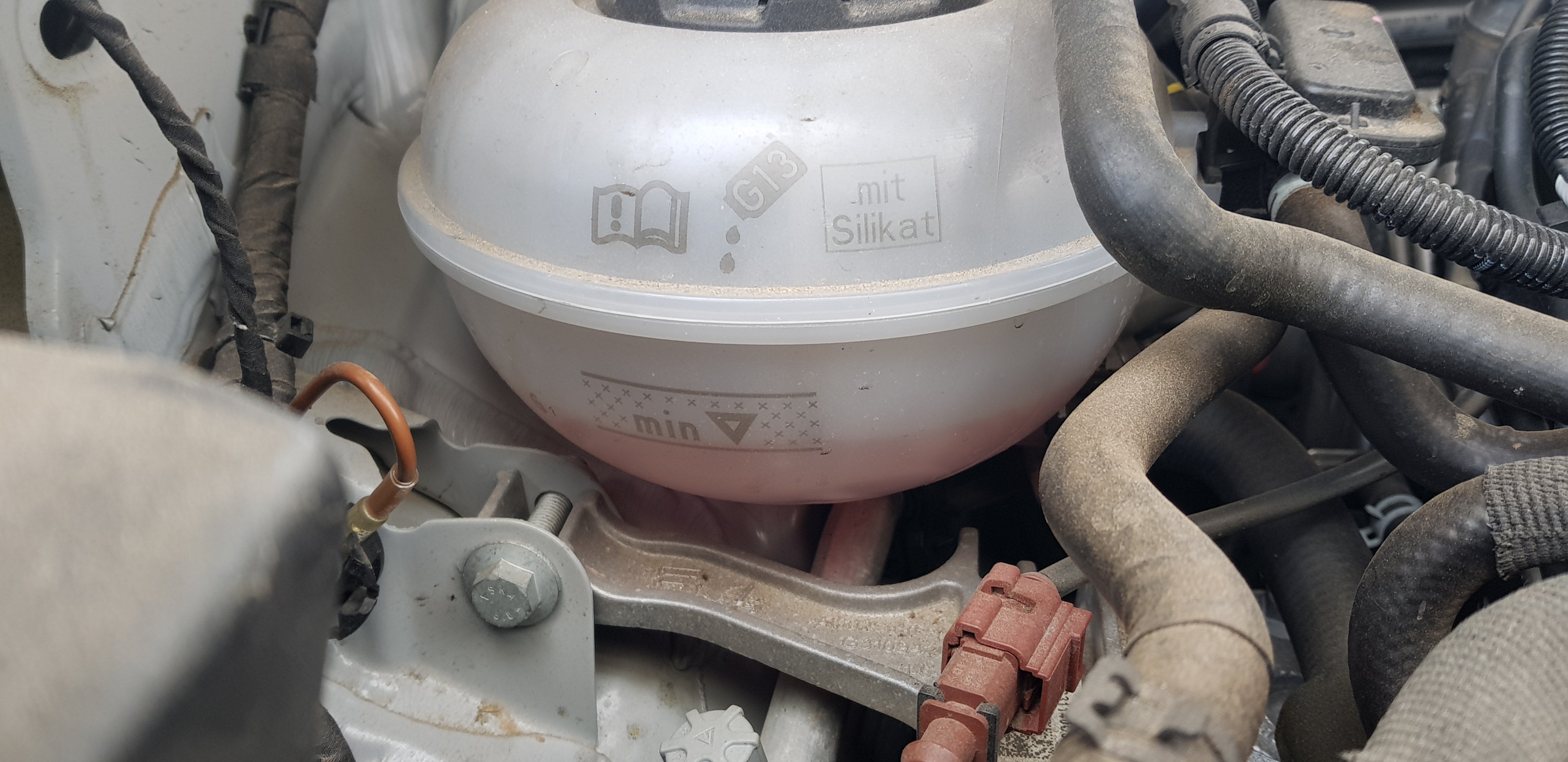

@Gabi4  Have you checked & Is the coolant level sitting between Min & Max when cold?
I will check tomorrow morning the coolant level and also the oil level.
I don't think that the DPF was regenerating, because I did 1500 Km during this weekend and because the engine was at 700 rpm in idle..
My Yeti's water temp never rose during DPF regen. Karoq, fortunately doesn't have a DPF. I would keep a careful eye on it if fluid levels are ok.
The level was right at the minimum...
MIN is OK if it sets that level.
Obviously not if it goes below.
Do you know where it was at when you got the car and have you looked at it since?
If you put in G13+ and top up to below the Max, it should stay there.
But be sure that a Main Dealership is told what happened ASAP and it is on the System.  That way nobody can say, never heard of that before.

Your previous thread now getting new posts had you with low coolant back in November.
Best find out what the issue is with your car and why coolant is being lost, and about the coolant temp.
I scheduled a visit to the service, next week. It happend again while going up on a long hill, but not steep.
Verdict from the service: the water pump is broken.
