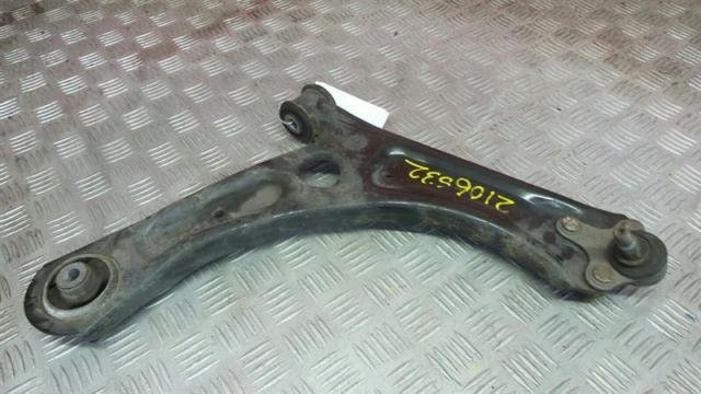

I ordered the Powerflex ones for my car but they are not console bushes that are fitted for the 2012 model
It a standard wishbone bush and on contacting Powerfelx they say not available for 2009-2013 model
Told me to measure the bush and get back to them with dimensions
May do that next week......or maybe not
Well there is the difference, the bush at the 8 o’clock position (bottom left corner) is what’s different on the S2 compared to the Octy2 and Fabia1. I read a lot about consoles over the years on various VAG cars. As I said upgraded both the my other to Cupra ones. I would rather not go poly on a diesel. Maybe this is no longer a weak point given this setup?
Just checked the powerflex website and they do console bushes for 2009-2011
Mines was a 2012 with the above arm
