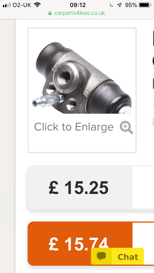

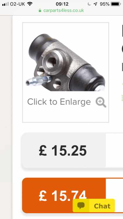

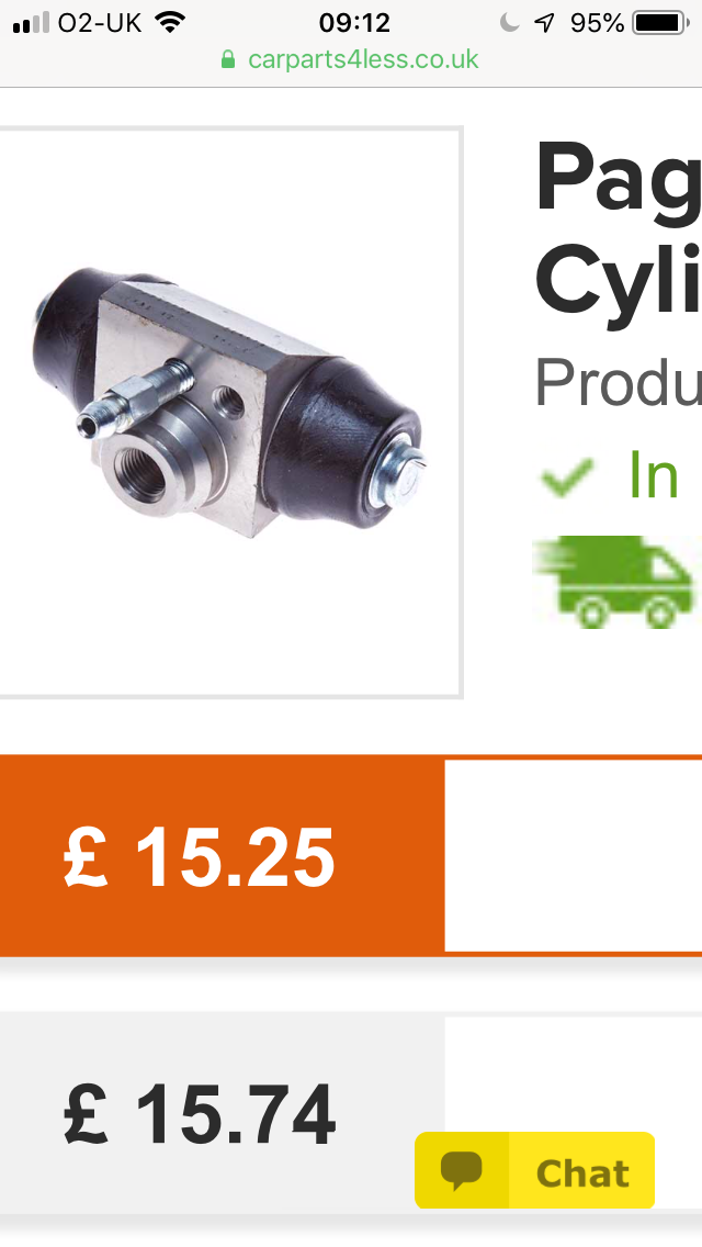

 Someone may be able to give more clarity, but Carparts4less offer 2 options, Pagid or Bosch, and if photos are correct Pagid has 1 fastener, Bosch has 2. When buying for my old 56 1.4 TDI I needed the ones with single screw so suggest you look at your backplate.
I’ve looked at both, and they look to have one screw on7F71989C-F463-4DE1-810A-ED3DB793F966.thumb.png.19b29a8c8b2f7ed770dcf77f01b33567.png
Image over end of text line, but the 2nd one has 2 screws - one either side of bleed nipple - to hold it to the backplate, the 1st has only one.
Cylinder with two holes will fit both sides, cylinder with one hole will be handed.
Probably.
I don't think they are handed because the part number is the same for both sides. I know mine had only one screw when I replaced them.
Yeah, the bolt hole is in the same place on both sides. As Sep says though, the cylinder with two holes will probably still fit.
