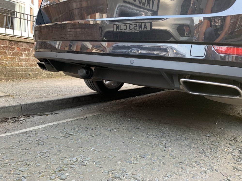

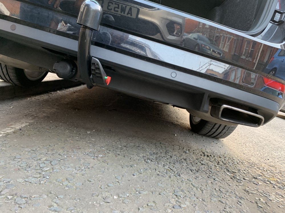

Some photos

That does not look like the OEM towbar.
I agree, aren't the electrics supposed to 'swing' up under the valance?
I had a Westfalia detachable that the electric point pivots up under the valance with a full electrics kit (so the car can't be put into Eco mode and the rear sensors switch off if something is connected etc) done back in 2016 by All Tow Bars, I live in Thatcham, and the guy said they do the retrofitting for Skoda Reading.
The standard OEM towbar on a Superb III is a fold out one. So you have a nice towbar, but it’s not the same type as a factory fit one.
That's the same as we get as OEM in Australia, being the Prof Svar detachable type. The electrics should swing up out of the way.
Video i did off above the post - this is the OEM towbar
On the OEM one, the electric socket is in the hitch swan neck and swings up with it.
Edit: Rick TT beat me to it!

Ah.  I have a removable swan neck.  You unlock and depress the pedal and it drops out.  It locks back in automatically.
the electrics look to be solidly mounted, however I will check.
The car car still runs in eco mode, but being a 280, that’s not why I bought it :-)
i may add, the towbar fitted above does look a smart one
Looks like a neat job.
